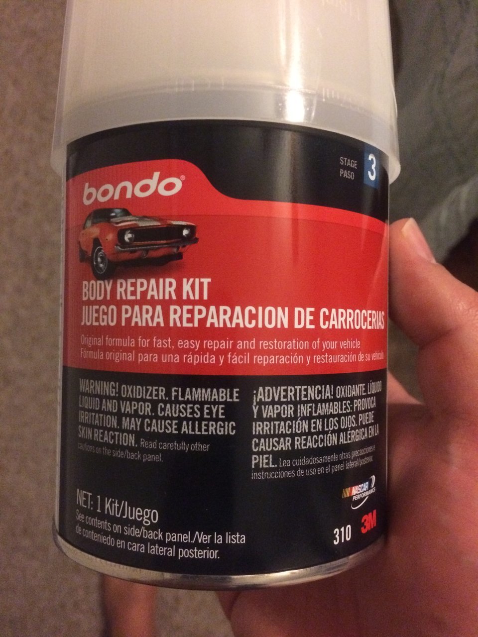

    This one. Yep, I screwed up the goop to activator ratio pretty bad. I think I didn’t kneed the activator tube enough and the 1/4 strip I got out of it was still separated since it looked more liquid than the videos I watched after the fact on YouTube.
