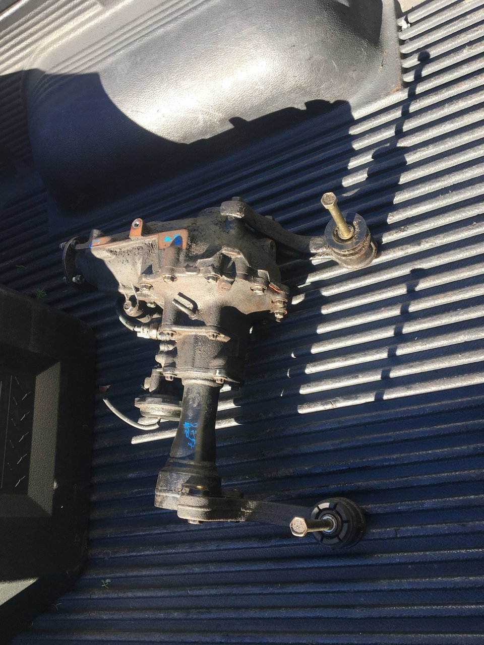

    Finally got the goddamn front differential out! It's funny my friend and I muscled it for a good hour trying to get it out yesterday but it didn't budge. Today I tried @drr's method of rotating it forward and it dropped out instantly.
    I was going get the rear locking diff but it was gone. I saw it on the counter of the cashier with a return tag on it. Must have been bad.

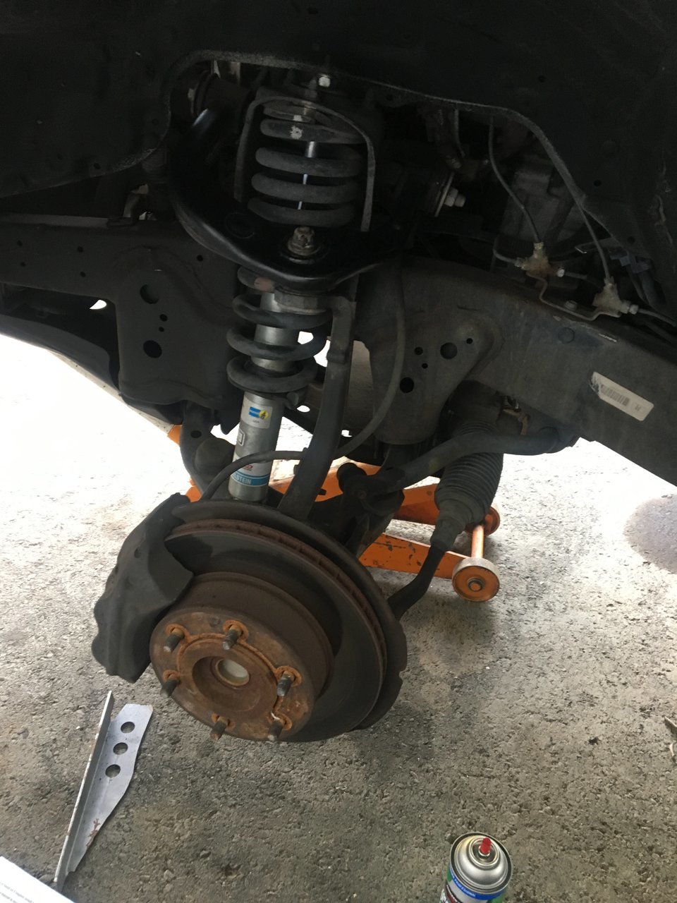

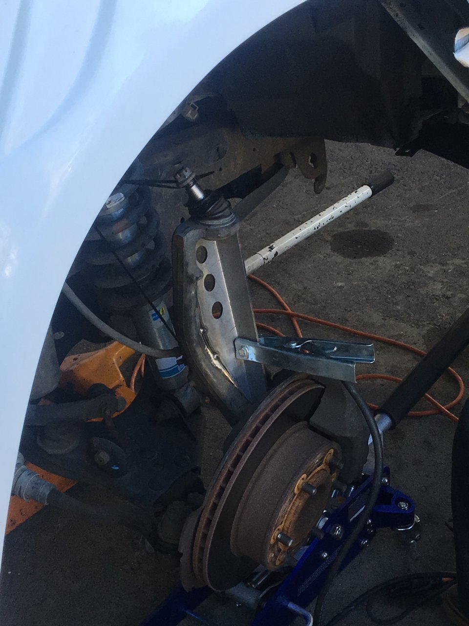

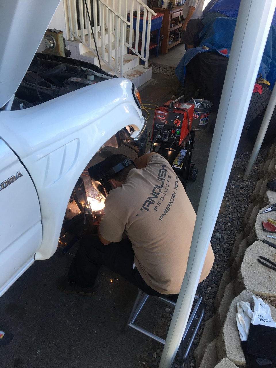

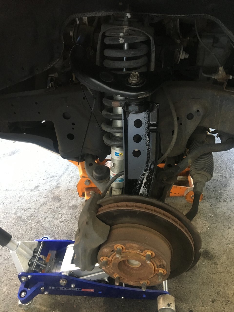

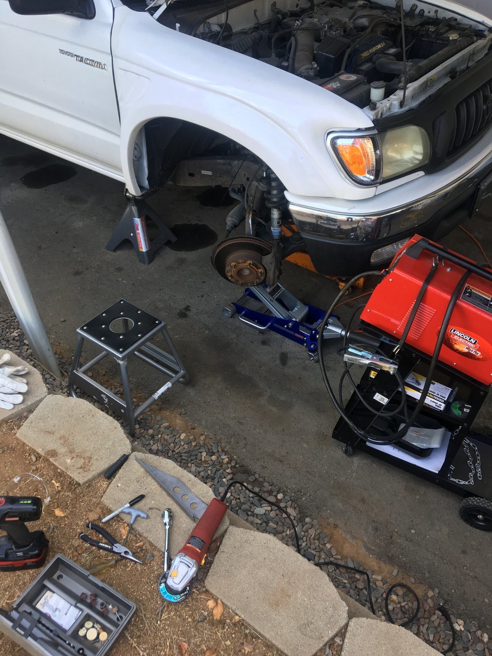

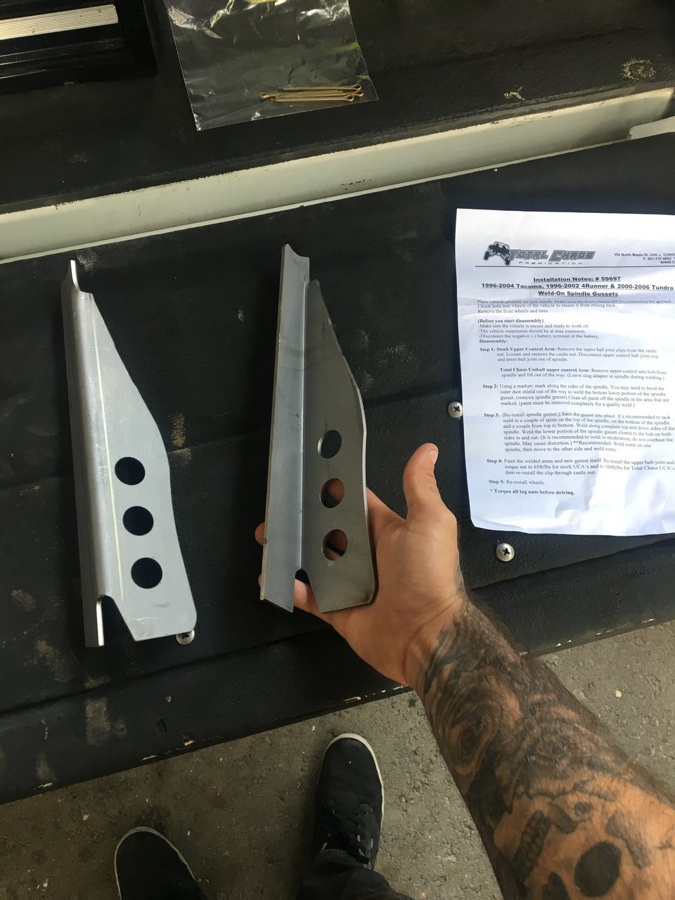

    Total Chaos Spindle Gusset Install.
    Before:
    After:

    I always thought you had to press the bearings out and everything so you just have the spindle itself. With nothing else attached. That's why I've been holding back on doing this. Is that what you did? It looks like you welded the gussets on, while everything everything was still attached. Every place I've called, said you have to have the bare spindle. But I might be getting mixed up with this fab shop that has gusseted spindles done already and you get avset and give them your old ones. Which in that case you would have to press the bearings out.

    All we did we drop the spindle through the UCA. I’d imagine it would have been easier to weld on a bench but no. We hit it as it layed after disconnecting the uca.

    I welded mine on a bench, but with the bearings in. Hasn't presented a problem yet.
    Just don't ask if you need to preheat them or not. :bananadead:
