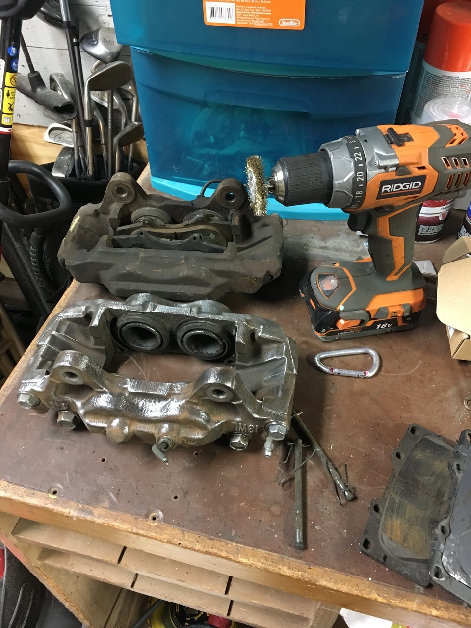

    51114E12-BCDA-4044-B606-37C0C7BA803A.jpg Started to clean up my tundra calipers, before I paint them. I need to figure out a better option use to clean the second one. It took forever. Thinking an angle grinder will be better

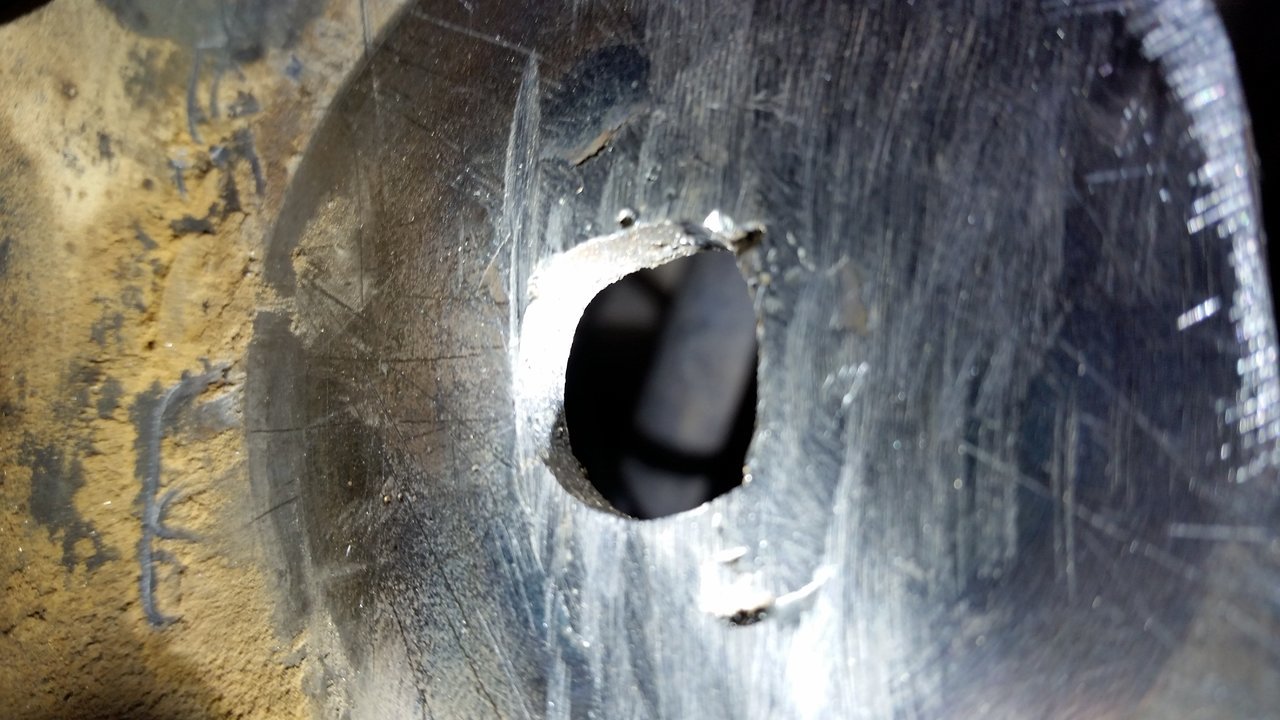

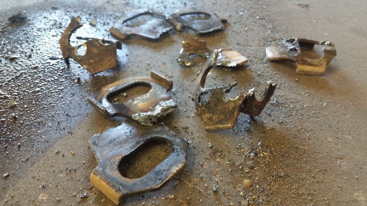

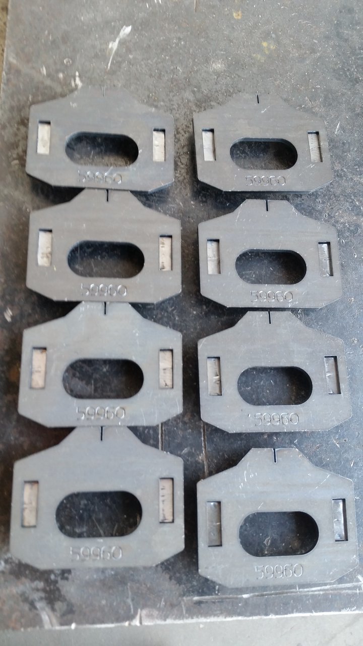

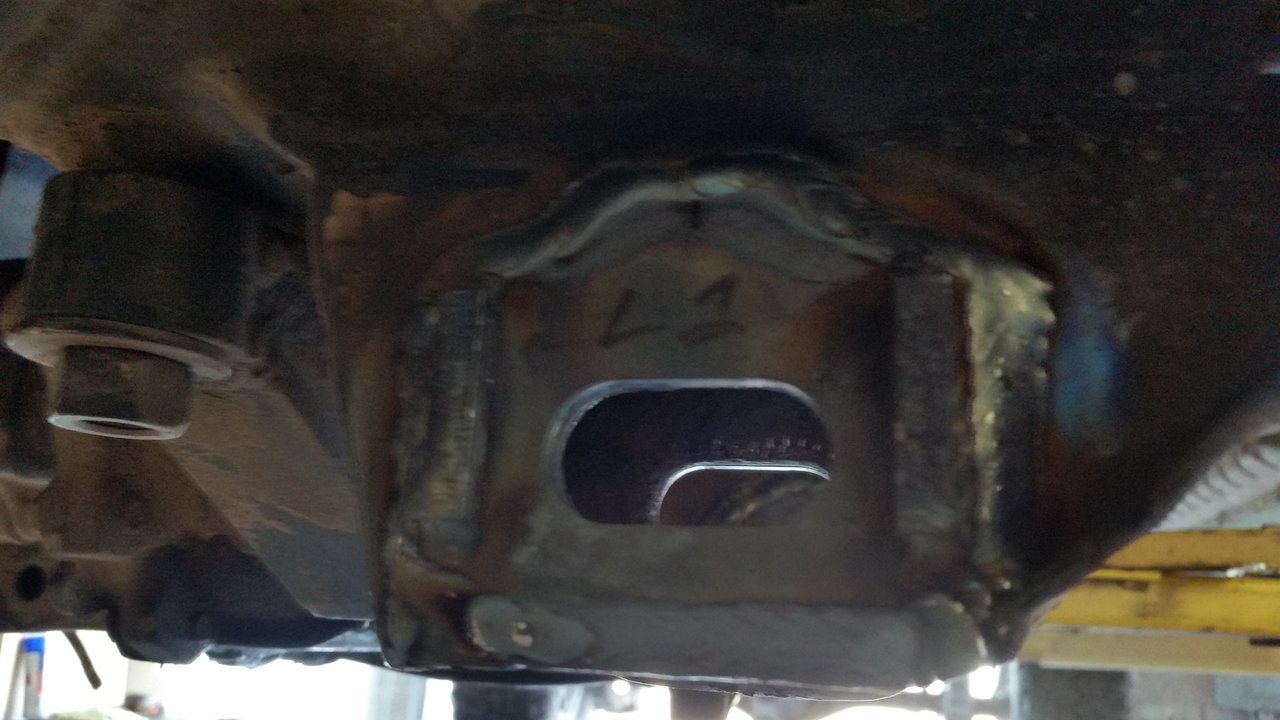

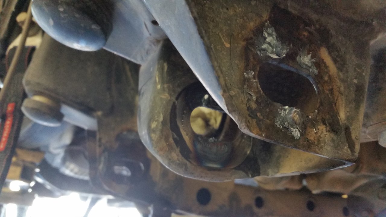

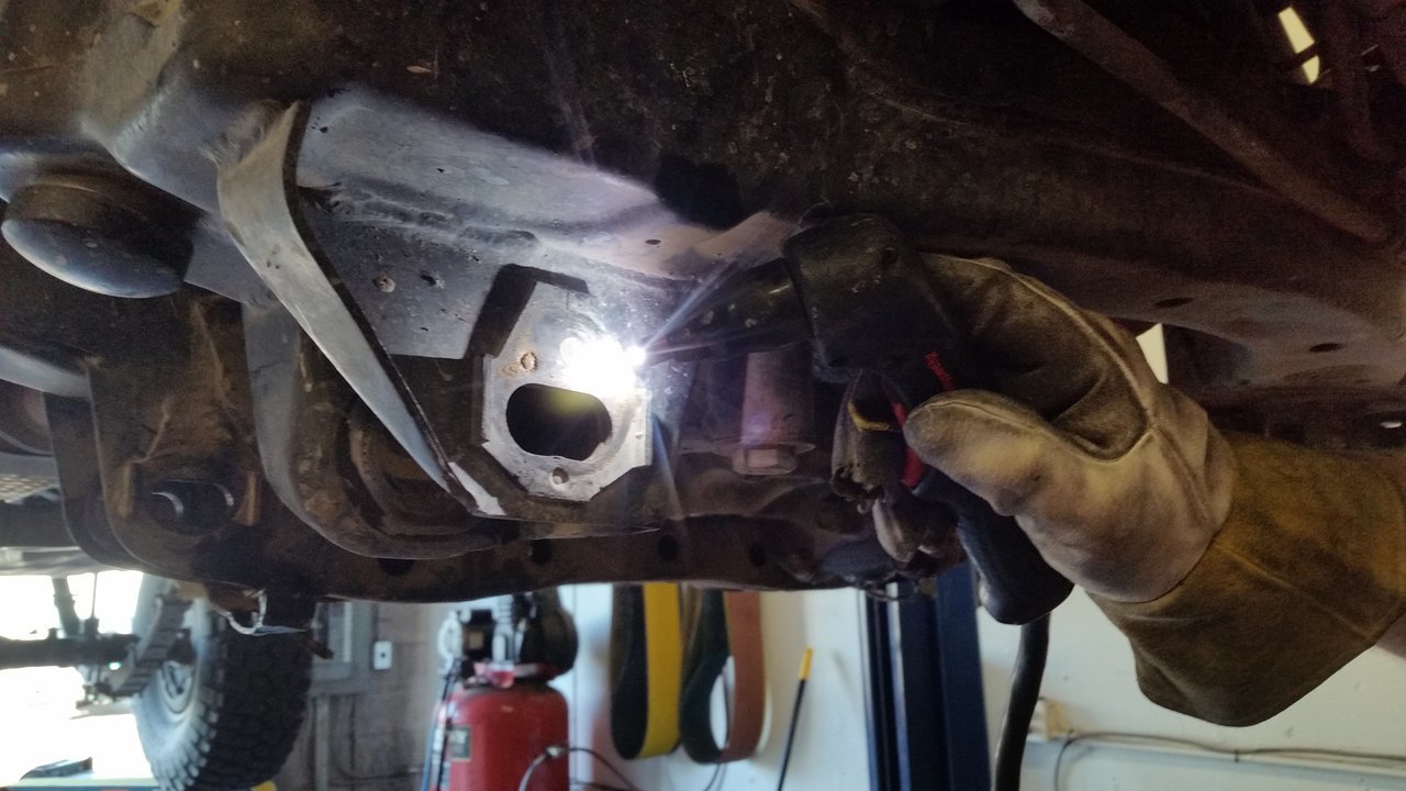

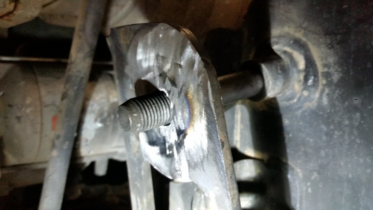

    Made some small progress spread out over the last couple days. Cut the old cam tabs off with the plazma. Noticed the driver front Lca mount was about 1/4" farther back than the other side, so had to carefully beat that back into place. Measures out perfect now.
    Then welded on the TC cam tab gussets. After that more repairs, noticed the coil bucket gussets had some big slots where the bolt comes through, so I welded up the slot and ground the hole til bolt fit again. Hopefully more to come later this week.

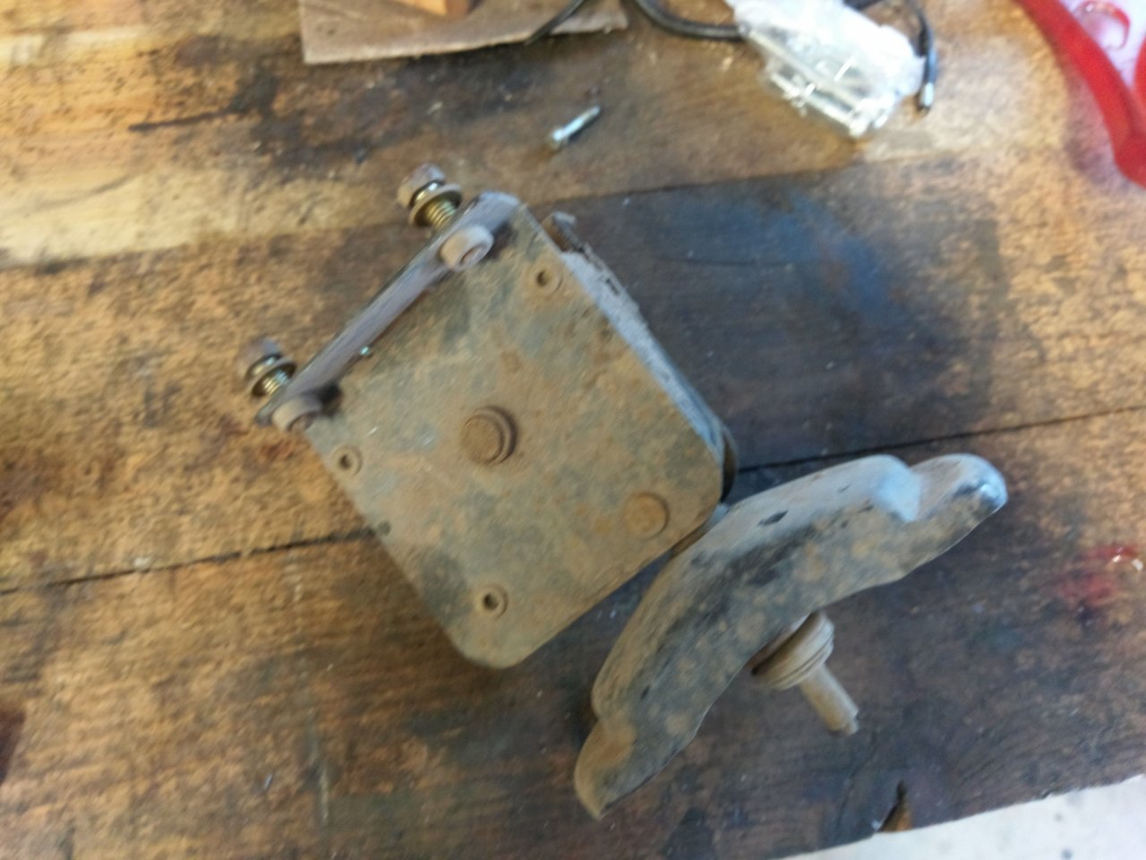

    Found the tools for lowering the spare tire carrier and in the process of mounting the spare (for the first time since ive owned the truck) found out that the small metal piece that holds the wheel is broken on one side.
    Anyone know where i can get just the piece (searched to no avail) or will i have to buy the whole carrier assembly

    No angle grinder, get a bench grinder with a brass wire wheel. Make sure to protect the pistons and rubber boots and go to town. Alternately tape off everything important and borrow a sand blaster for a couple mins, sand blaster would clean it up real fast.

    Don’t know anyone with a sand blaster. At this point the angle grinder with a wire wheel is my only other option.

    For how small those are and all the nooks and crannies. I'd just get a brass wire wheel or something else kinda coarse for a Dremel and use that. I think an angle grinder won't reach the important places an may mess up the less robust areas.

    The first one I ended up using a dremel it just took quite a bit of time and ate through the wire wheel.

    There is a recall for the spare tire carrier. Check to see if yours has been done yet. If not, don't waste your money doing it yourself when you can get one put in for free.
