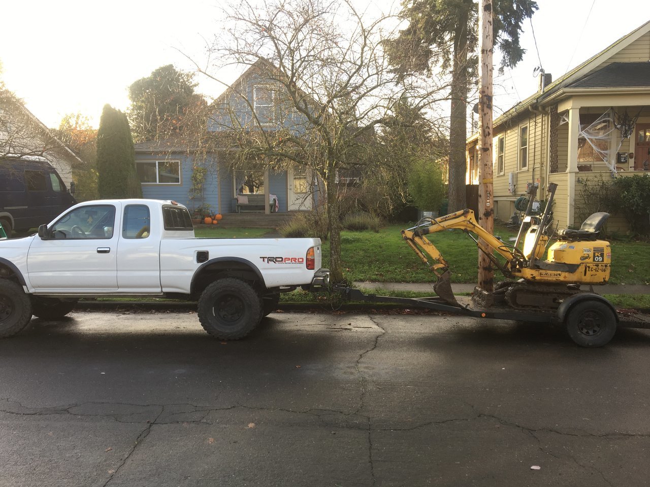

    upload_2017-12-4_12-20-42.jpg Not today, over the Thanksgiving weekend I replaced the heater core, i hope to God i never have to do that again. Local dealer wanted $492.00 for just the heater core, i got the heater core, valve and hoses for just under $250 and saved probably $850 to $1000 on labor.

    That picture gives me agita.

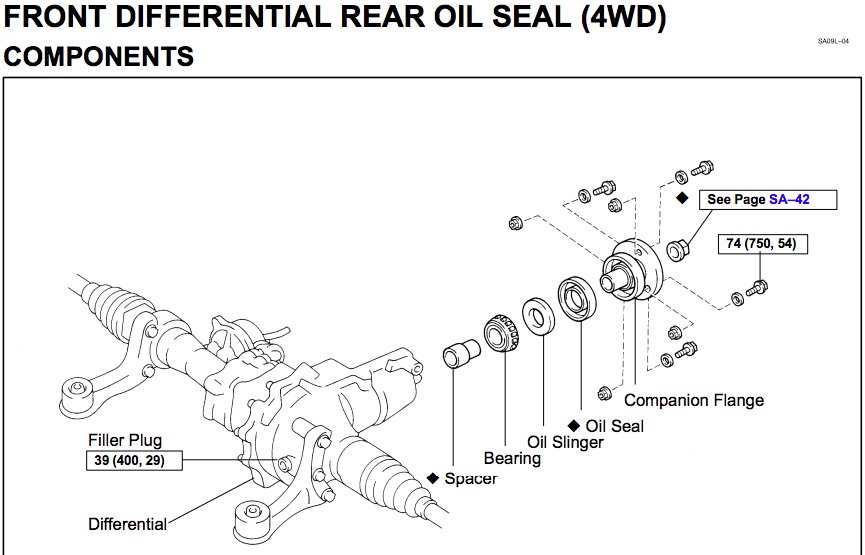

    Replacing all the seals on my front diff. Do I need to replace the companion flange oil seal or am I fine without doing so?
    So far I'm replacing the oil seals on the FR axle tube and the FL axle input.

    No. All that is is basically a dirt shield to keep big stuff away from the pinion seal.
