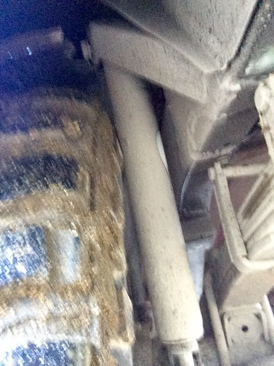

    10" shocks? How much of the shaft is showing at ride height? Looks to be quite a bit.
    Also, flex it yet to see how bad it rubs?

    Rub the tires at all?
    And are you getting the most out of those shocks travel wise? Is it possible to do the u bolt flip as well

    Yeah they're 10''. I need to measure how much shaft is showing and see what kind of down travel I have. I was looking at it earlier today and thinking that it seems like it was set up with too little down travel.

    Tires rub a little on the topsides of the fender and shock body. Once I do a U-bolt flip, I can fine tune the bump height to eliminate this.

    But how would you fix that? You can’t really move the mounts without cutting them out.

    Yeah I'd just have grind off the lower mounts and re weld them at a different angle. Wouldn't be too big of a deal. I don't think it's actually an issue though. I drove it today a bunch and it drove fine. It also droops out quite a bit when I flex the suspension out. I posted some more pictures of the shock relocation in my built thread, including flexed out pictures.

    Lower mount is too low for the shocks
    Shock doesn't look close to bottomed out at full bump either.
    Raise lower mounts or get shocks with longer bodies.

    The setup uses full travel when it is cycled straight up and down. I may end up talking with the shop that did the install and have them adjust the lower mounts and do a u bolt flip with longer bumps so that it flexes without rubbing.
