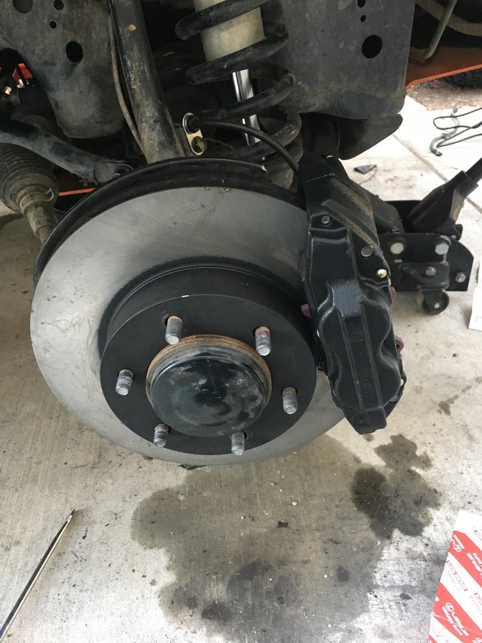

    Pretty sure @Blackdawg said that is typical but at this point I don't remember for sure. Did you two person bleed or just gravity? I like to two person bleed with a clear tube to make sure it is perfectly empty of air, but on my old Maxima I could just gravity bleed no issue, the Taco doesn't respond well to that.

    Two person, with a clear tube. Started rear passenger, then driver rear, front passenger and finished driver front. Did that like 5 times.

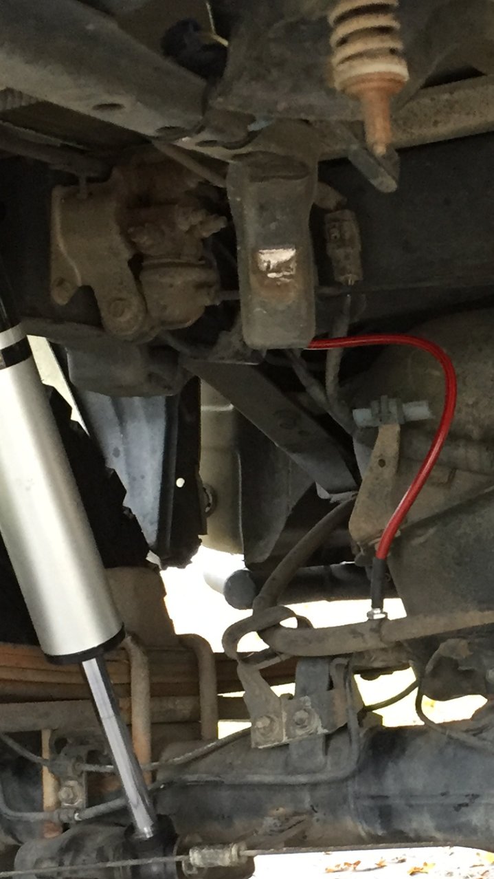

    Question about this. Are there 2 of those, or just the one in the rear? And I didn't bleed the rear one - should I?

    Yeah I saw it when I was putting a longer brake line in. Noticed the bleeder, or what I thought was one. I'll have to bleed it.

    Here is a picture of it I took while installing a longer rear brake line. Did the Tundra mod. too. I didn't bleed the LSPV.

    Yes, you will notice a slightly softer pedal after doing the brake upgrade. The pistons are larger in the Tundra calipers, therefore you need more fluid for a given stroke length (how far the brake pad moves). You didn't change the master cylinder, so you need to push the brake pedal further to push more fluid into the calipers.
    Load Sensing Proportioning Valve - adjusts the braking force in the rear brakes depending on how much load you have in the bed of the truck. If you just changed the front brakes, and didn't allow any air to enter the brake lines (kept the MC full the whole time), then you don't need to bleed the LSPV.
