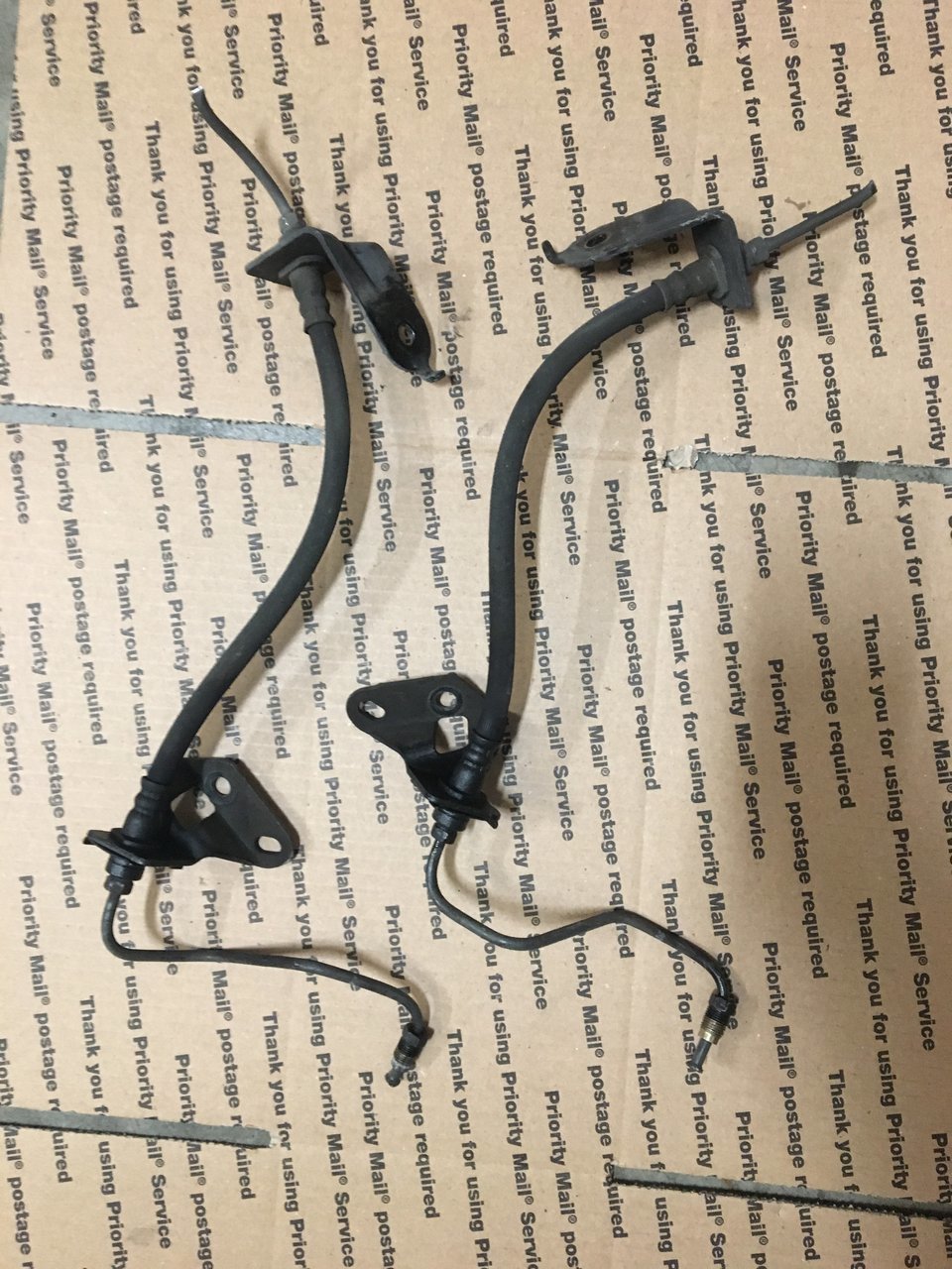

    Did you have to drill or mod your banjo bolts to work with the Tundra brakes? That's what everyone was telling me but I ended up just using new LC engineering brake lines using the Tundra brake line system

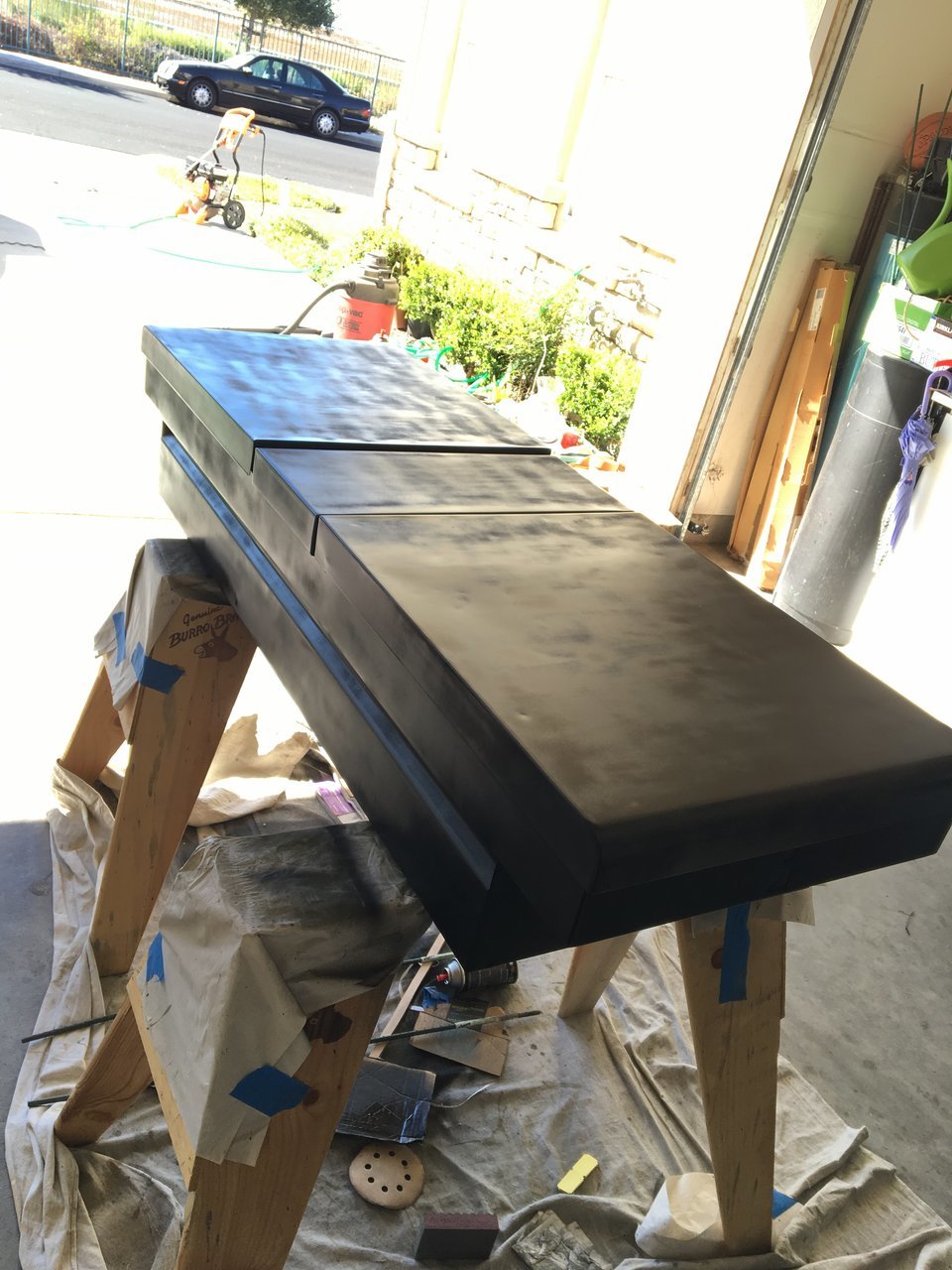

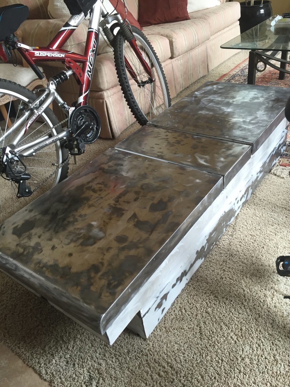

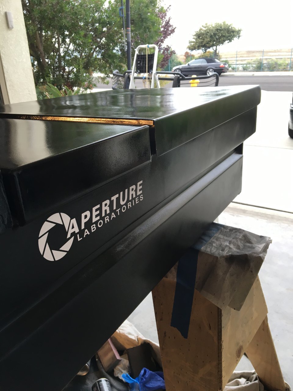

    Ah. This isn't my first rodeo refinishing parts. I had an old Delta toolbox than I stripped and refinished from scratch, I painted it as you would if a body shop were to do it. Priming, wet sanding, priming, wet sanding blah blah blah got tiring really fast. I have massive respect for people who does auto body work professionally; it's really an art.
    I spent more on professional grade two stage clear coat and Toyota #204 base coat than what I paid for the damn thing, lol.

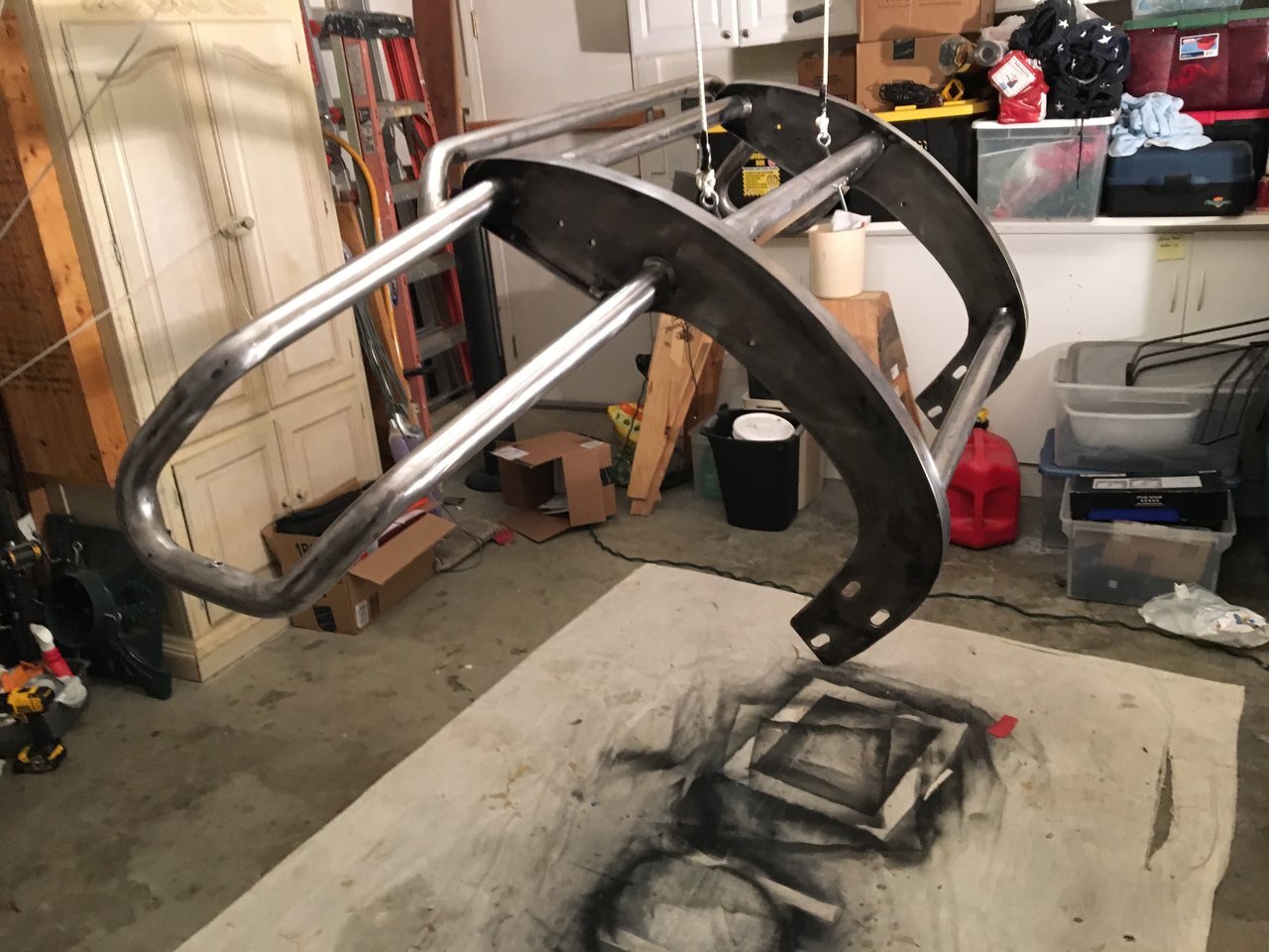

    Did my grille guard too! Used aircraft fuselage paint stripper to get that powder coat off.

    They should, I meant for people using the stock Tacoma line. The 13WL doesn't use banjo bolts, they use hard brake lines with a flare fitting.

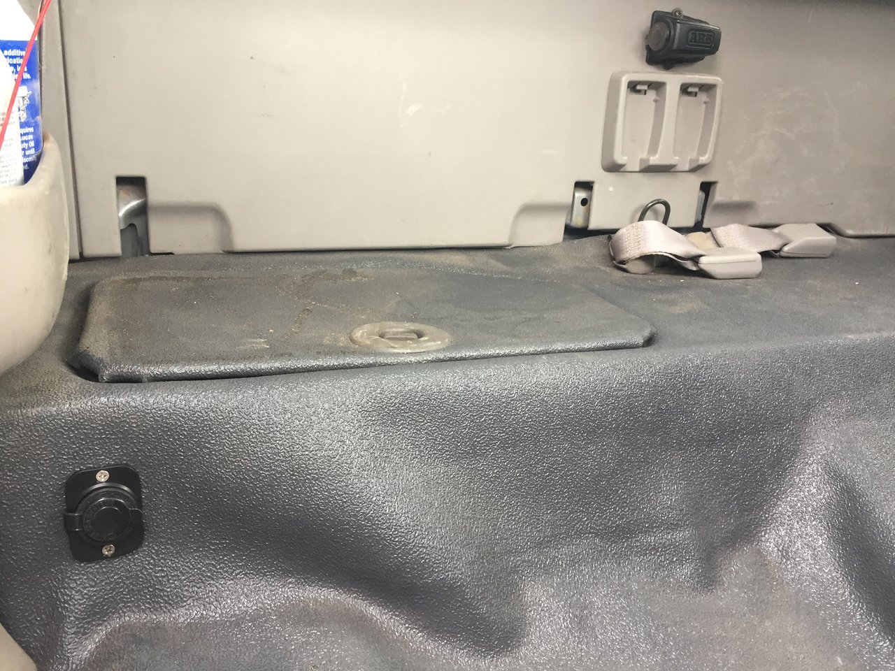

    Disconnected my ARB power outlet and moved the wires to a normal 12v outlet in preparation for a future mod. :spy:
