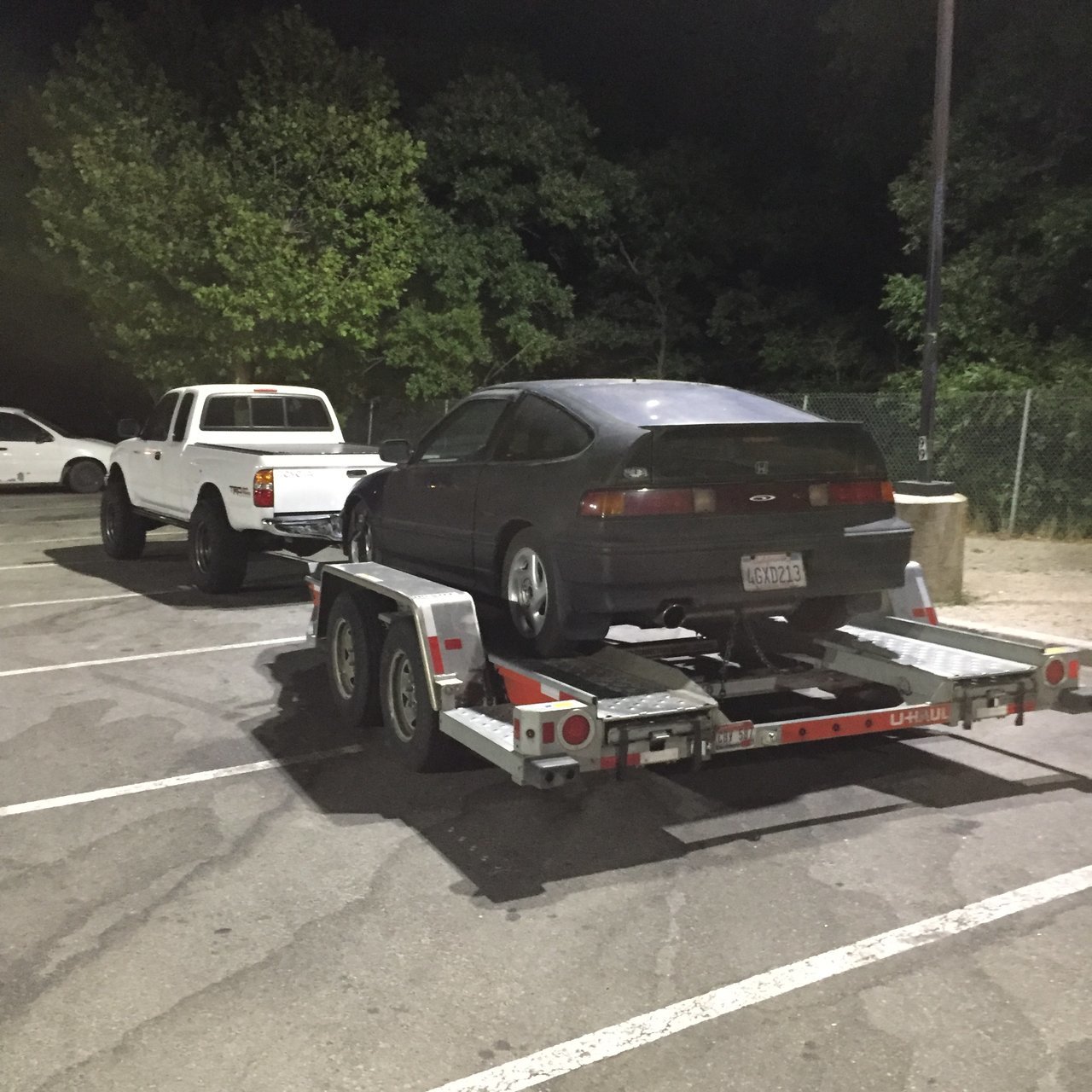

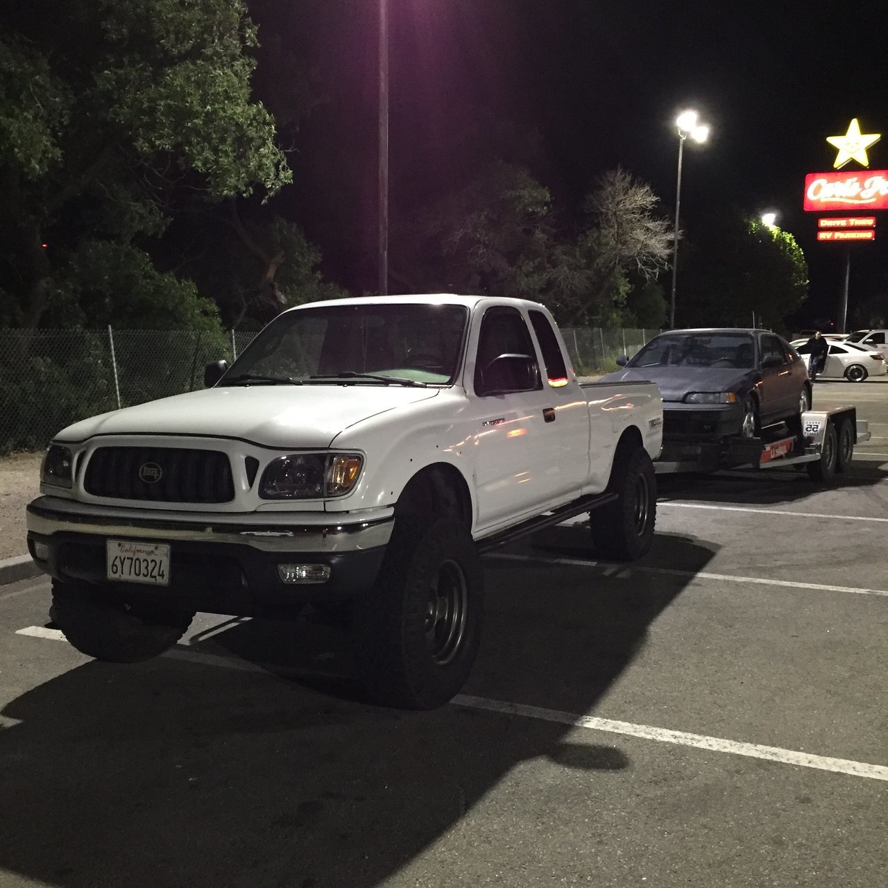

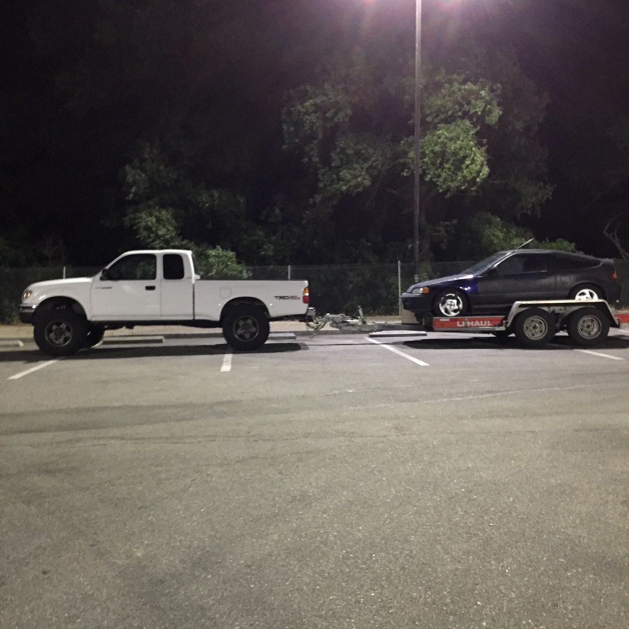

    I did something similar (or even worse) earlier this year. Towed a crx on a car transport with a full bed of parts/tools up the Grapevine (Bakersfield to San Diego). Maxed out at 40 mph during the steepest grades. If I were to do it again I'd most likely rent a full size truck from UHaul to do the towing. Putting that much stress on a 200k+ motor/trans was probably not the smartest thing to do. I was more concerned about braking but the Tundra brakes did very well...glad I had upgraded before doing this.
    A couple of months later I noticed a leak from my rear axle seal and got a slow leak from my radiator. Replaced both axle seals, radiator and did a full front and rear brake job. Not saying that the tow caused all of this, but I'm sure it helped accelerate the wear on some, if not all of these components.
    Since you have Tundra brakes as well, these are the only differences I can think of between your truck and mine:
    V6 4x4
    285/75-16
    BAMF Sliders
    RAT Skid Plates

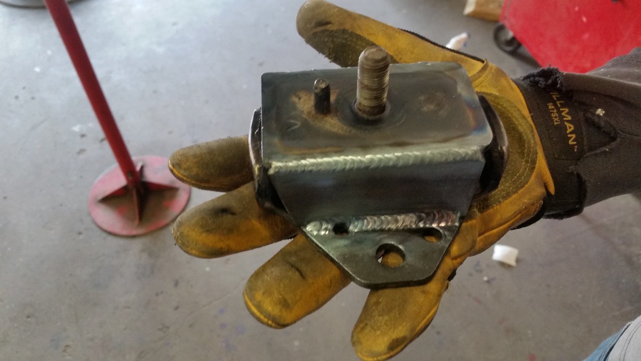

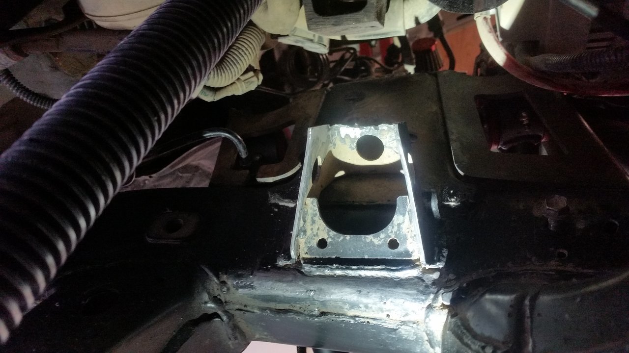

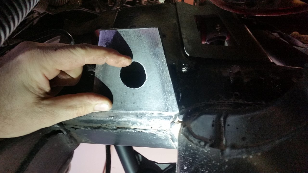

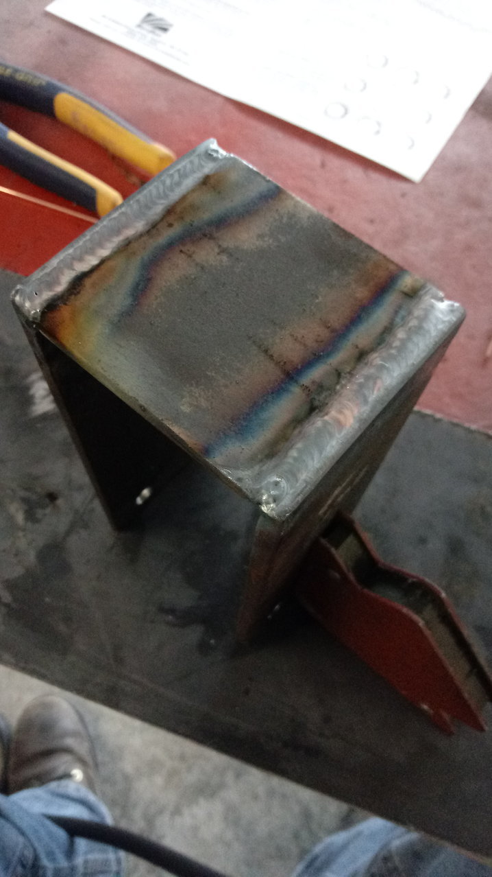

    Great day here in Phoenix, nice overcast weather to work in. @c jackson came to help with engine mount bracing activities. Thanks for the tig welds! Making the separated mounts solid, bracing stock frame brackets.
    In progress currently.
    Hope you folks get something done on your rigs too!

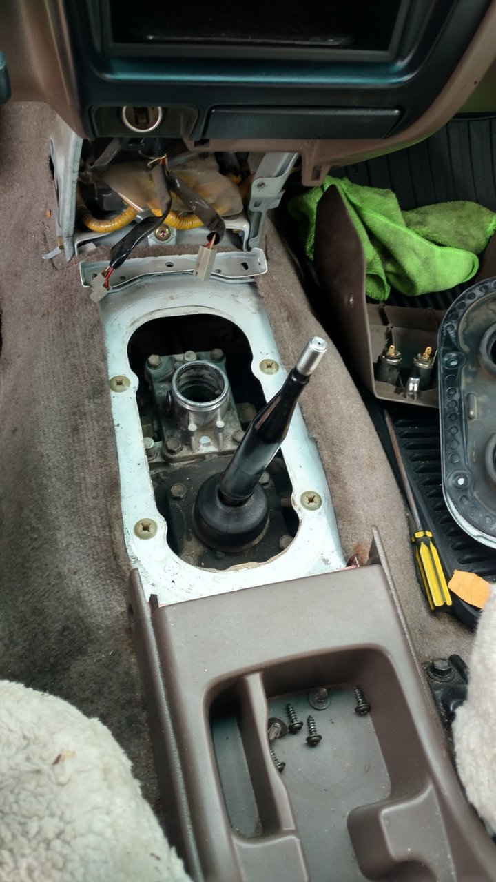

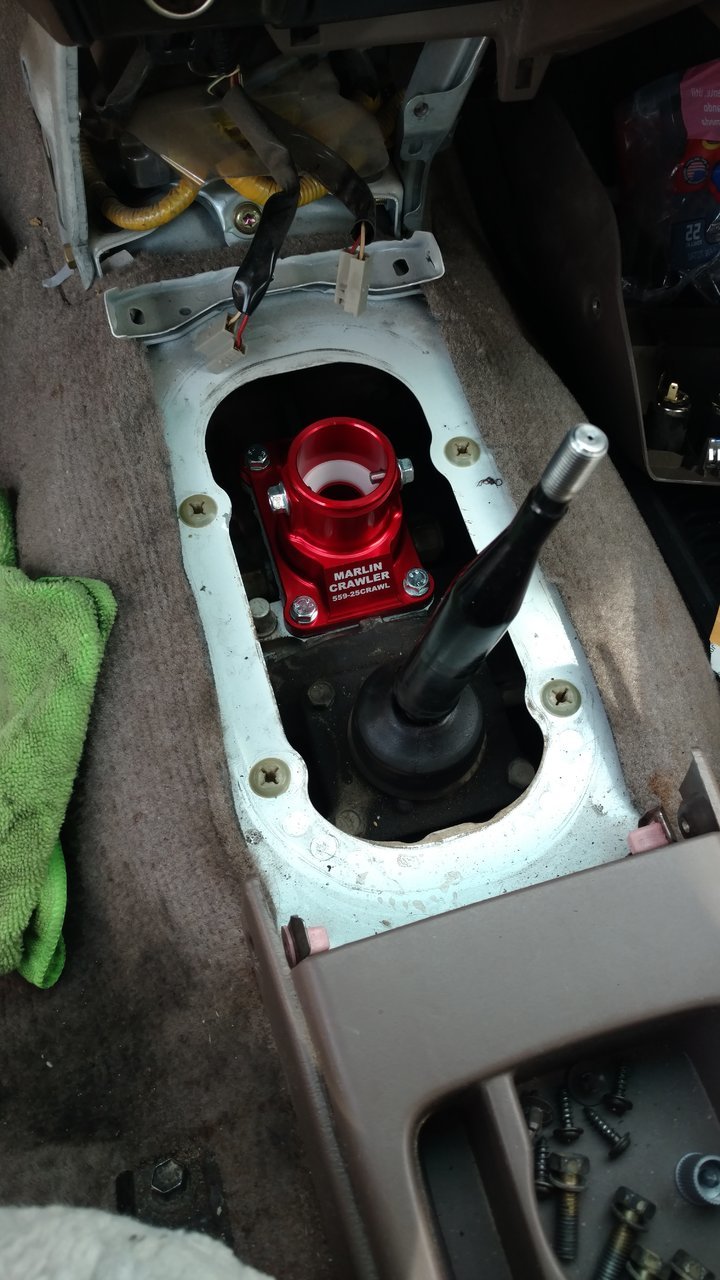

    Today I installed the Marlin Crawler short-throw shifter base and lever kit I've seen recommended on this forum. It all went well except when it came time to install the lock ring. The lock ring provided by Marlin Crawler did not fit their own shifter base. After trying to get it in for an hour I finally gave up and reused the original lock ring and it went in on the first try. Other than that hiccup, I'm very satisfied with the kit and my shifts have a positive feel to them that I really enjoy. It's not what I'd call "smooth" but it's a far better feel than stock. The lever is also a few inches longer, to accommodate trucks with body lifts, I assume. Manufacturer provided an excellent step-by-step guide on how to do the job. Kudos to them for that!
    Original:
    Upgraded:

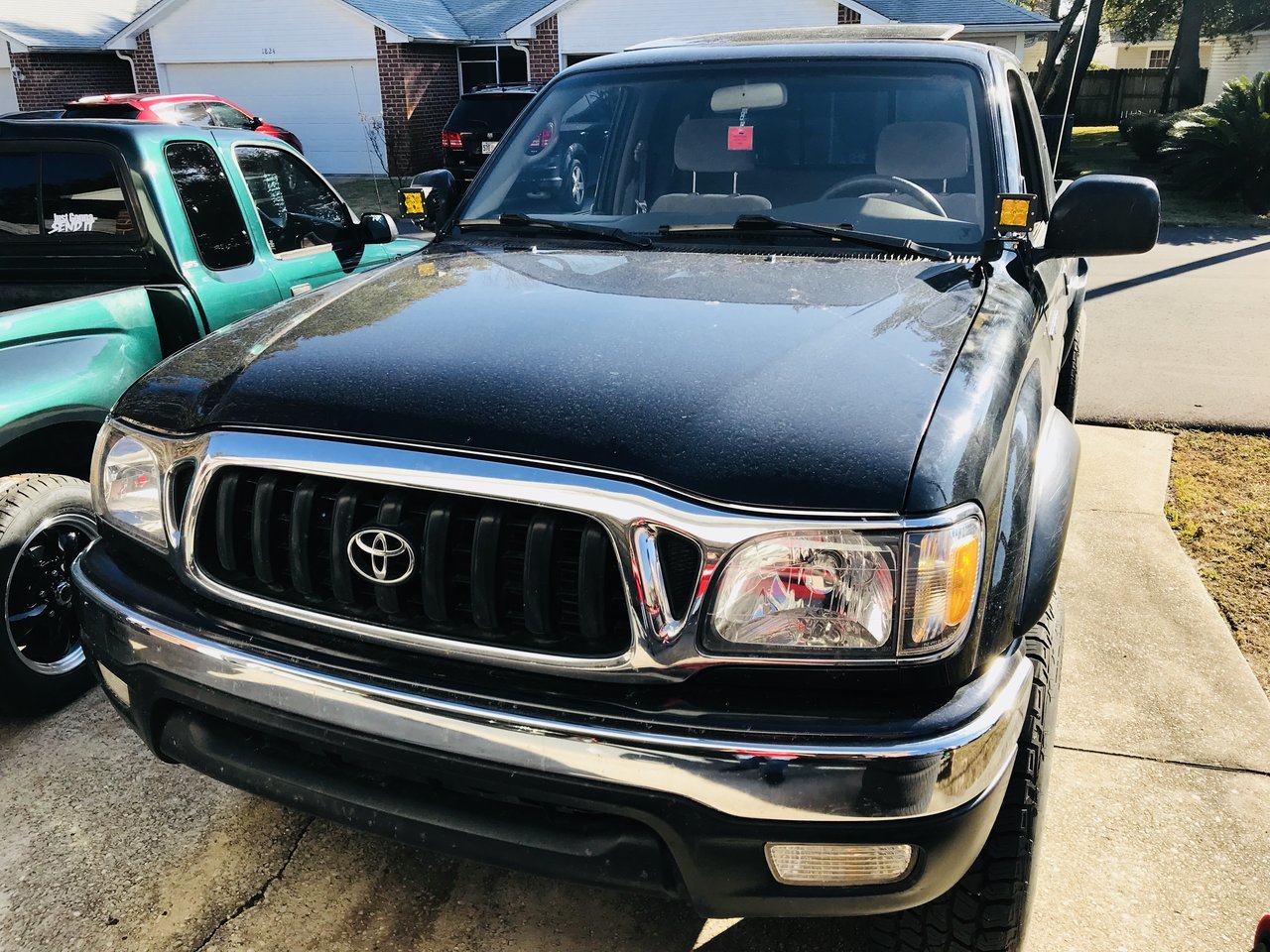

    A buddy helped me install some yellow ditch lights today.

    Make sure they don’t rub the cab. Will make an annoying as sound.

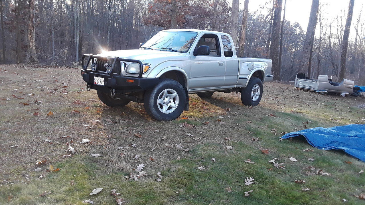

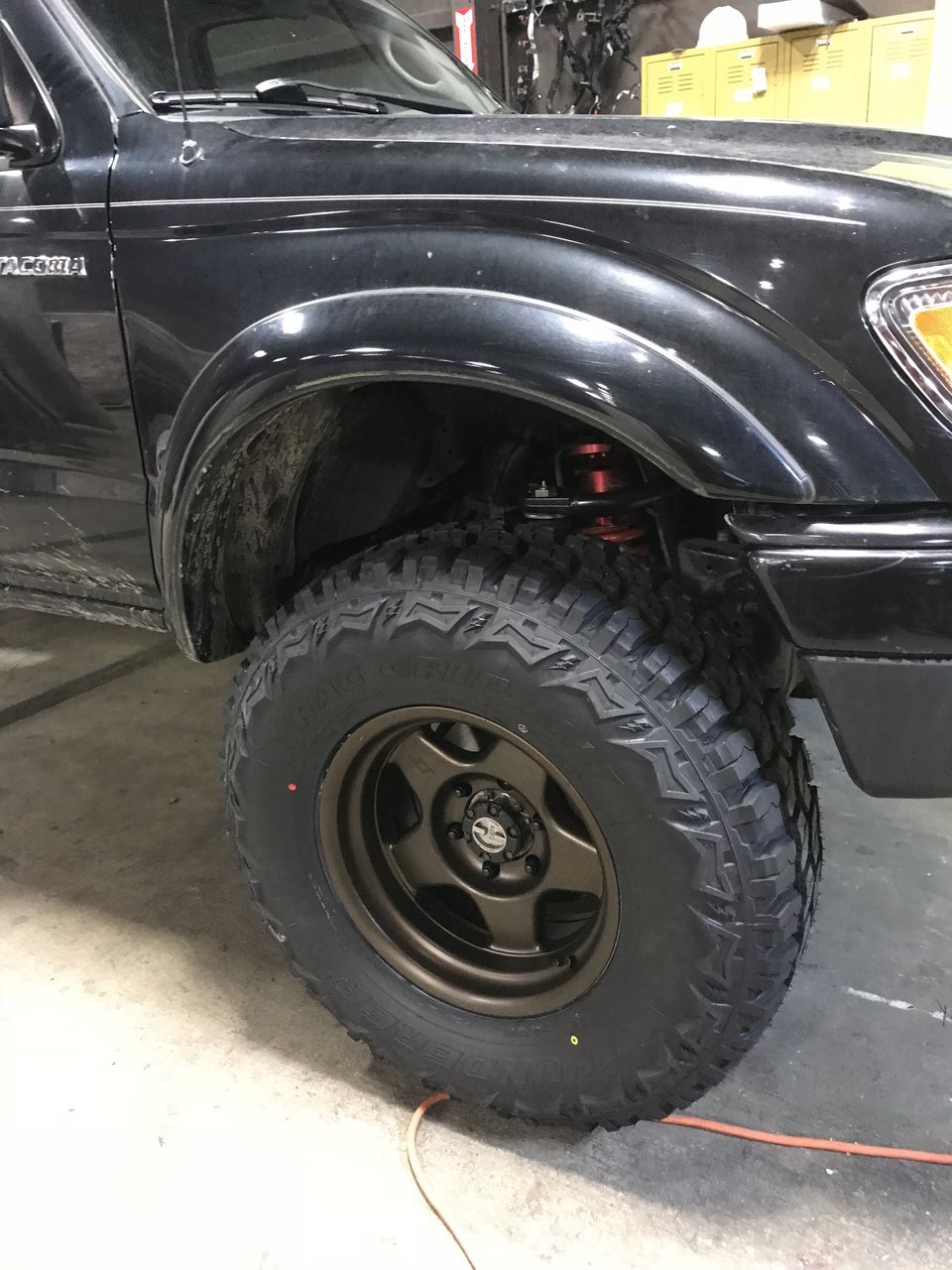

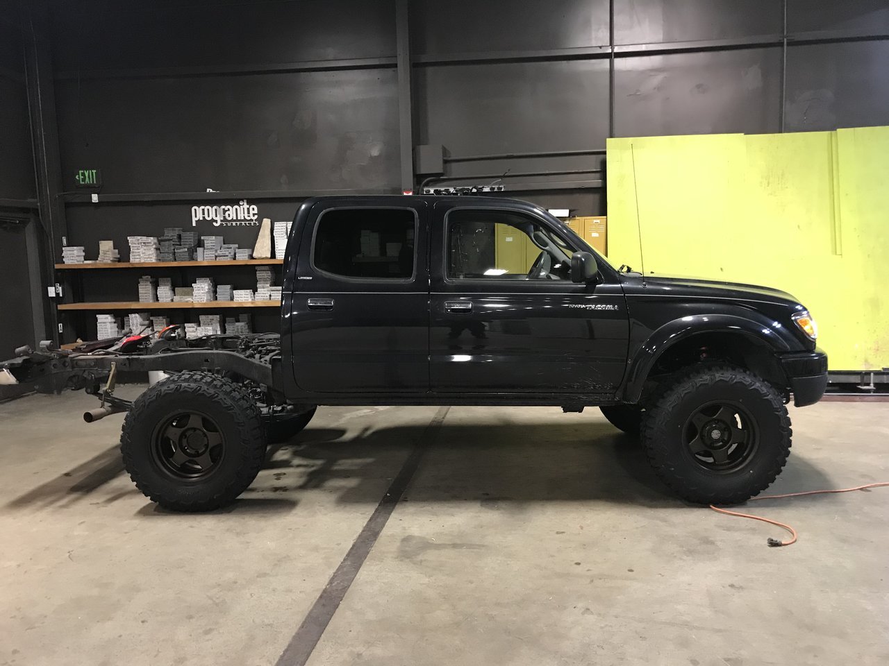

    Adjusted the front coils, threw on the wheels and finished installing manual hubs. Next is 1” body lift. Tires are rubbing at half lock out hope the BL will help some, if not then I’ll do some trimming.
