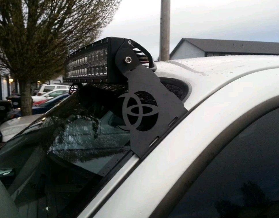

    Got my Whiteline LCA bushings and SPC UCAs in.
    Now, tomorrow I just need to get the front end put the rest of the way back together, and install my AALs.
    Also ordered a bracket (of Ebay) for a light bar I don't even have yet, lol.

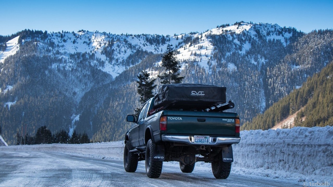

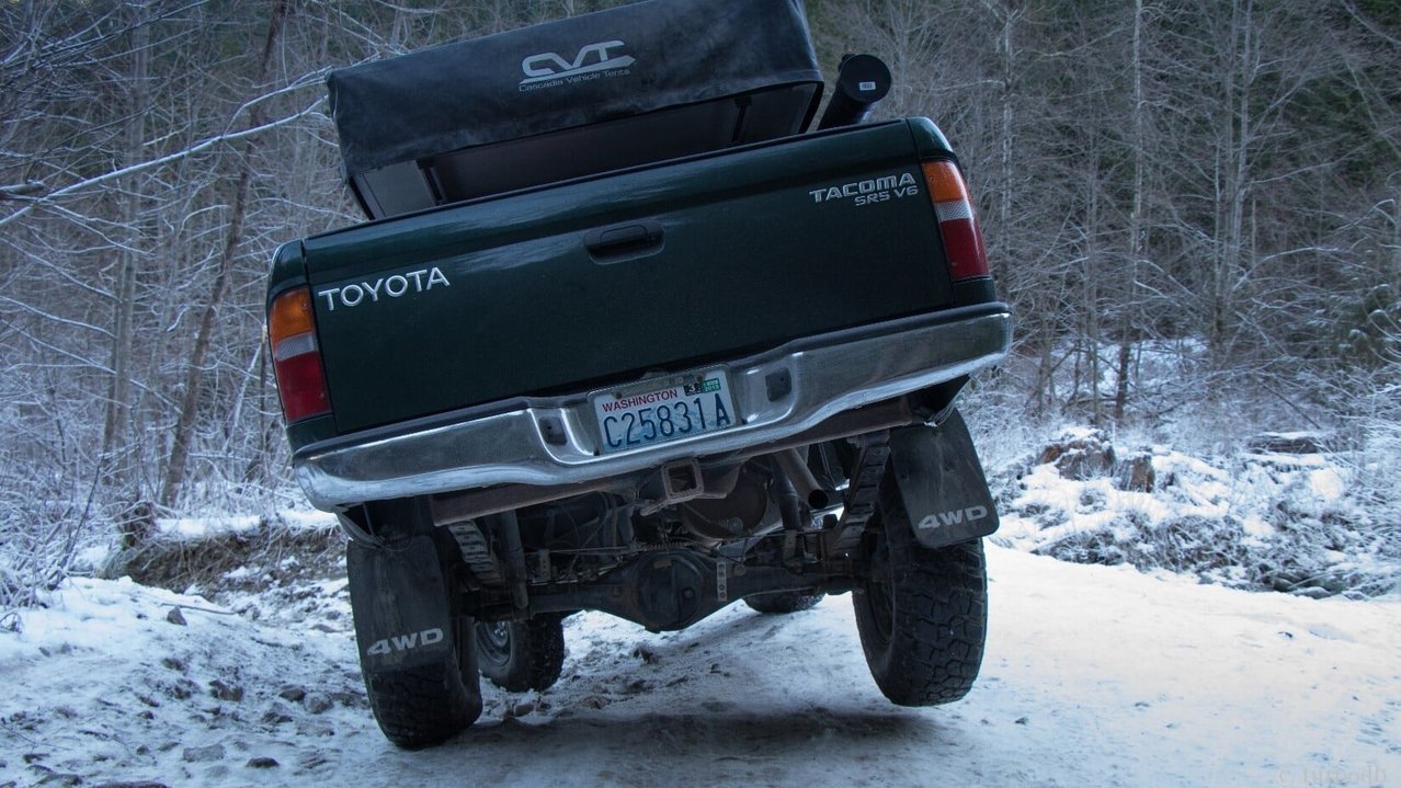

  17. Dec 16, 2017 at 10:50 PM
    turbodb
    turbodb AdventureTaco
    Feb 9, 2016
    #177696
    8,539
    Dan
    PNW
    2000 Tacoma Xcab 4x4 SR5 V6 TRD
    AdventureTaco

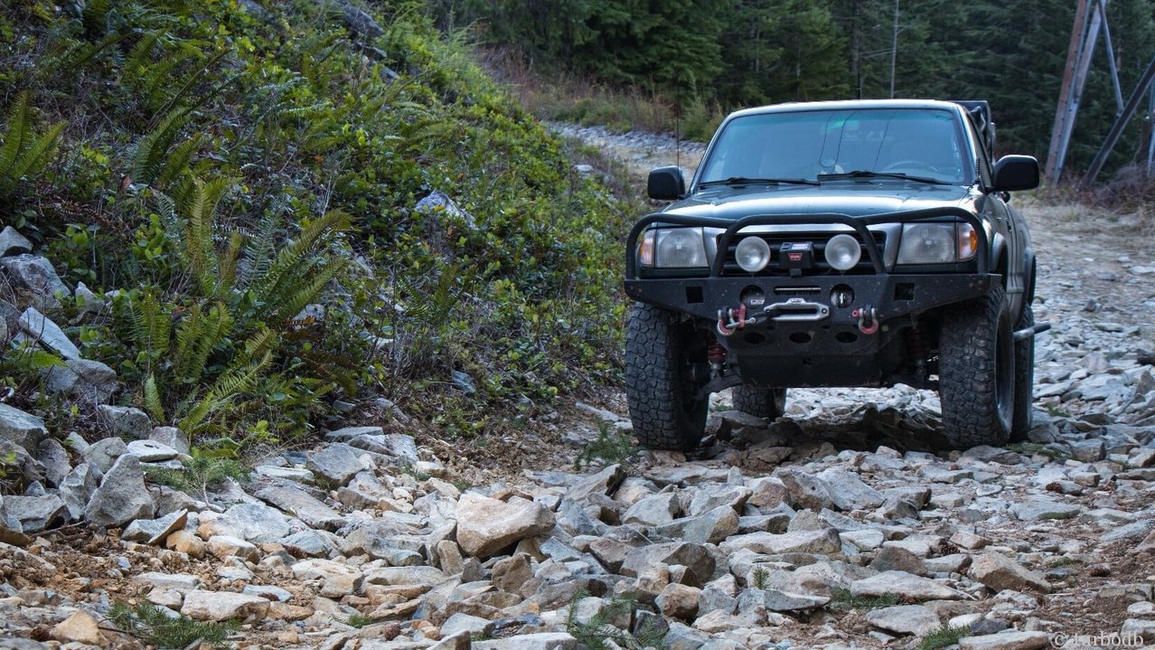

    Wrapped up the write-up for the break-in of the new gears I had installed a week ago. They are awesome - the truck feels "stock" again, and my gas mileage is back up...which is completely un-intuitive to me, given that the revs are higher (but I get it that I'm now in the power zone and it's not all about revs).
    read it all: Breaking in the new gears
