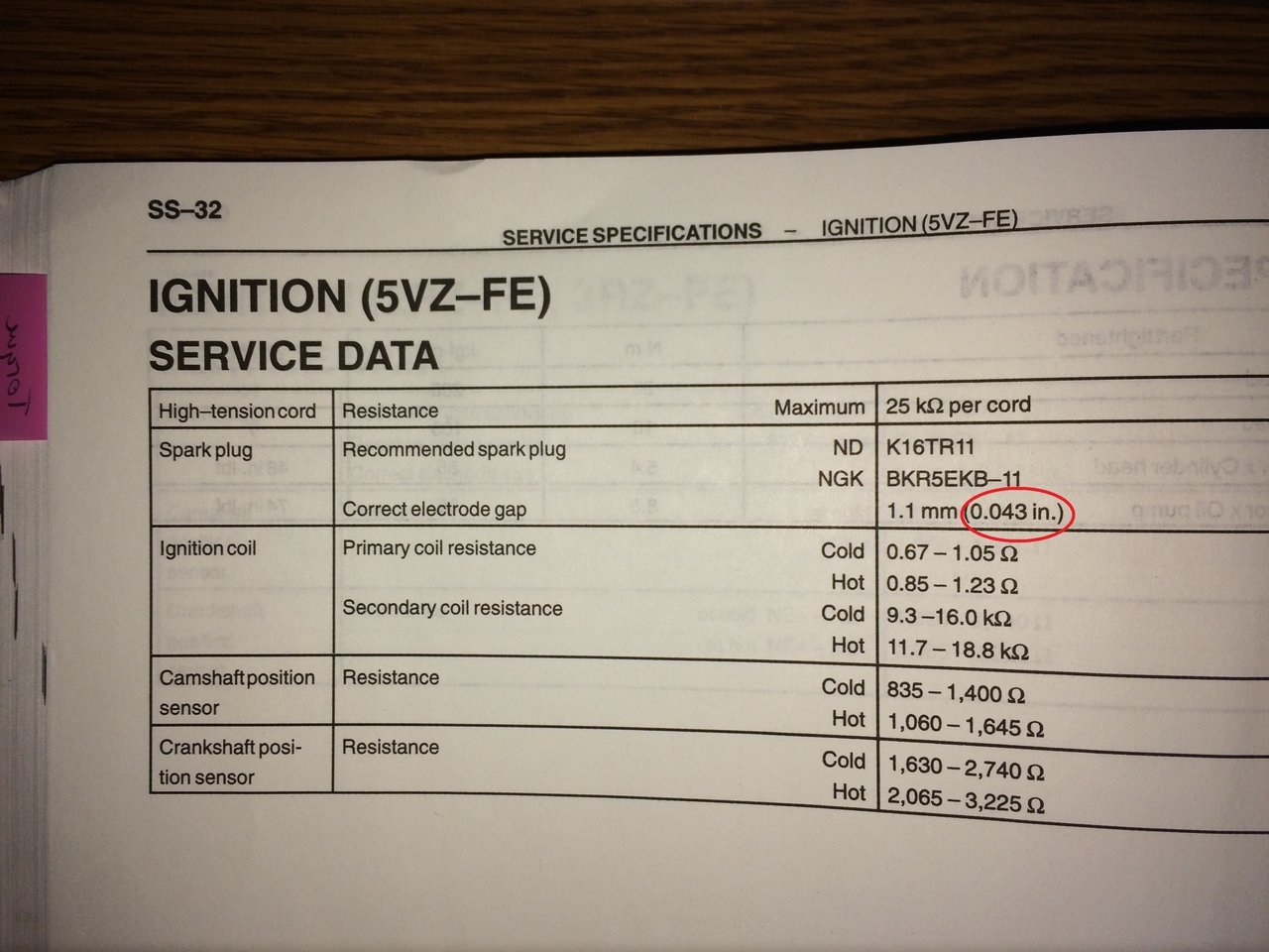

    ngk..each electrode is .35 it runs great. if it runs funky, I'll just pull and regap.but before i changed plugs it ran rough. think the winter blend gas might be the cause.besides it was my first time swapping plugs since i bought it. the old plugs were gapped at .22. and the #5 plug is a pita to get too

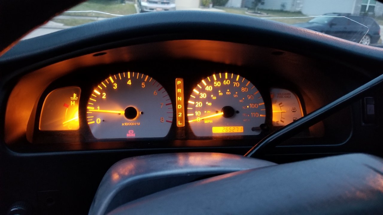

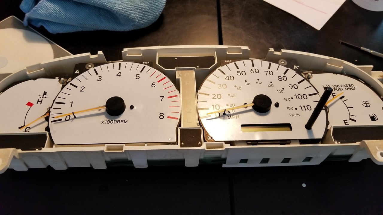

    Write up on how you added the PRND21?
    Does it light up each gear when selected?

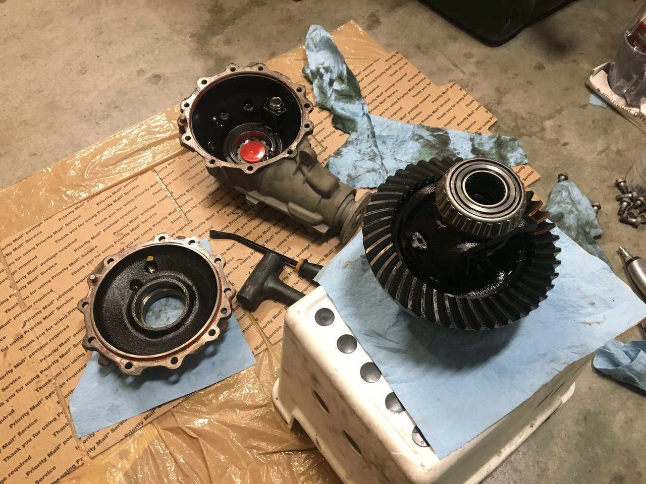

    How much grit was in the bearings?

    Not much at all! I was surprised. The bearing actually sealed most of the sand out, I spun all the gears and the bearings and didn't hear anything. I inspected every mechanical component and everything seemed clean
    I used my air compressor to blast 120 PSI air at each gear tooth and channel to make sure.

    Finally got that stupid ADD gear stub out of the differential ring/pinion gears. What a stupid design. You basically have the remove the whole gear assembly to pop it out with a hammer and chisel.
    Priming the Differential and letting it cure for a couple days until my POR15 comes in the mail.
