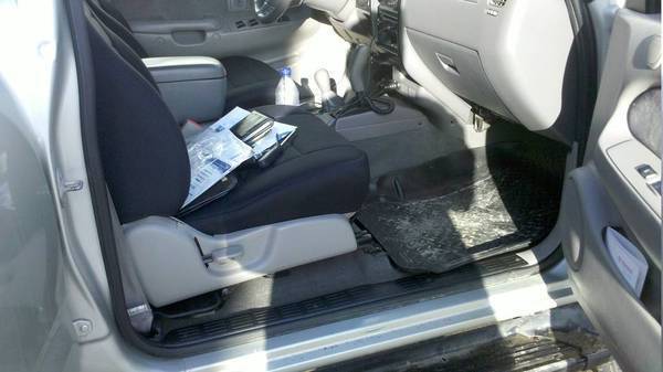

    I replaced my OEM all weather floor mats with some Black Husky liners. Looks much better and hopefully these wont develop a hole in them from my right foot heel !

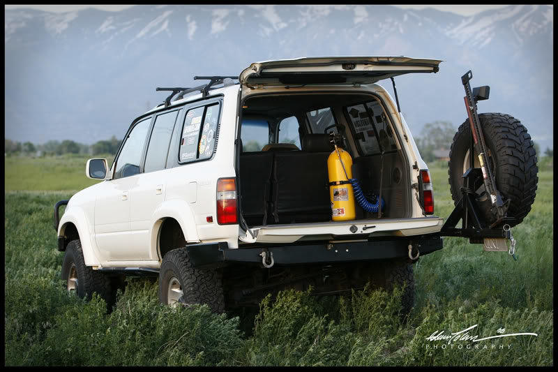

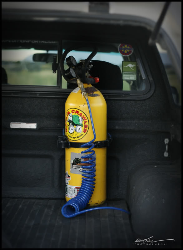

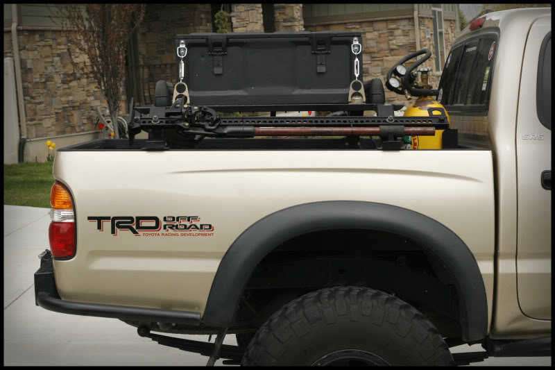

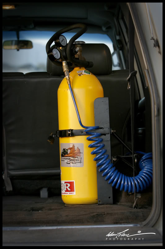

    I've been running a portable CO2 tank for years. Hard to beat the convenience and ability to fill tires quickly. With a good regulator they don't freeze up. Only downside to portable CO2 is needing to refill the tank on occasion. I've only had one time that I ran out of CO2 out on the trail. not a big deal but a dedicated tank and compressor wouldn't have done that.
    In spite of the drawback, I'm a major fan of CO2. I got an old beverage tank for free from a buddy that owns a conveneint store and paid $40 for the regulator. Power tanks are great but are expensive. If you can track down a beverage tank (make sure it's been hydro tested) you can have a CO2 setup for pretty cheap.
    The nice thing about my CO2 setup is that I can run it in the Tacoma or in my Land Cruiser. A dedicated tank and compressor can't do that. Not a big deal if you only have one truck but since I have two it's nice to be able to move it depending on which truck I'm taking.
    Mounted in the Tacoma with the shell on.
    Shell off and bedrack on.
    In the back of the Land Cruiser

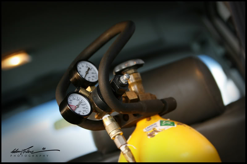

    Shot of the adjustable regulator. Allows me to adjust pressure in case I want to run air tools etc.
