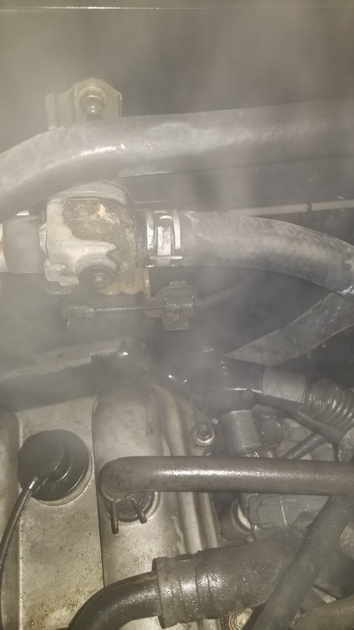

    Wtf just happened?!
    At a stop light then steam comes out from under the hood, limp to a safe spot.
    Only this center piece looks busted.
    I was afraid it was a headgasket

    Bummer man, once it is safe to touch see if that hose has become super squishy, that's a high point in the system and tends to get to the point where the rubber turns to jelly

    Yeah, that hole shouldnt be there.
    Anyone know the name of this part?
    Super hot right now.
    Is it safe to drive to a shop or should i tow it?

    Heater core coolant valve, 4seasons makes a good replacement for it for less than OEM. The hose is just 5/8th heater hoses I think. I wouldn't drive it too far it is is overheating, don't wanna make anything worse if you ha e AAA use it
