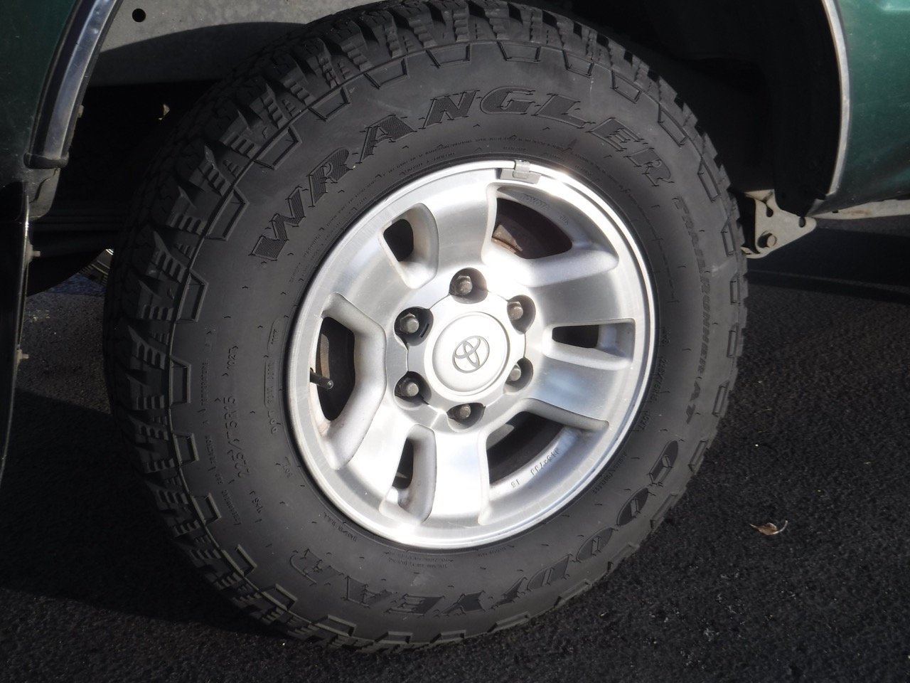

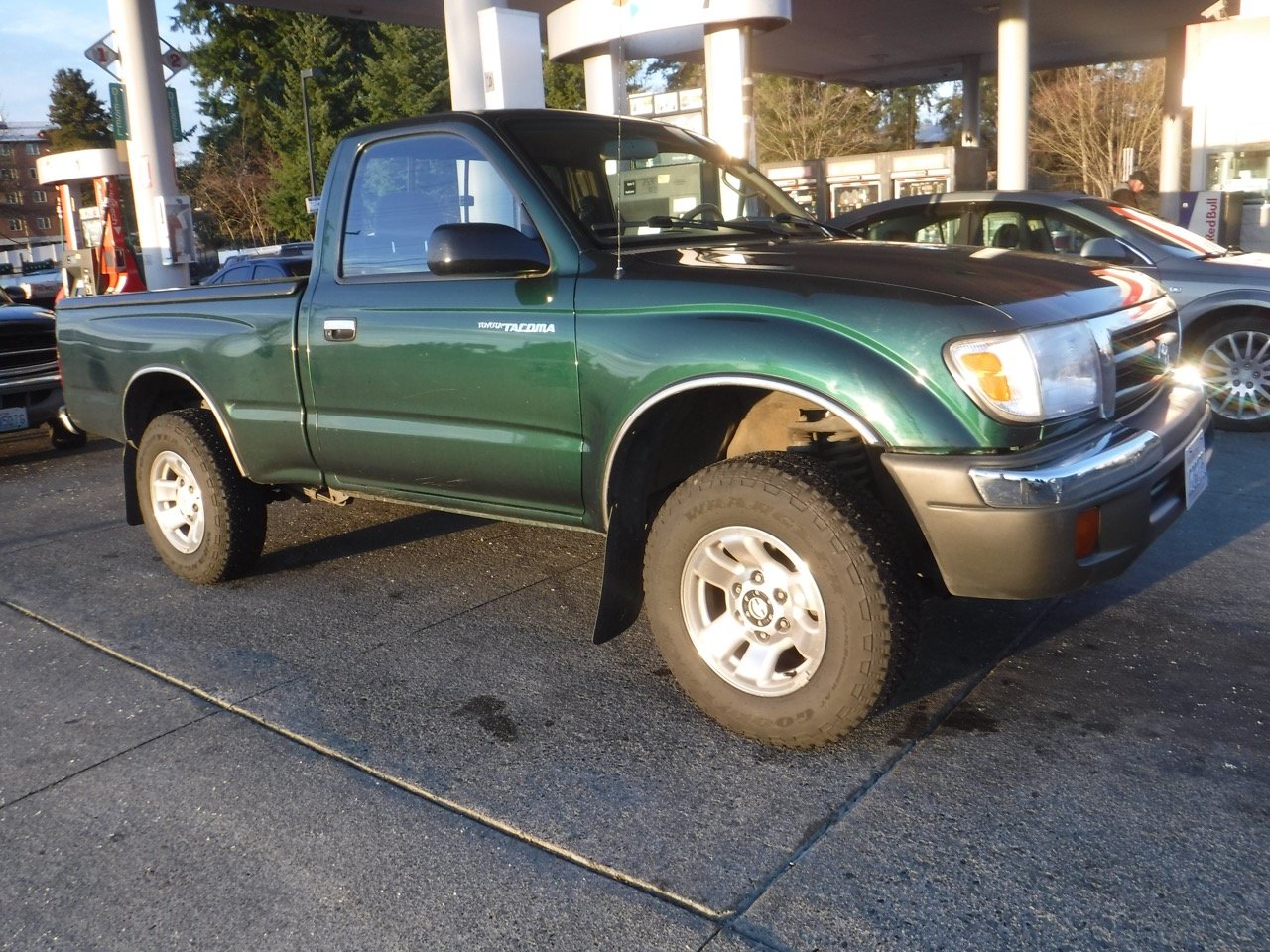

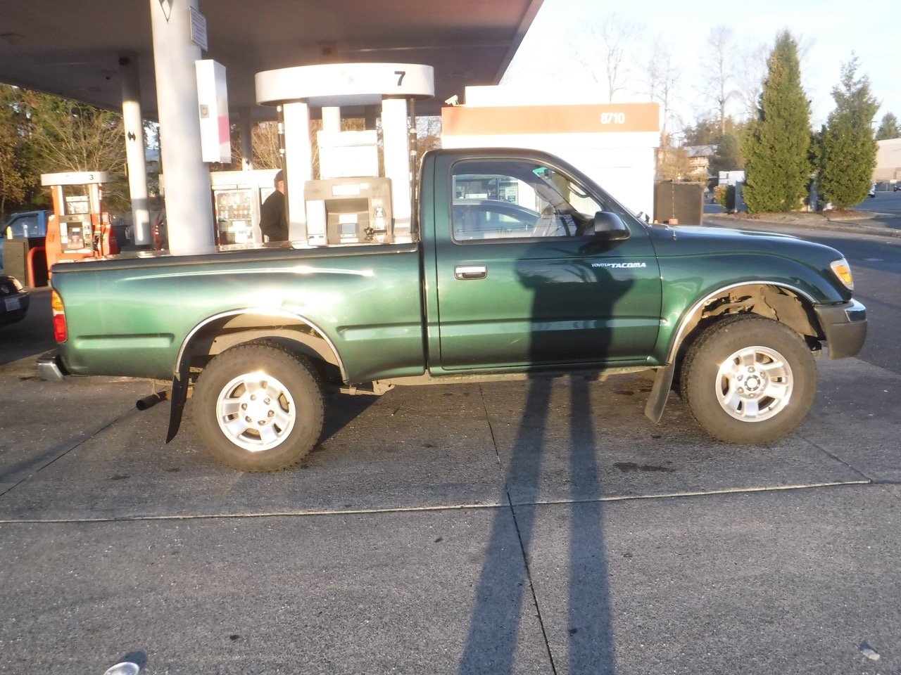

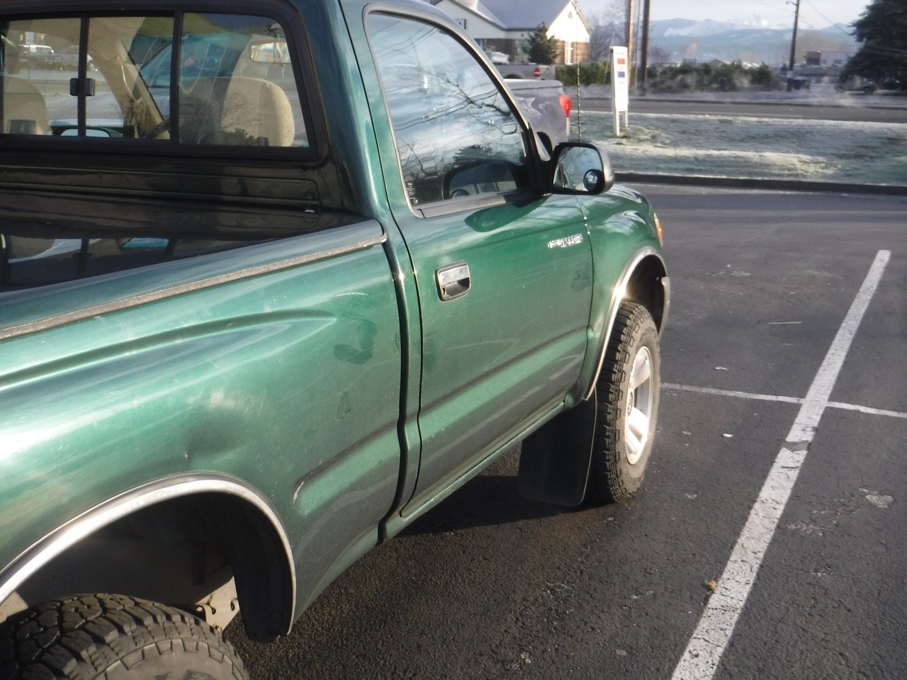

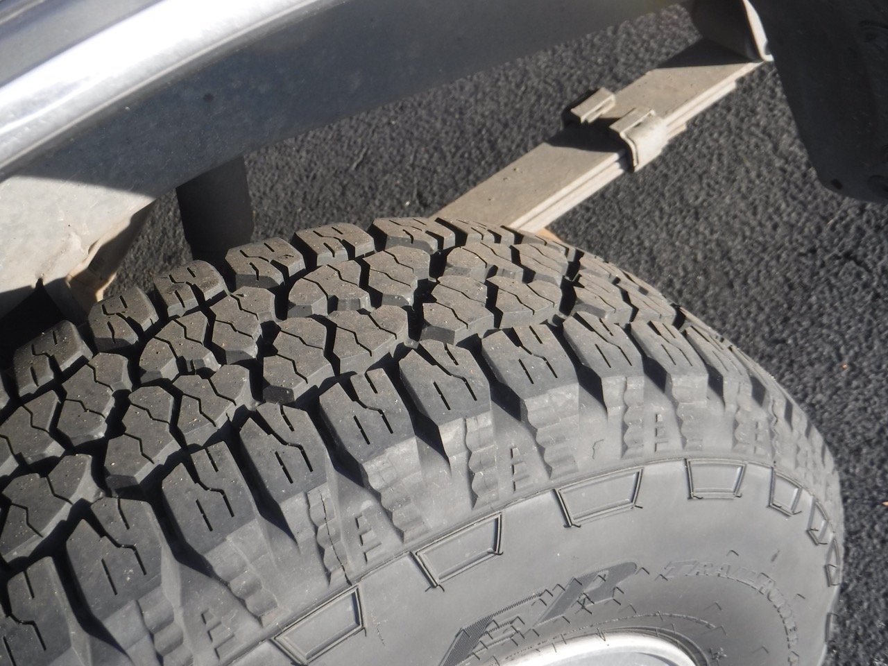

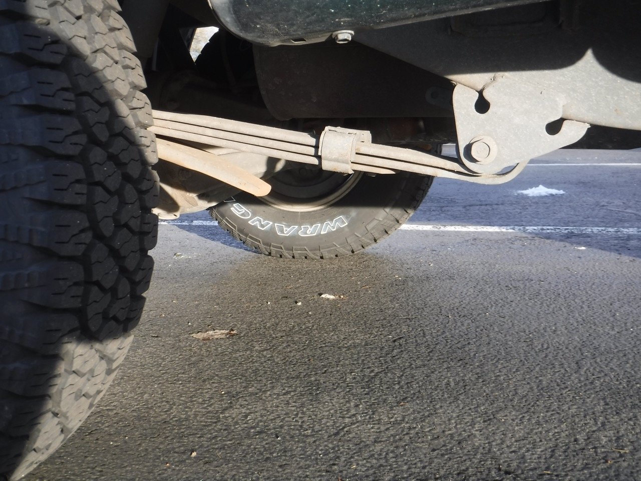

    I have no idea how to find the original thread where this conversation started, but I bought new tires a week ago - and did go down from 256s to 225s. (The new tires are Wrangler Trailrunner ATs and I paid $165 each fyi. They were the best that I could find given the Consumer Reports reviews for the past couple of years, including most recent, for the road conditions most common to my area - wet.)
    I drives much better; corners much better; and sticks to the road much better. As for the speed/odometer issues related to changing, I couldn't get a straight answer out of the Toyota people, so I will figure out another way to figure out how fast I am really going when the Speedometer says I am going 60 mph.

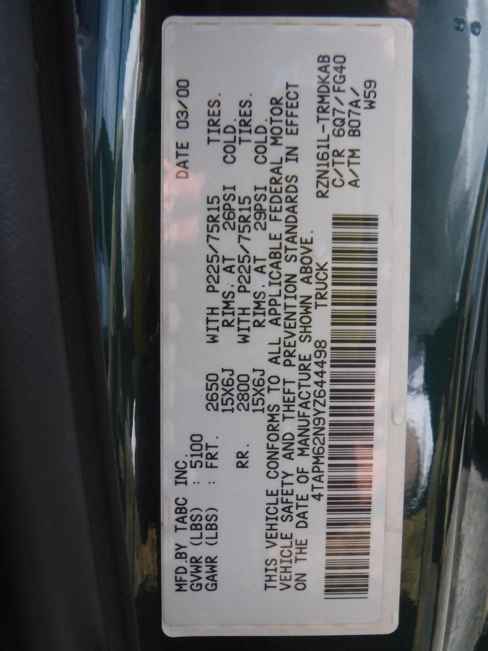

    The door jam label that gave me the info on which tires best fit the truck (thank you to whichever one of you recommended that!), also gave the info on Gear Ratios, and there was some talk here about that. And... someone here published the key to translate what those numbers represent (I think so anyway, moving around and keeping track of which conversations refer to what - and which gen of Tacomas is tricky to say the least.) Anyway, my B07A translates into (1) and 8" ring gear, (2) 4.30 gear ratio, and (3) 2 Pinion, Open differential. Since I have no idea what all of that means I took it to Randy's Ring & Pinion, the guys who re-built the differential on the 2000 2WD Tacoma that I have For Sale - and I asked the old guy there to decipher it for me. He never explained the 8" ring gear, but said the 4.30 ratio means it is "low" and therefore higher RPMs at any given speed (translates into using more gas). But he said that it also means it is relatively better at the 4X4 functions, and carrying loads, and that it would get better acceleration. It was the lowest (?) ratio on the chart (I think it is funny that the highest number represents the lowest gear ratio.), so I am happy with that I guess. In describing the 2 Pinion, Open aspect of the differential, he tried to get me to understand what "4X4" really means: I may or may not be clear on that, but we had a conversation about "pausi" units and "limited slip" and what that would do for acceleration and 4-wheel drive functions. Seems that, except for the money which is considerable, who wouldn't want that? We'll see. If there is a downside, I would like to know what it is.

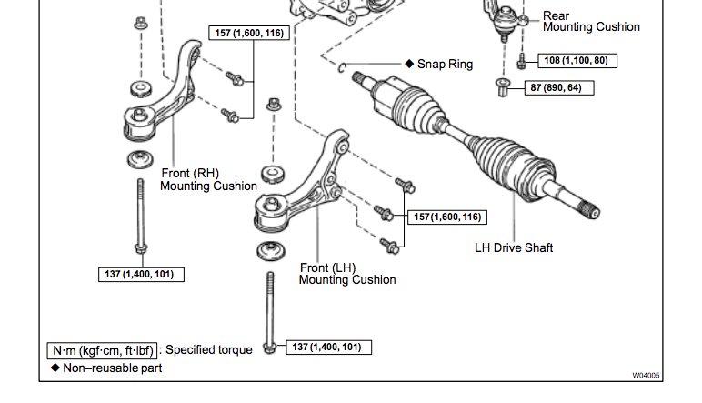

    The farthest right number (116) is the torque amount in ft lbs. right?
    @Speedytech7

    Post the rest of that page so I can look it up, I can't remember but that doesn't sound unreasonable

    Well I need to learn to look at the whole damn page before I start asking questions... :rofl:
    It's n-m (kgf-cm, ft-lbf) according to the little diagram on the bottom.

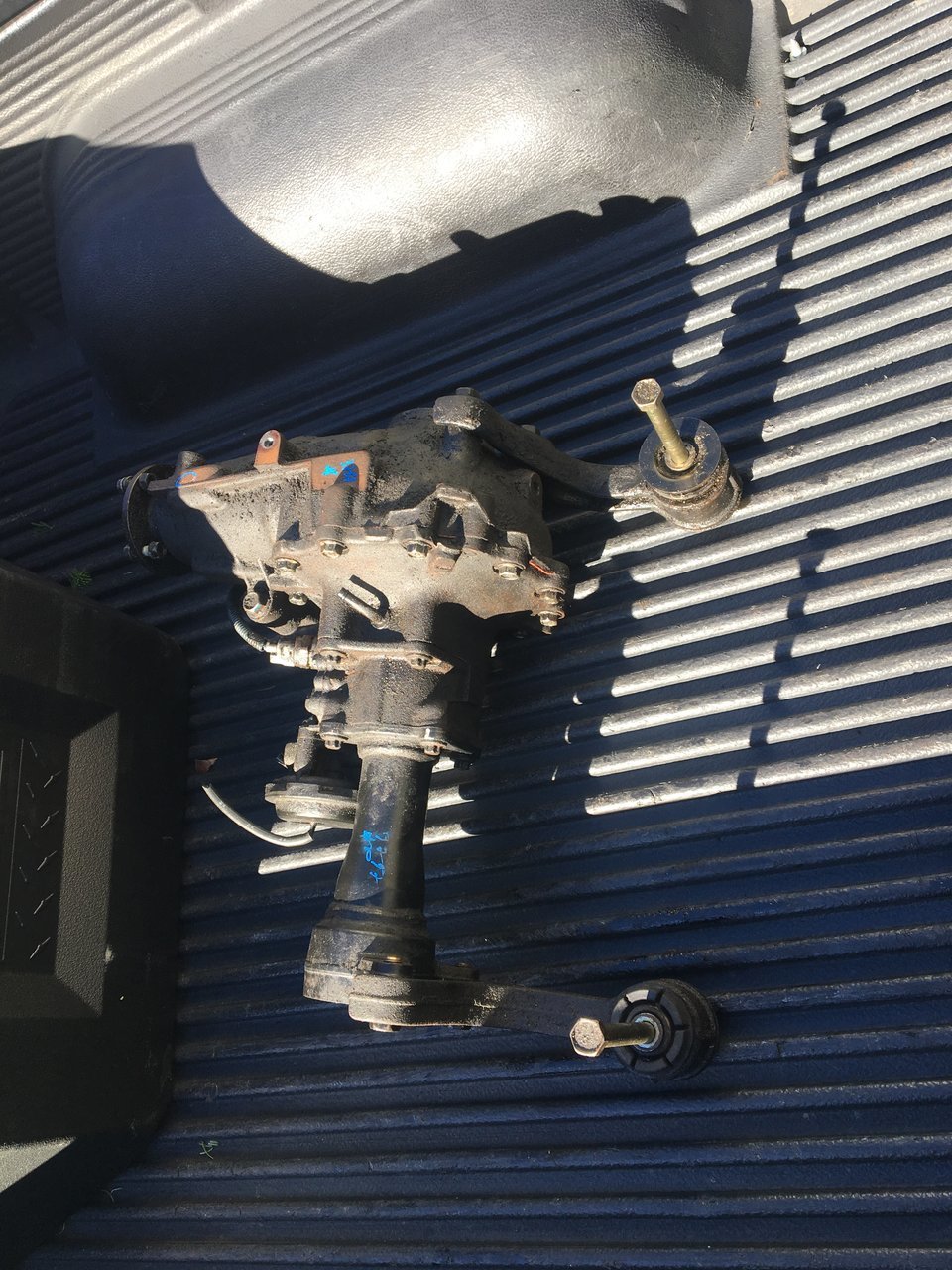

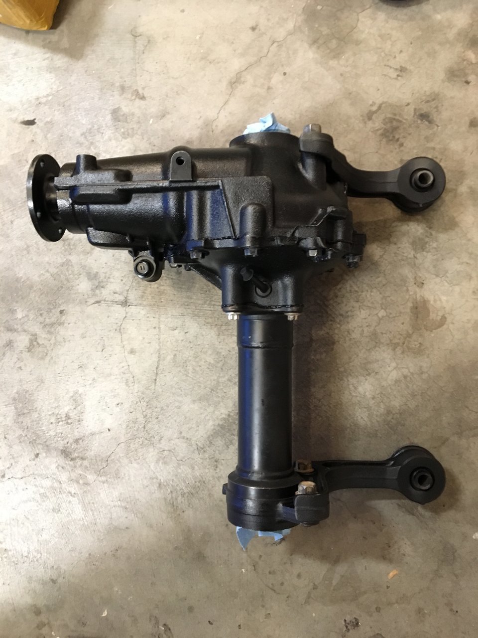

    Front differential is all done and rebuilt.
    Replaced both Axle seals, removed the ADD tube and replaced it with a manual hub Axle tube, sandblasted, primed, and painted the whole clamshell. POR15 is pretty good stuff.
    What a difference from the greasy rusty mess-of-a differential I pulled from the 1996 4Runner.
    Before/After
    Putting your axle tube to good use @Shubin

    Purty.
