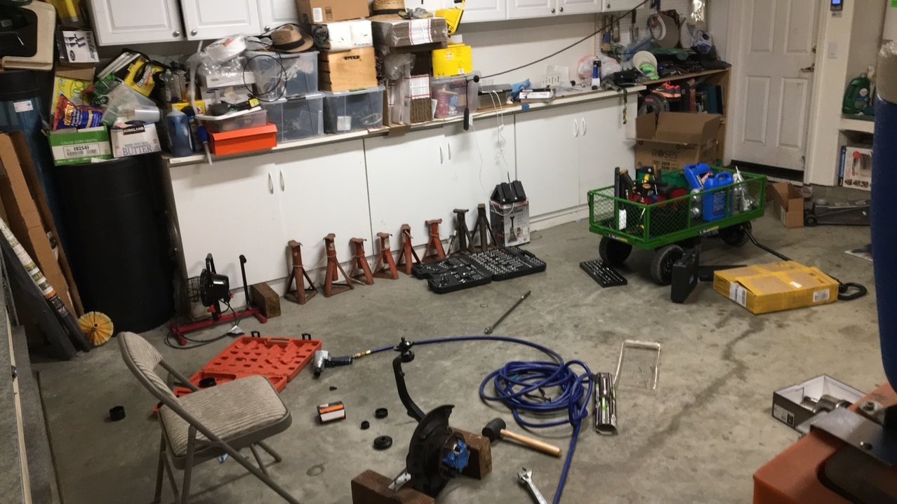

    Flux Capacitor
    One step forward two steps back, it seems.
    Well off to Wal-Mart. I missed my window for Home Depot. And harbor freight.
    It's going to be a long night...

    Yea I had the spindle attached still when I did it. . Are you putting wd-40 on the tread of the ball join puller?

    Yup. Tons.

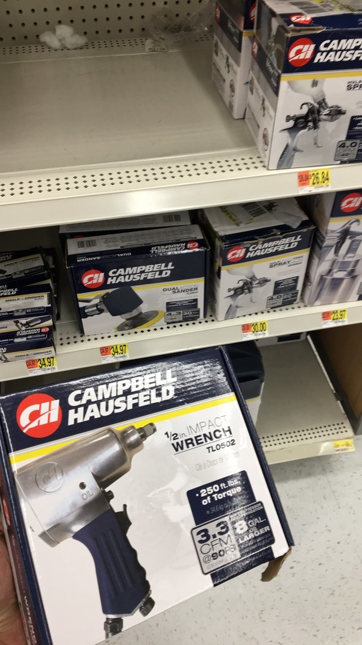

    UPDATE LIVE FROM WAL-MART:
    My god it's a madhouse why did I come here - there's like 20 people ahead of me in line. Last minute Christmas shopping eh? I'll be damned if I'm not going to get those ball joints in tonight.

    Well the impact gun doesn't do anything. Wow. Didn't even move the shaft a little. I need a stronger impact gun... @Speedytech7

    Yeah 250ft lb is kinda weak, the HF Earthquale is pretty strong, maybe not long for this world but you'll get a few uses out of it. Or you can cheat and ratchet strap the spindle and the stand you made around one of your tires on the truck so it cant move and then torque the shit out of it by hand. It's a strength game now, remember what I said.... Chuck Fuckin' Norris
    I'm running out of ghetto ideas without seeing your workspace haha
