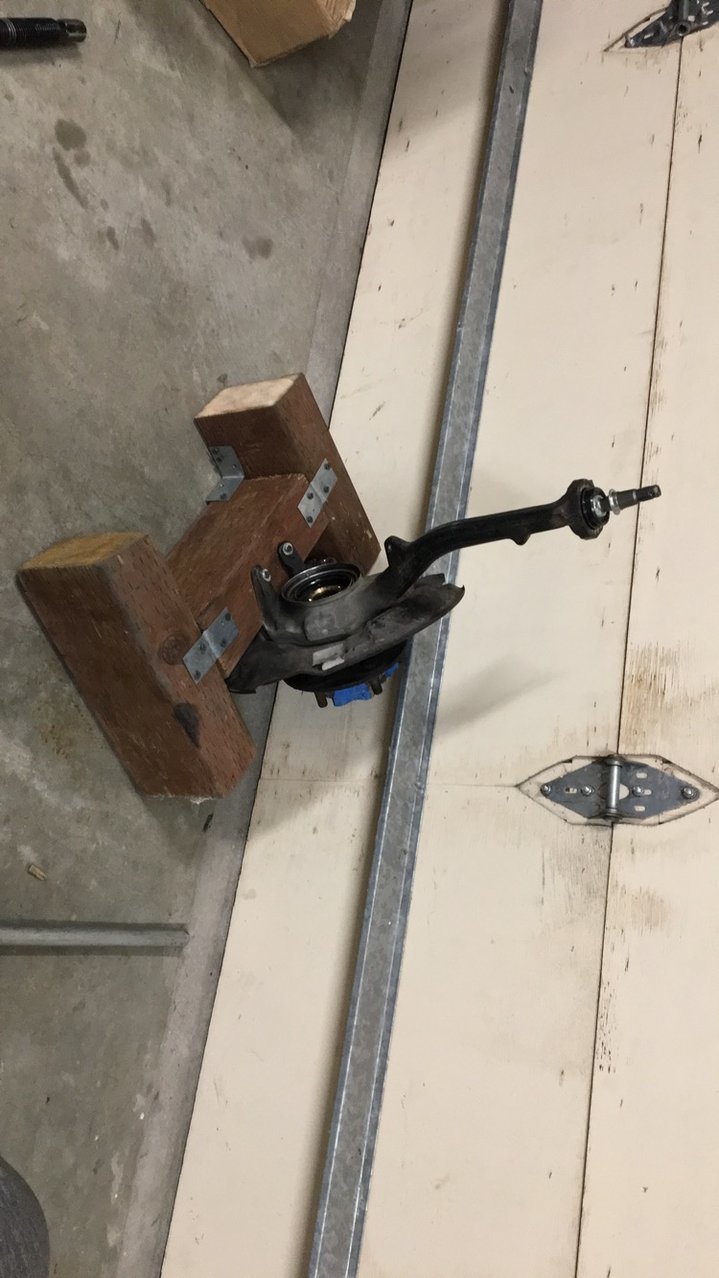

    I hate to admit it but I do not own a vice, lol. I should really pick one up.
    My grand solution to the leverage issue was to make an 'H' stand, screw the LBA mounts to it, butt one side on the wall, and use my foot on the opposite side to create leverage.
    It worked. Not very efficiently, but it worked.

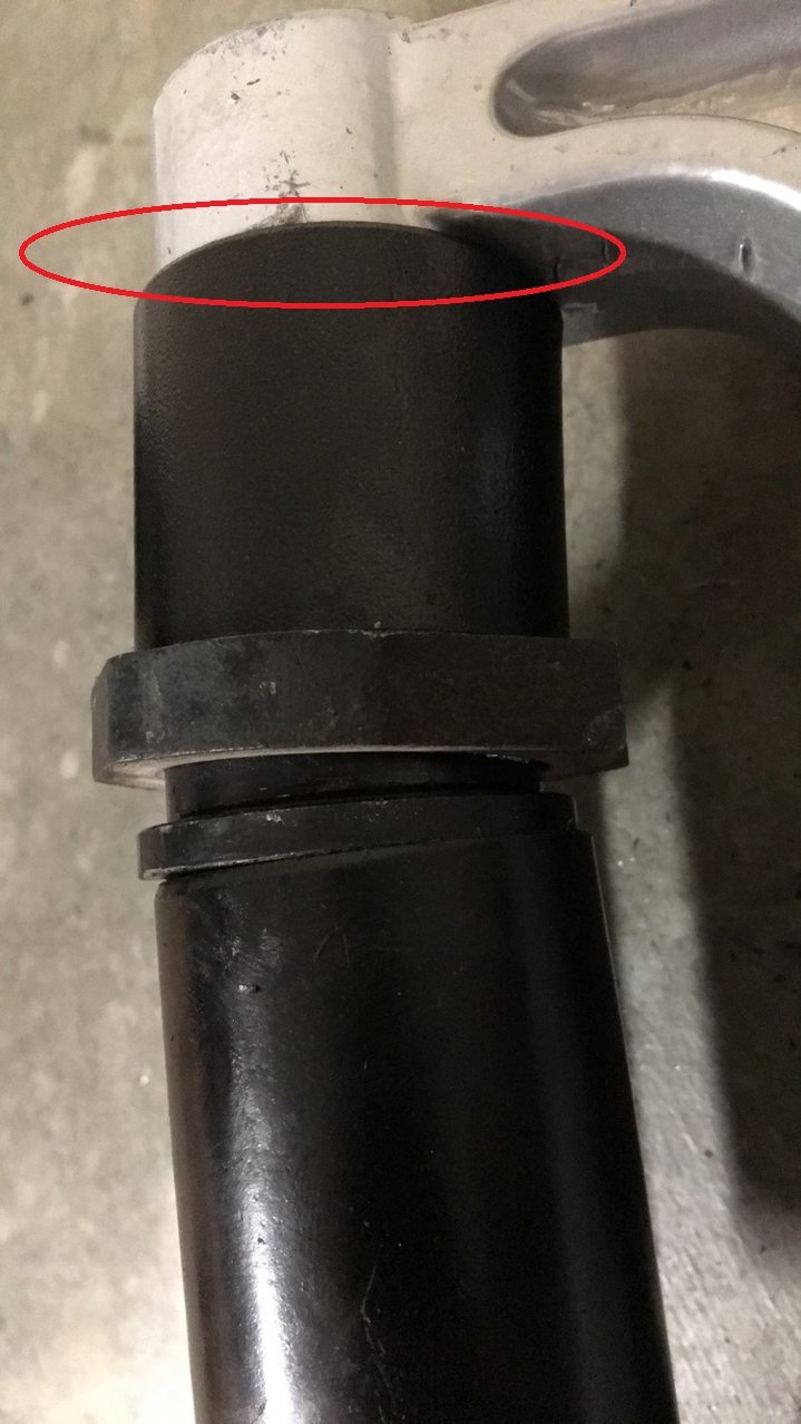

    Also this is wrong. one of those stepped washers should be in there to keep that sleeve straight.

    You're right, I ended up switching up the attachments and got the correct fitting with the divot for the press sleeve.
