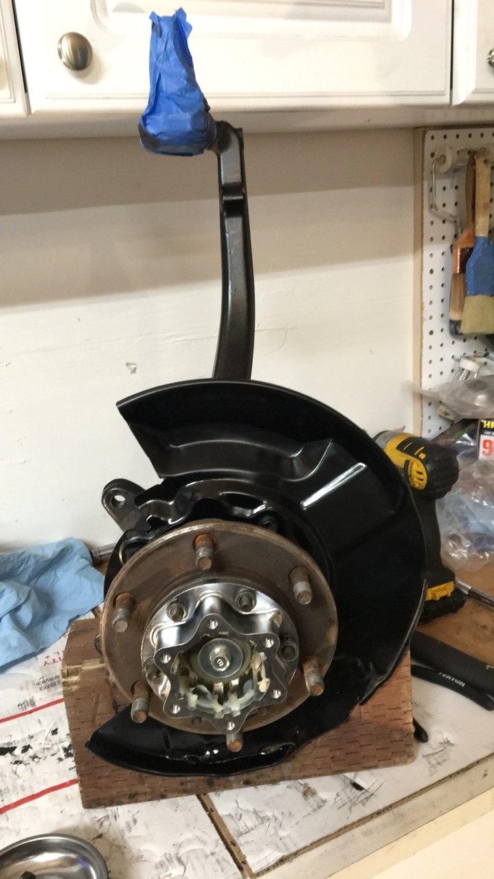

    It's Steering Knuckle rebuilding night. The paint on these turned out really nice.

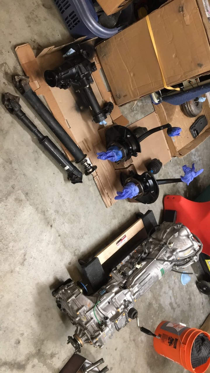

    There's just about everything I need for the 4WD swap. This is going to be fun.

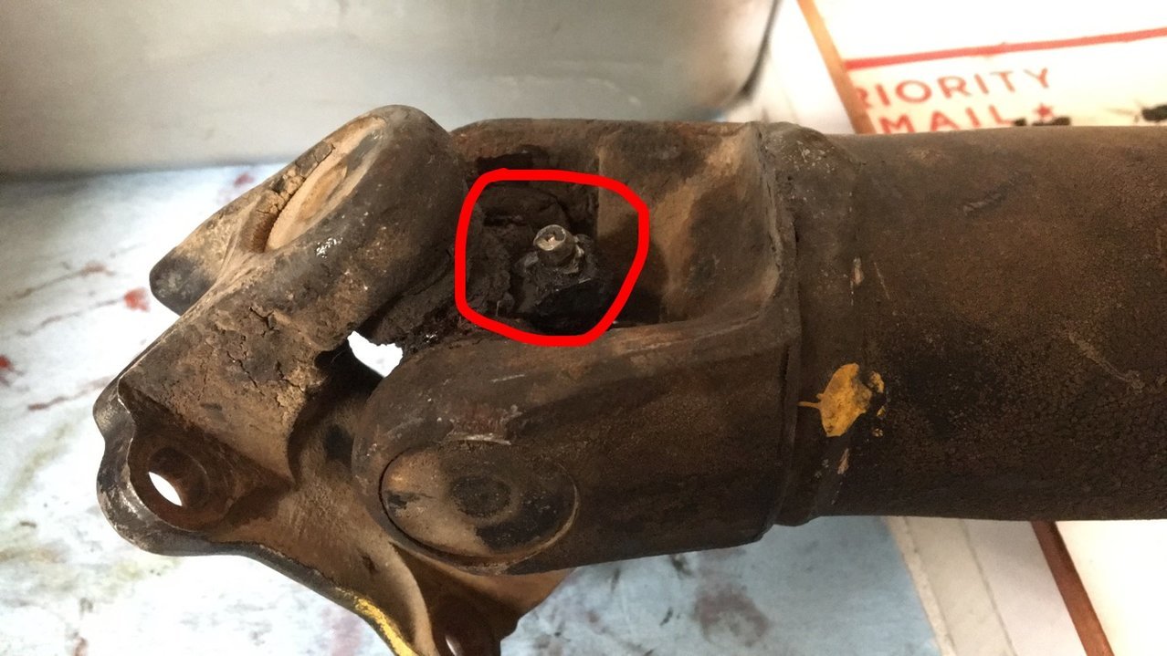

    Is this a Zerk fitting on the rear driveshaft?
