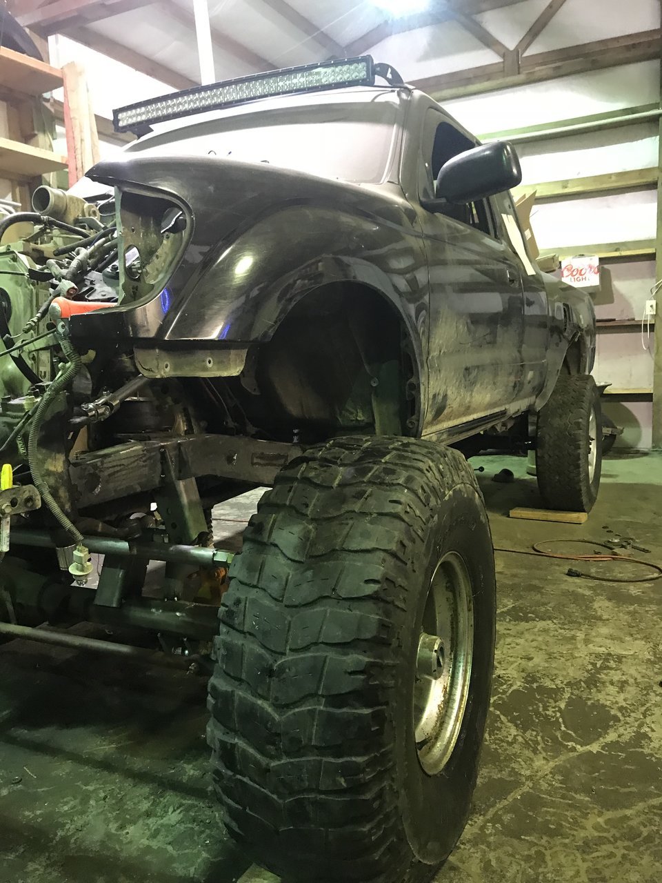

    What did I do to my 1st gen today. Let’s see.
    Got it on the Ground finally after about a year!!!!! :bananadance::goingcrazy:
    Sorry super excited since this is taking forever to accomplish. And I have to make every little piece of everything!! :frusty:
