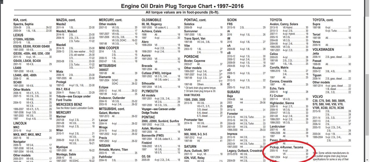

    C'mon Toyota would it kill you to put down the damn TORQUE SPEC!?

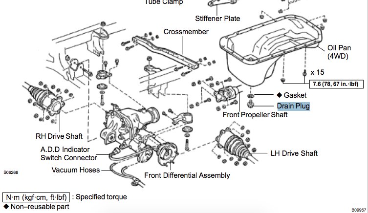

    Is the hole where the drain bolt goes supposed to be flush with the oil pan? There's a raised lip around the hole that looks like a gasket but I can't tell if it's a gasket or part of the oil pan

    Pics?
    Edit: I reread it cause I'm an idiot. I'd assume it's a gasket unless it's metal.

    I figured it out... it was a REALLY old gasket. Whoever changed the oil before I got this truck never changed it. It was seized to the oil pan I had to pry it out.
    Last oil change I just assumed it was part of the oil pan because of how stuck it was.
    I also attached the PDF below if anyone wants it.

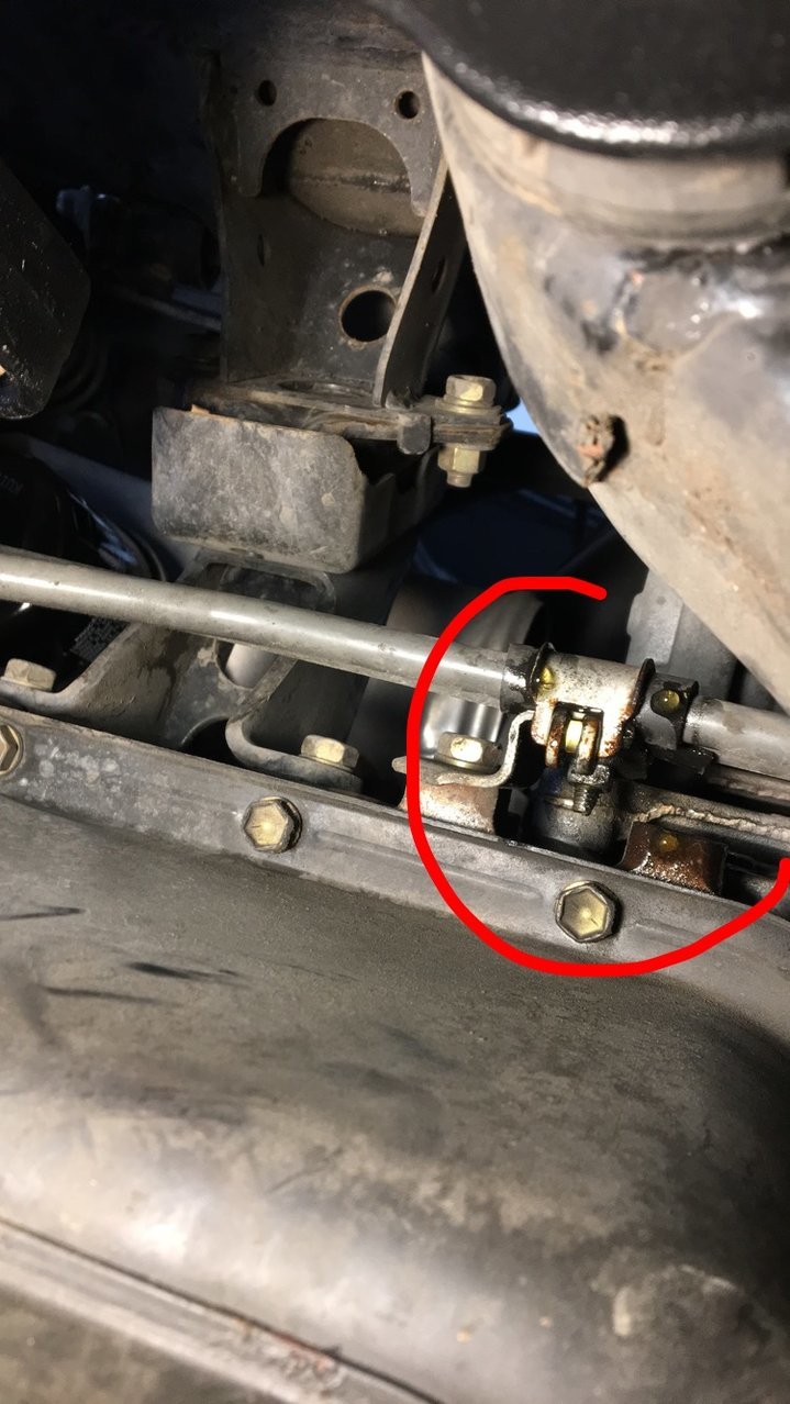

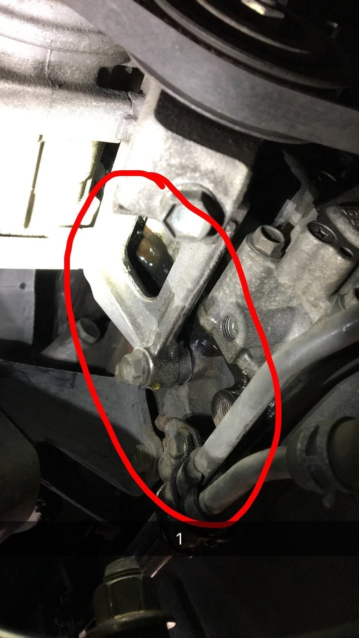

    Okay.. I go to jack up the control arm to do my knuckles and I see a huge puddle of oil after I did an oil change. It's not coming from the oil pan. Wtf is this? It looks like it's coming from one of the accessories on the engine.

    Did you spill any oil while filling it?
