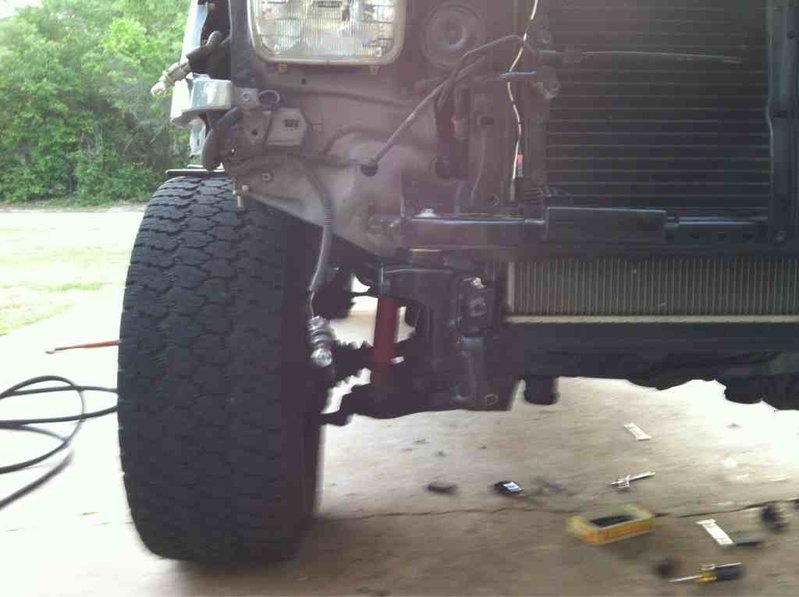

    its most likely ur lower ball joints.they r under the most stress and a r e prone to wearing. i will have my spare set with me out there... uppers rarely go, but heb they do ur right its bad.... i still havent touched my uppers. i check them often for play, they rfine....

    uppers shouldn't move much at all.... lowers have a spec.... lift the truck up by the frame. stick a pry bar between the lca and lbj. pry up or down and see if there's alot of give in the ball joint. it should be obvious if ones bad.... uppers are hard kind do the same thing and see if there's play in the joint itself. i think we get about 2 hours to do lowers plus alignment. uppers are trickier cuz they are pressed into the spindle. I'd guess 2 hours a side for uppers? plus alignment

    it shouldnt man. i highly doubt uhave a bad ubj. if u do in fact have bad lowers, they arent too bad to replace. if udont replace them i have spares:D

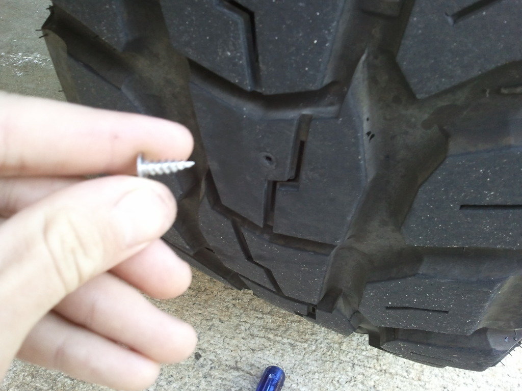

    Its a Toyota what more is there to say.....
    TRD S/C 3" sky jacker suspension lift,33" kumho road venture mt kl71's 16" 320c pacer wheels,billet grill,EBC slotted and dimpled rotors,super 44 muffler with gutted cat,smoked l.e.d. tail lights, deck plate mod with K&N filter,fog/blinker mod,cobra cb with 4' firestick antenna/100W PA,clear corners with l.e.d bulbs,55w back up lights,urd O2 sim., blue l.e.d bulbs behind gauge cluster.
    found this in my tire today when i went to wash it. glad my tires are thick!

    and that it wasn't a 3 inch nail
