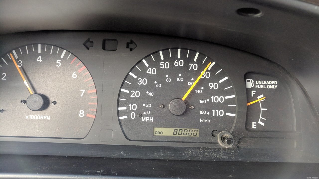

    Rolled over 80K yesterday on our way home. Just getting broken in.

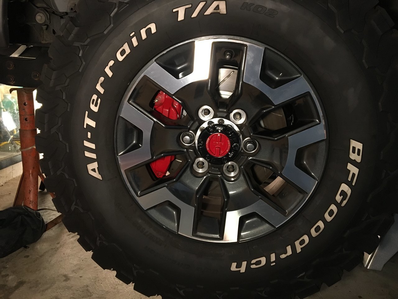

    Front end is all done. Transmission is going in now and I'll be finally 4WD. I'm so happy I got those manual hubs powder coated to match my Calipers.

    Damn that turned out nice.
    Bet it's weird seeing Turd Gen wheels and Manual Hubs.

    That looks awesome.

    Thanks! It's a huge difference from the corroded gray metal and faded black the hubs used to be. Well worth the money I paid to have it refinished.
    I live in suburban California I have no idea why I even made this truck 4WD, lol.

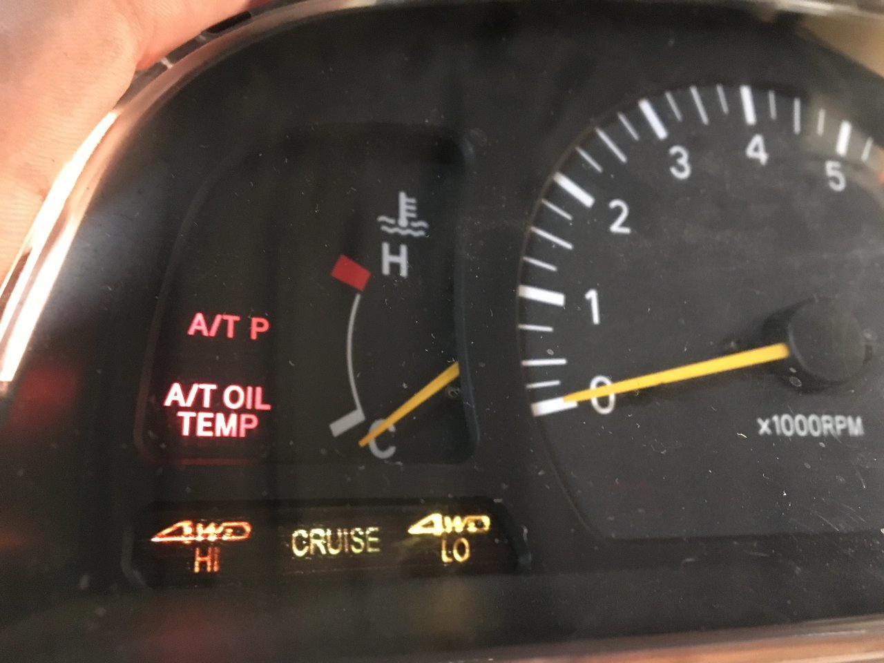

    Don't have the willpower to put that transmission in today. Instead I'm trying to get my custom instrument Cluster lights working that utilize the transfer case position sensors.
    Looks a little sloppy because I have an ink jet printer. Would've looked way cleaner on a laser jet.

    i like the idea... wonder what i could use my unused lights for... maybe a light for the methanol injection... hmmm ideas ideas..
    how do you plan on wiring this up? is the cluster pinned for it?

    Not pinned for it. I have cluster pigtails I'm using. The copper traces are on the flexible circuit board though so all you really have to do is hook it all up at the connector. The dash has a common 12v rail so you'd have to switch the ground.
