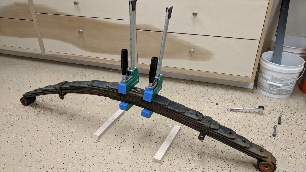

    I always thought the longer then stock shackles move the axle to the back. But never cared enough to do al the math on it. Was the new leaf from alcan cost effective?

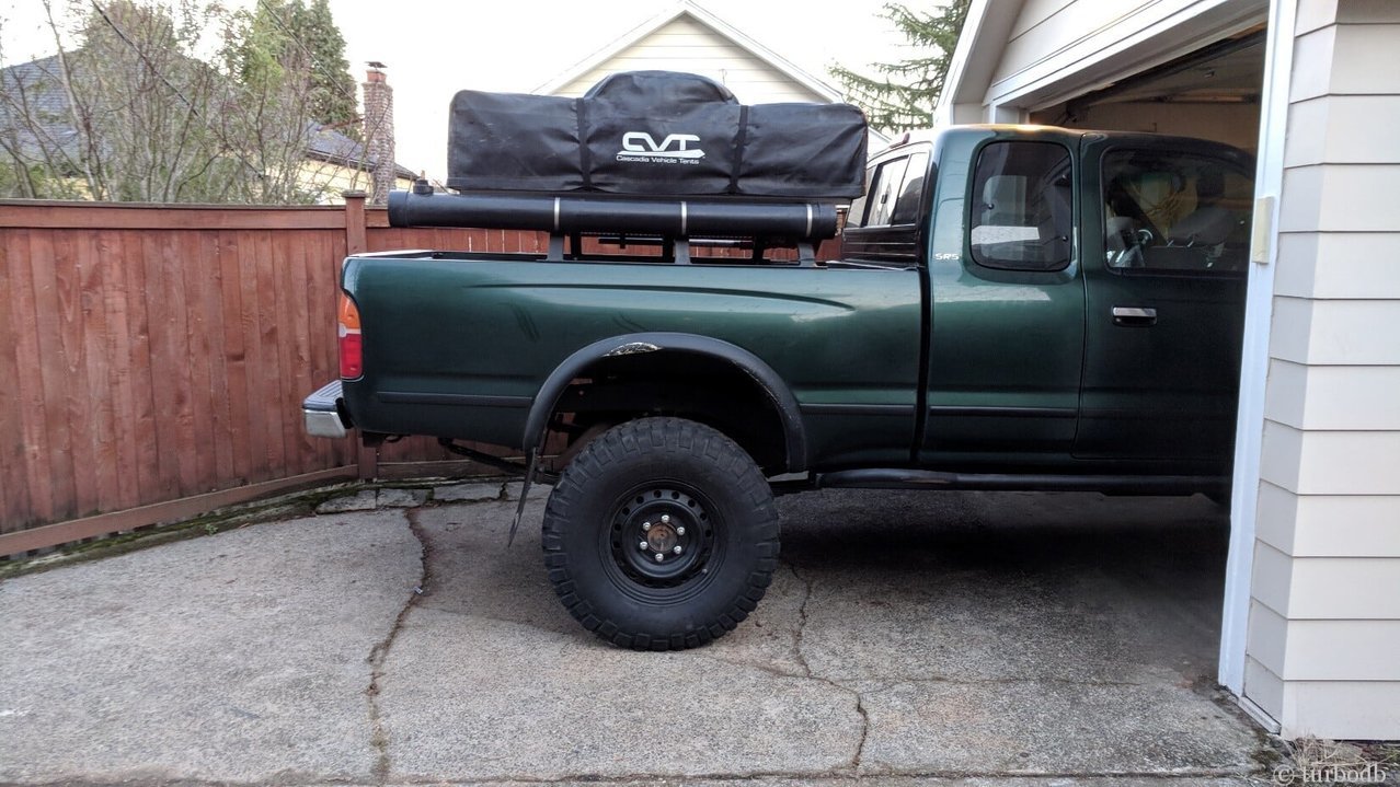

    hahaha, I noticed that too in the pics! I think I've got like ~6-7 inches.
    Yes, probably. For which part(s)?
    Thanks. I can't wait to get the Stealth6's installed, but the steelies look good too! And yep, axle is much better!
    Thanks - it's fun writing this stuff, and fun to share. Define cost effective, hahahaha! For the quality, I think so, but they aren't cheap. I think I'm into the packs about $800 or so at this point.

    Total cost? Still sounds cheaper then a new pack, plus the benifit of tweaking how the ride is.
    Did your pinion angle improve as well then.

    Yeah, $800 total cost for the packs, including the center pin adjusted forward (which if you were just ordering packs new, you'd do when you order the pack).
    My pinion angle didn't improve as part of moving the axle forward - in fact, I think it probably got slightly worse, because the lift is the same, but now the axle is closer (so the angle has to be greater...if only slightly).
    I've got a BOSS 3" up front as well - I'm happy with it, though I know it's not the best - nice price/perf compromise though. I'll PM you the details for Alcan - it's less about part numbers with them, and more about what you ask for, since all the packs they build are custom.
