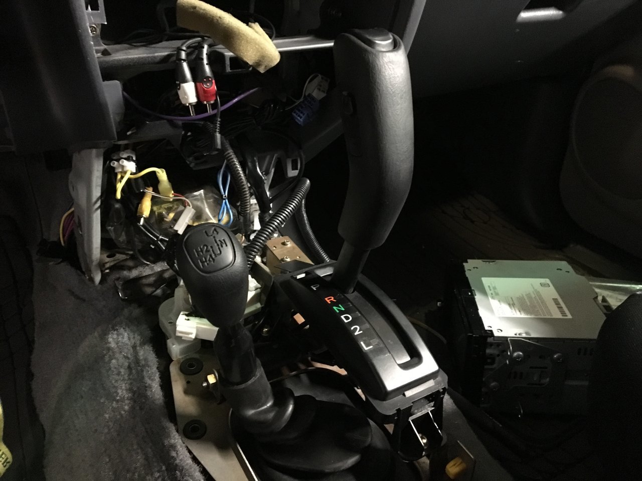

    It's been an eventful week - I finally got the entire drivetrain in today. I got to installing the rear driveshaft and found out it was the wrong one when trying to mount the flange to the transfer case.
    Waiting on a replacement, here's a teaser photo. I'm running the black 4Runner shifter.

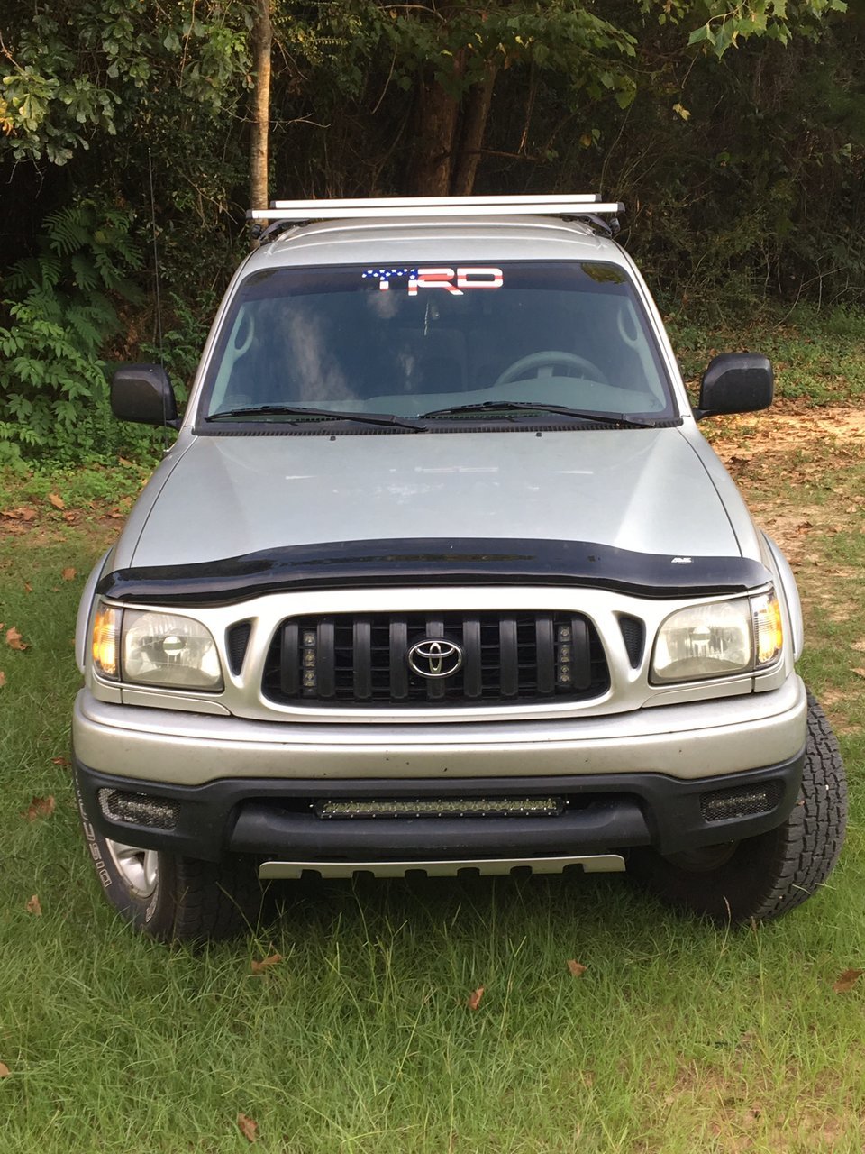

    I installed the lights behind the grille and took the roof rack off.

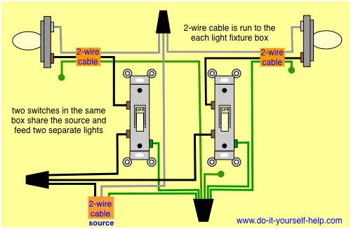

    Can someone point me in the direction of wiring two switches to two lights?
    Wanting to put two lights facing backwards on the back of my roof rack tracks. Want a switch in the camper shell as well as one in the cab so I can turn on or off from either compartment. Is it something like this? Seems like a lot of wires though (but I'm an electrical n00b)

    another option is just ground switching the lights. The down side to this is that whatever switch turns the light on, must also be off to turn the light off.

    That is actually the way I want to go. If I turn the switch on in the cab I would want to just turn it off in the cab as well.
    So that means, the switches do not need to be connected? Have two sets of wires coming from the lights - one set to one switch and one set to the other?

    no with ground switching if you turn it on in the cab, you have to turn it off from the cab.
    basically the idea is you run power to the light at all times. Then you just need ground to it. You can add as many switches to the ground wire as you want. But once it sees ground it lights up and the only way to kill ground is from the same place you gave it.
    If you want a true double switch setup. You'll need a STDP switches
    Check this: http://forum.expeditionportal.com/threads/132839-How-to-wire-two-switches-for-one-light

    Ah hah that is exactly what I wanted! Thank you!
