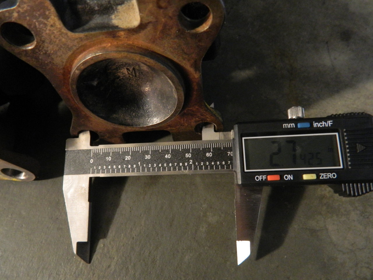

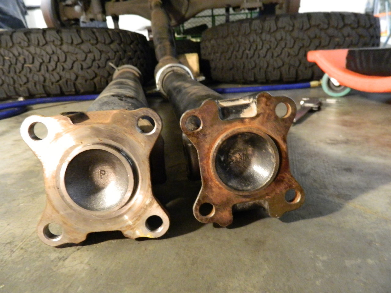

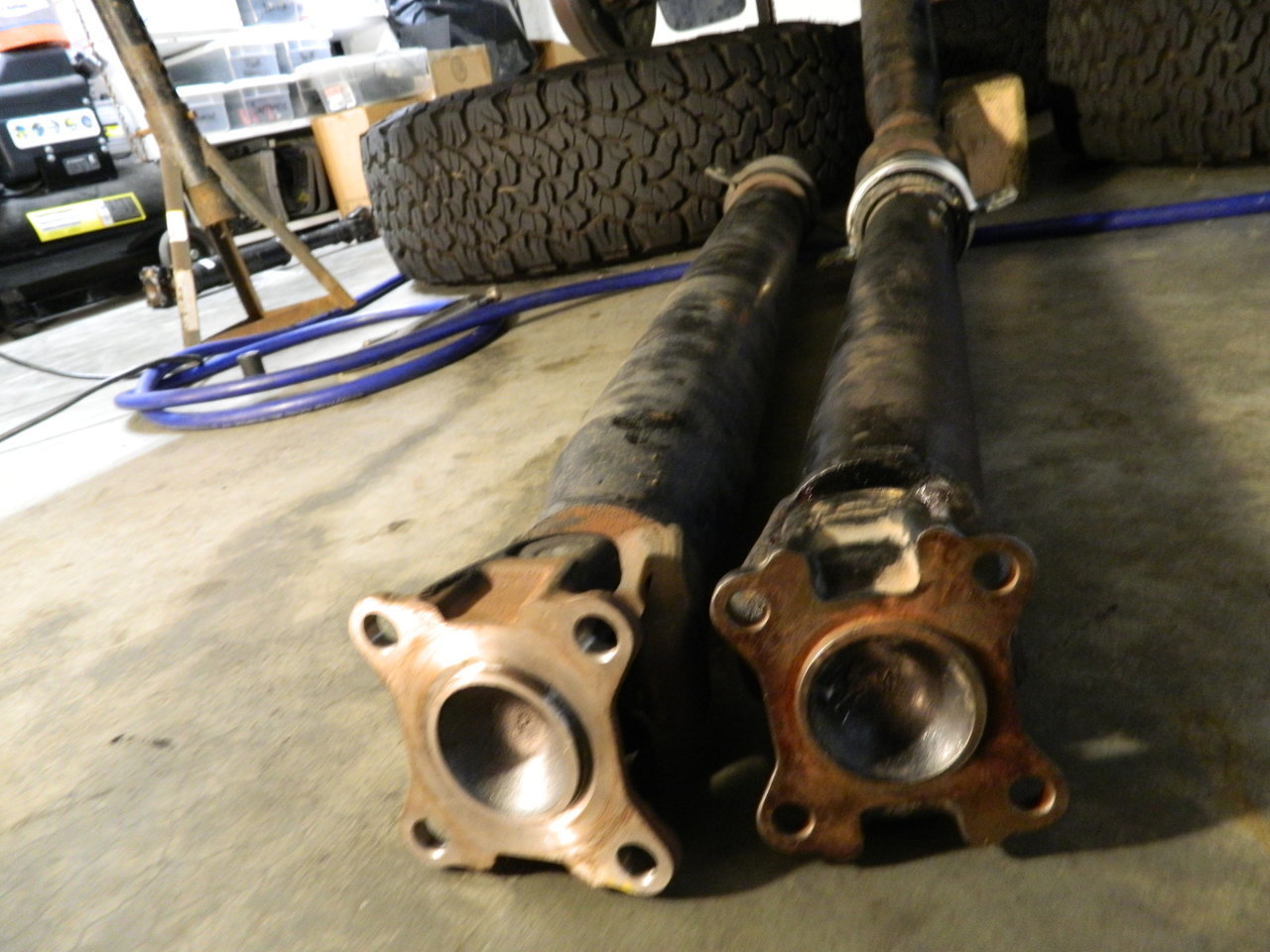

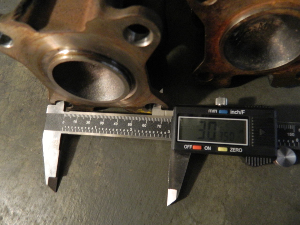

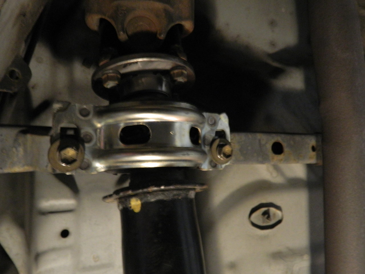

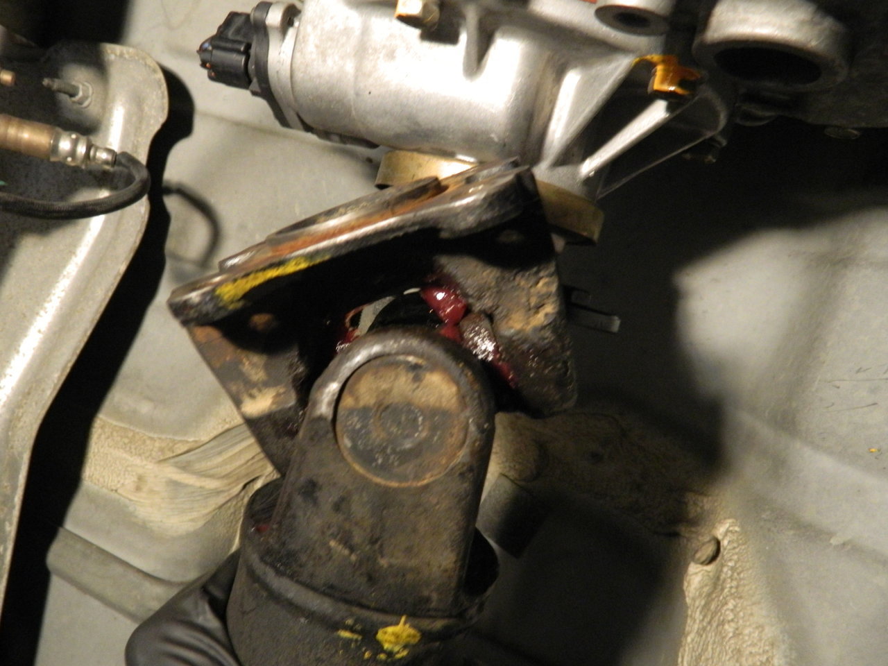

    The front portion of the rear driveshaft was a.) too long by about 3/4 of an inch b.) the flange was completely incorrect with the wrong hole spacing
    Let me find some pictures. I never realized they had different sized flanges over different years.

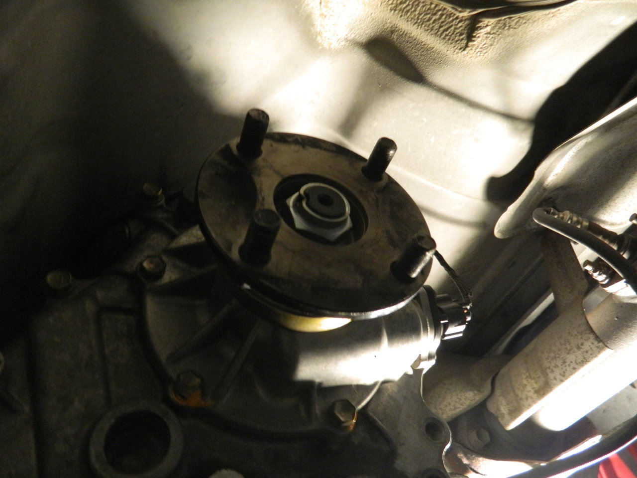

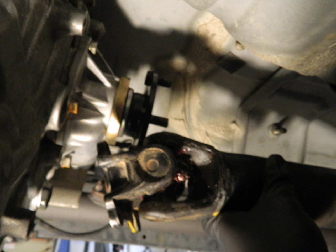

    The original PreRunner D/S is on the left, while the 4WD one I bought is on the right. As you can see the hole spacing is completely different (the flange isn't even the same just by looking at it), and the length is off by about 3/4 to an inch.
    I tried the PreRunner D/S on the transfer case and it fit fine.

    Could it be that Frank is a 5 speed? I know the transfer cases are different between I4 and v6 (top shift vs. forward shift) maybe the transmission mattered too.

    Frank is a 5 spd with a J shift Tcase.
    Two kinds of Tcases too, the electric shift and J.
