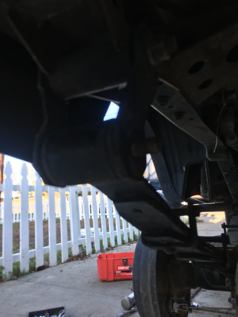

    Thread the nut back on the end of that bolt (so you don't bash the threads on the end), and then hit the nut/thread end with a hammer to punch it out. You may have to hit harder than you think you should. There are ribs on the head side of that bolt that hold it in place, and they are tight.

    Do you know the torque specs of the rear suspension?

    Front eye is 116 ft-lbs, rear eye in the shackle is 67 ft-lbs. Top of the shackle is also 67 ft-lbs.

    Leaf spring-to-front hanger nuts 116
    Shackle-to-frame nuts 67
    Shackle-to-spring nuts 67
    U-bolt nuts 90

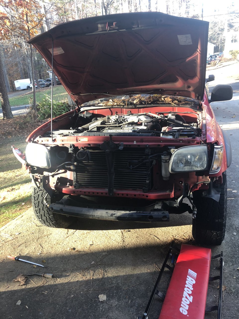

    well, dropped the truck off at the shop, time for a new bumper and grille :)
