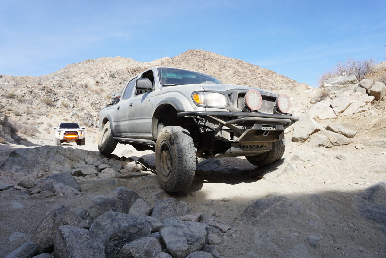

    Wheeled it.

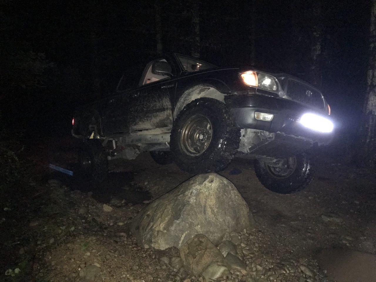

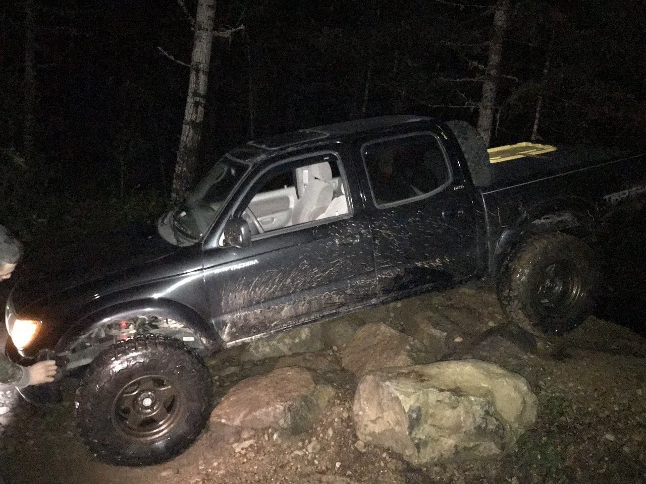

    3” lift. Sway a ways 2.5 on 285 75 16 and much more
    Wheeling in Tahuya WA CFCBE99A-0B27-4D33-AE0E-F669C6AE9863.jpgB94CFD04-5A86-494B-AB1D-5E8002EC9796.jpg

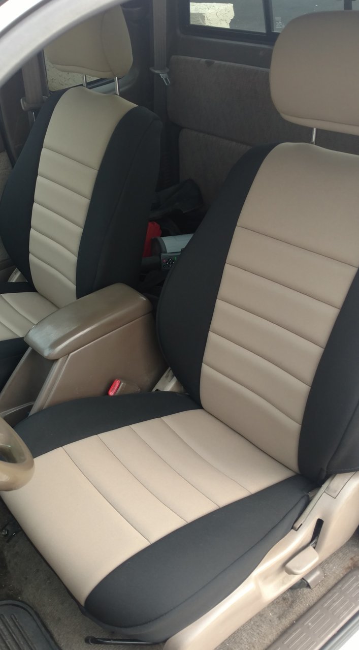

    Man those are sharp. Those just got added to the "list".

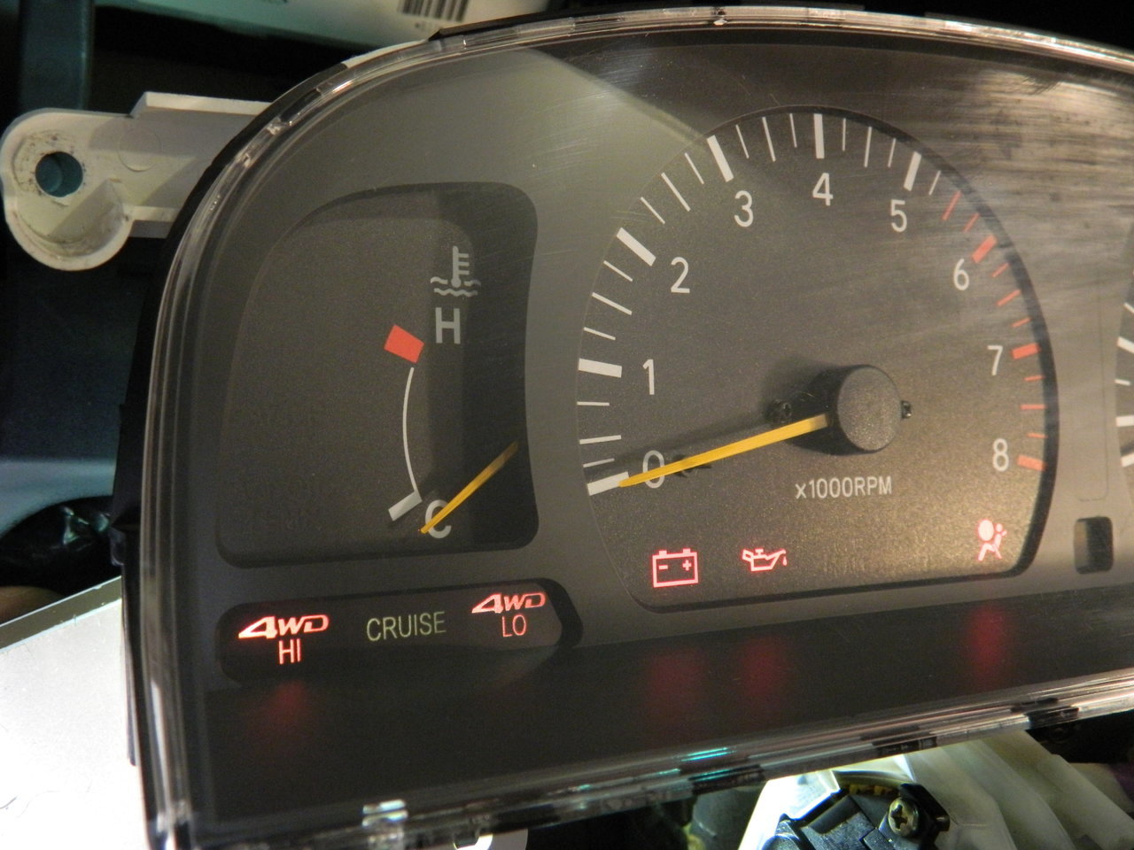

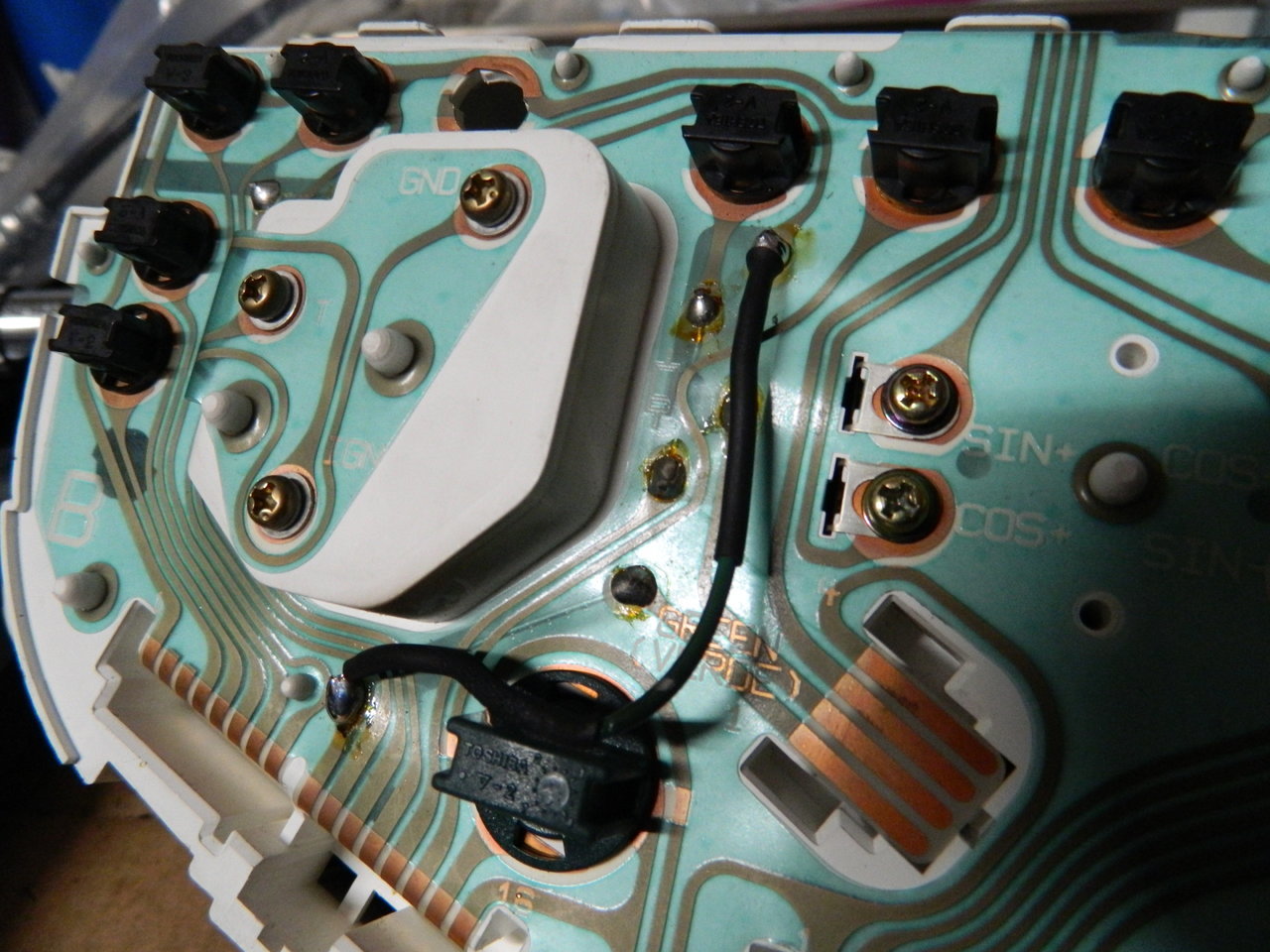

    Almost got my cool 4WD dashlights working. Unfortunately the way the transfer case position sensors work is that when it reaches a certain mode (like 4LO) it will keep all the previous sensors activated thus making my indicator lights inaccurate. If I'm in 4HI - the 4LO and N indicator lights would be on so somehow I have to figure out some kind of logic with relays and diodes or something to prevent this. The ABS light blank I'm using for 4LO utilized some kind of internal circuitry in the flexible circuit board of the instrument cluster, so I bypassed it by soldering a wire from the connector solder joint and the other end to the bulb end of the solder joint effectively bypassing the ABS circuitry.

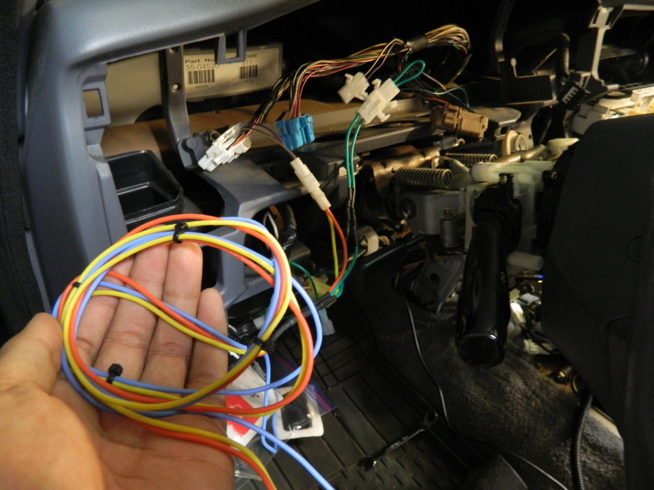

    My spaghetti of a 4WD position sensor wiring harness, I kept it nice and tidy with Molex connectors. I can plug the original A/T P and A/T Temp indicator wires I cut to use for the 4WD lights if I ever need to make it stock again. My cluster never came with A/T bulbs from the factory so I presume the A/T system was never hooked up on this truck. I tried to make the original stock 4WD indicator next to the CEL light turn on with 4HI/LO, but I got my logic wrong with the wiring and used unneccesary diodes so it doesn't work as of yet. Interesting because I have a PreRunner and that 4WD light was wired and hooked up, just no bulb socket.
    Yeah most of you guys would say "Just look at the 4WD knob to tell what position you're in!" To that I say I just like being extra - thought it would be pretty damn cool to have the cluster tell you what mode of 4WD you're in. Also a unique feature of this truck as I don't think any 1st gens in the world have this feature. I mean I don't have a RR DIFF LOCK or ABS so might as well make good use of the sockets.

    Those look nice! Hard to find good seat covers that fit and look that good.
