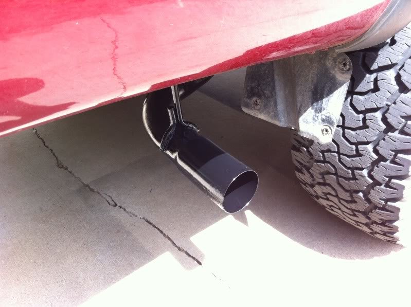

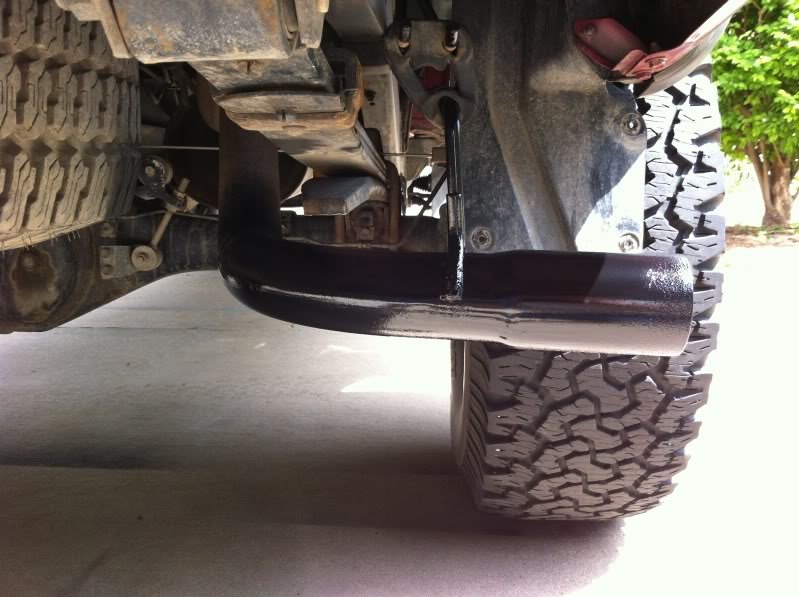

    Soemthing I need to do....Rustoleum High Heat I presume? Looks good!

    Yeah, the grill paint. Rated to 1200 degrees F

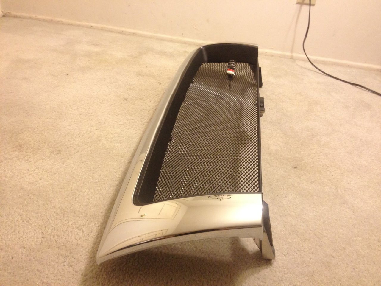

    Wow man... nice work.
    Looks awesome.
    May I suggest to the proud owner of that to paint the grille surround black and that thing would look sick!

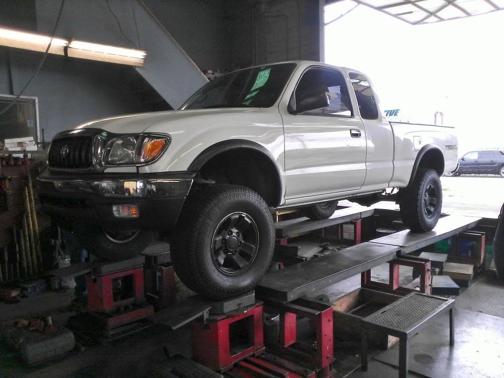

    just got a lift put on :taco:, now I just need tires:cool:

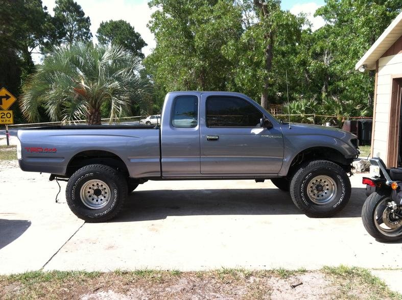

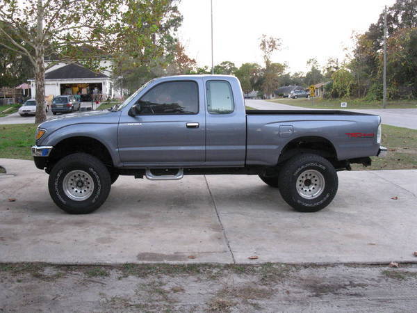

    You guys see any frame around here???
    :spy: :spy:
    Body and frame done.
    Progress was kinda slow this morning and afternoon...condidering I slept till 1pm...
    I had a lot of sleep to catch up on :)
    Hopefully I will be all done tomorrow morning...:cool:

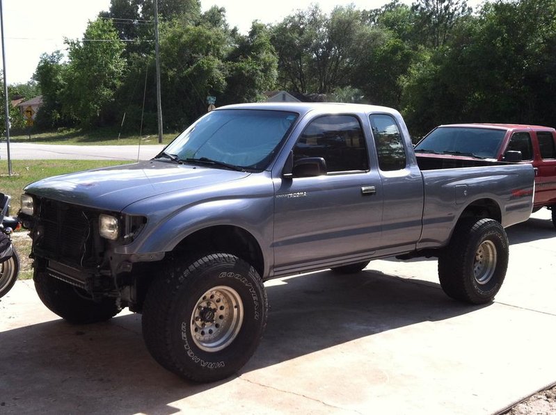

    lol...no...sorry..but I did paint it a while back.
    No body lift=no frame showing.
    before:
    after:

    Oh yeah... knew you took the BL off. Was just thrown off by the "body and frame done" - thought you did something more.
    Looks great - love your truck as you know

    Nice! Now do a 01-04 grille ;)

    Nice. Mine is getting rusty and I don't want to do a chrome tip - this is a good idea.

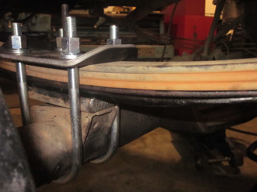

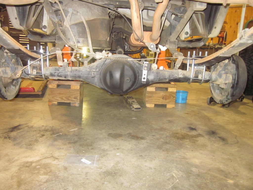

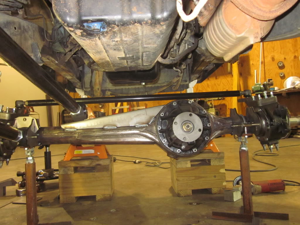

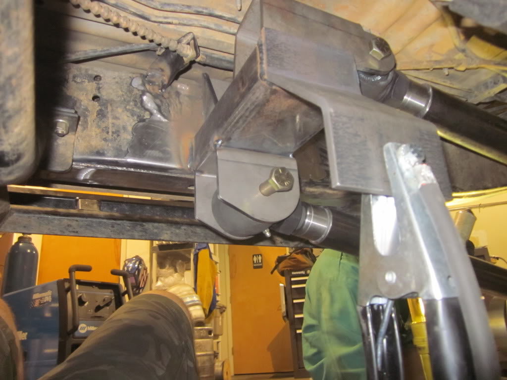

    I got my U-bolt flip kit and BPV installed. I was also able to "rebuild" my leafs. All I did was put a fresh AAL in the pack and I took a leaf out of a 3in lift pack and cut it to length and so now I have a extra middle leaf and took the over load spring and torched the ends off. Now it's just a lift block that wont hang up on things. I'm going to have to run a shackle, not just to see how big :rolleyes:
    And some other odds and ends

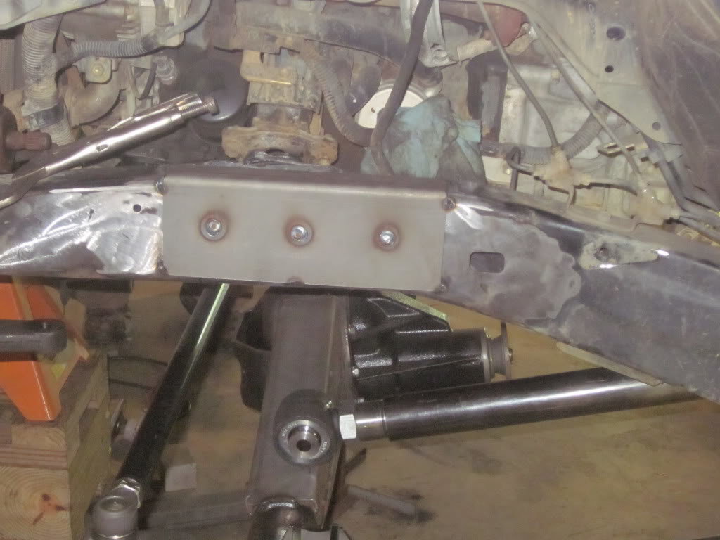

    Transfer case cross member/link mounts
