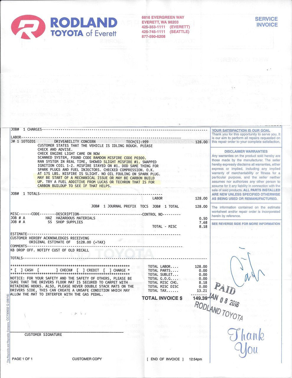

    I've known for a long time that there was something not quite right: on Friday I made an appointment with the Dealer to have the Diagnostic Service done to find out what was wrong - there had been no idiot light at that point. Friday night on the way home that light came on.
    I am not too happy with the result (or the price, but I knew the price going in). (Here I am assuming you can read from the photo - you asked for photos:); if not, the answer was, "you do have a problem, we don't know what it is, try a fuel additive".
    Do any of you have any thoughts re: the Lucas or Tehran products? I have driven it over the mountains and back, so a carbon deposit issue seems funny.

    what code was being thrown?

    It says P0100 "Random Misfire"
