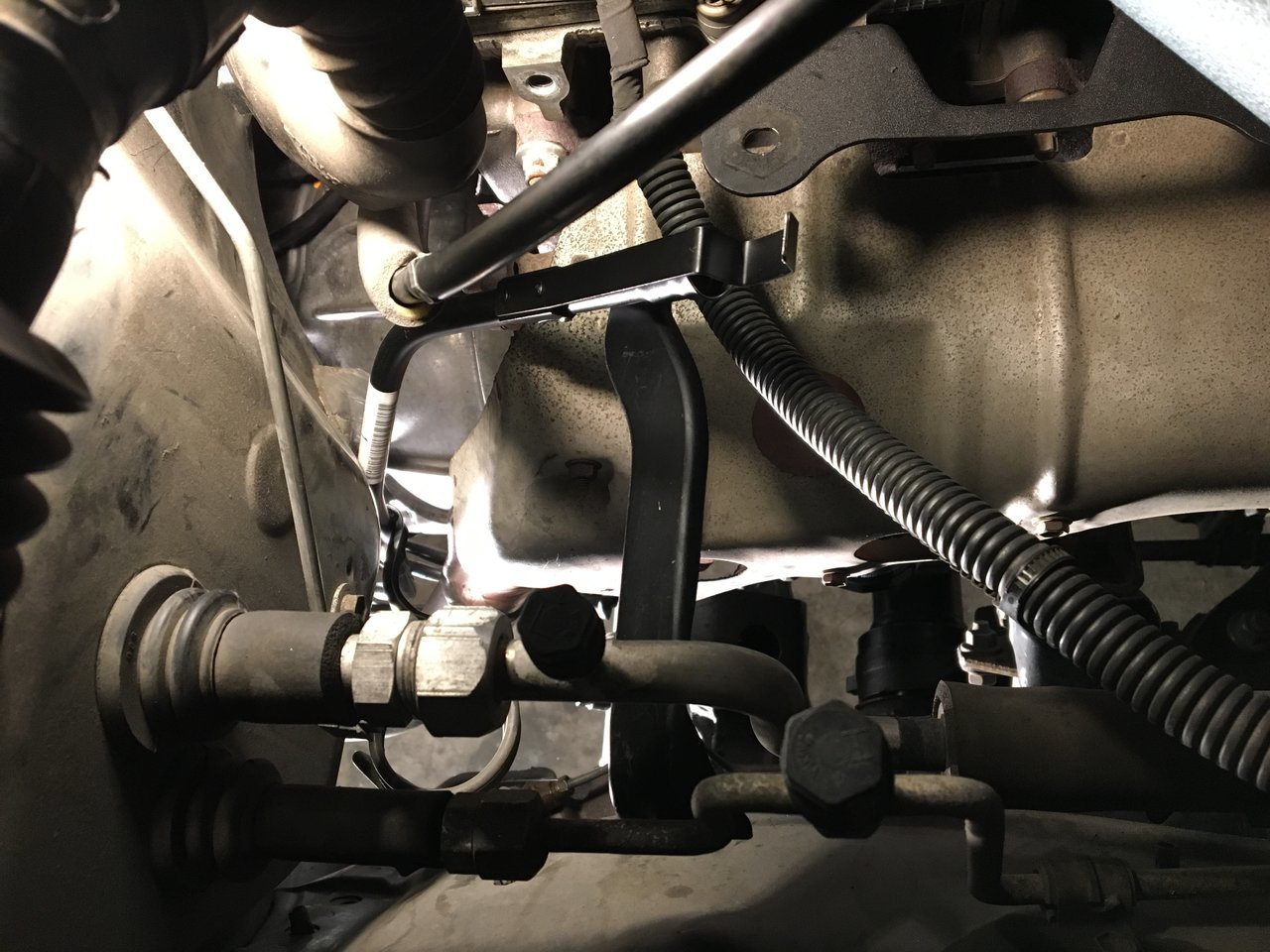

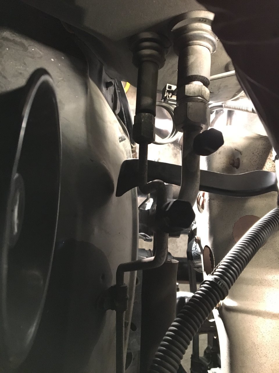

    Looks like the dip stick holder is upside down. That bracket off the dip stick holder is suppose to go toward the engine not the wheel well. You can see the bolt hole where it bolts to in the image you posted.

    Huh, so that's where it goes. I can't for the life of me manuver it to get to that position.

    Probably should get that sorted so it is measuring correctly

    Have you tried spinning the tube. I had to do that with mine. I also had to bend the tube a bit to line it up. I also had to get a dip stick for my tranny because it didn't come with one.

    Does it mount to the engine block?

    #junkyardparts
    yes

    No way it fits like that, maybe a picture would help but I would have to morph the hell out of it to make it mount there.
    Make a pic would help, haha

    I'll look for one.

    QUOTE="SilverGhost, post: 9766873, member: 112635"][​IMG][​IMG][​IMG][/QUOTE]
    It's a horrible pic but if you look closely you can see the dip stick holder how it's suppose to face. this was my 2.7 this is the only pic I have with this motor sorry. maybe google it.

    It's a horrible pic but if you look closely you can see the dip stick holder how it's suppose to face. this was my 2.7 this is the only pic I have with this motor sorry. maybe google it.[/QUOTE]
    Ah so it goes in between the back two header pipes?

    Ah so it goes in between the back two header pipes?[/QUOTE]
    I think it goes next to the header and fastens to a heat shield bolt, kinda hard to tell.
    Here's a better picture.
