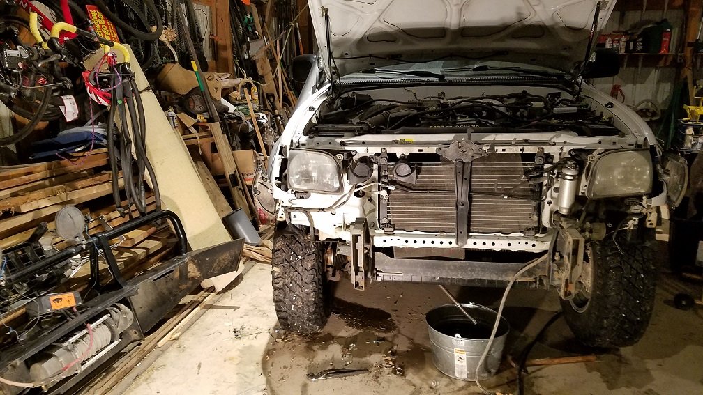

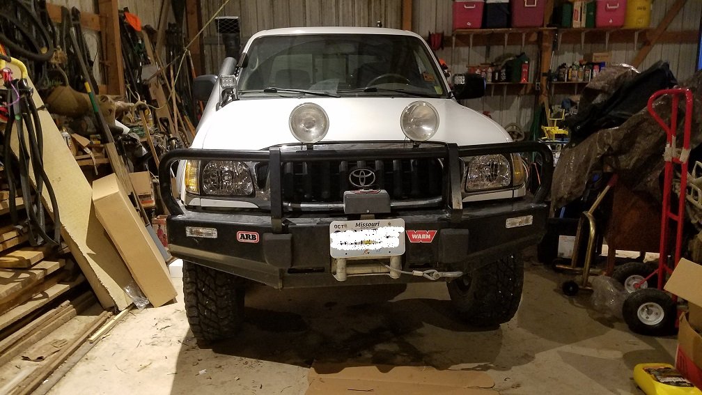

    I had to get my neighbor to help me remove the ARB, with winch and steel cable it was too heavy for one person to not get hurt trying it solo.
    I REALLY needed to get this done since it was 50*F last night and expected to fall to 25*F today and stay WELL below freezing for the next week or longer!

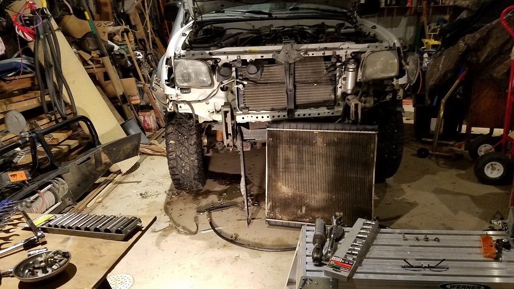

    I installed a new radiator, had some fitting problems in that the frame horn mounting brackets for my ARB decreased the frame width about 1/4". After unbolting the brackets and moving them outboard, the radiator slipped in between the frame rails!

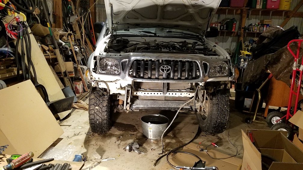

    New headlights and turn signals were installed too. However, I forgot to get pictures. This was the original radiator from 2001 and had gone 248K miles!

    Damn you got 16k miles past me with the radiator. And mines an 04!

    Doing this soon myself. Did you bother flushing the system before removal? I know most of the gunk would be in the radiator but I’ve read some people flush it anyway with the old radiator on to remove anything in the remainder of the system.

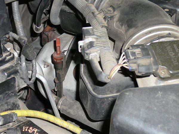

    Here's a better picture.[/QUOTE]
    Awesome! Thank you sir!

    @SwampYota - I did NOT flush the rest of the system.
    I did put in, new, 1 gallon of antifreeze and 1 gallon of distilled water - I need to take it for a drive to see if any additional fluid is necessary.
    looking at my pictures, I have WAAYY too much $hit in my barn!
