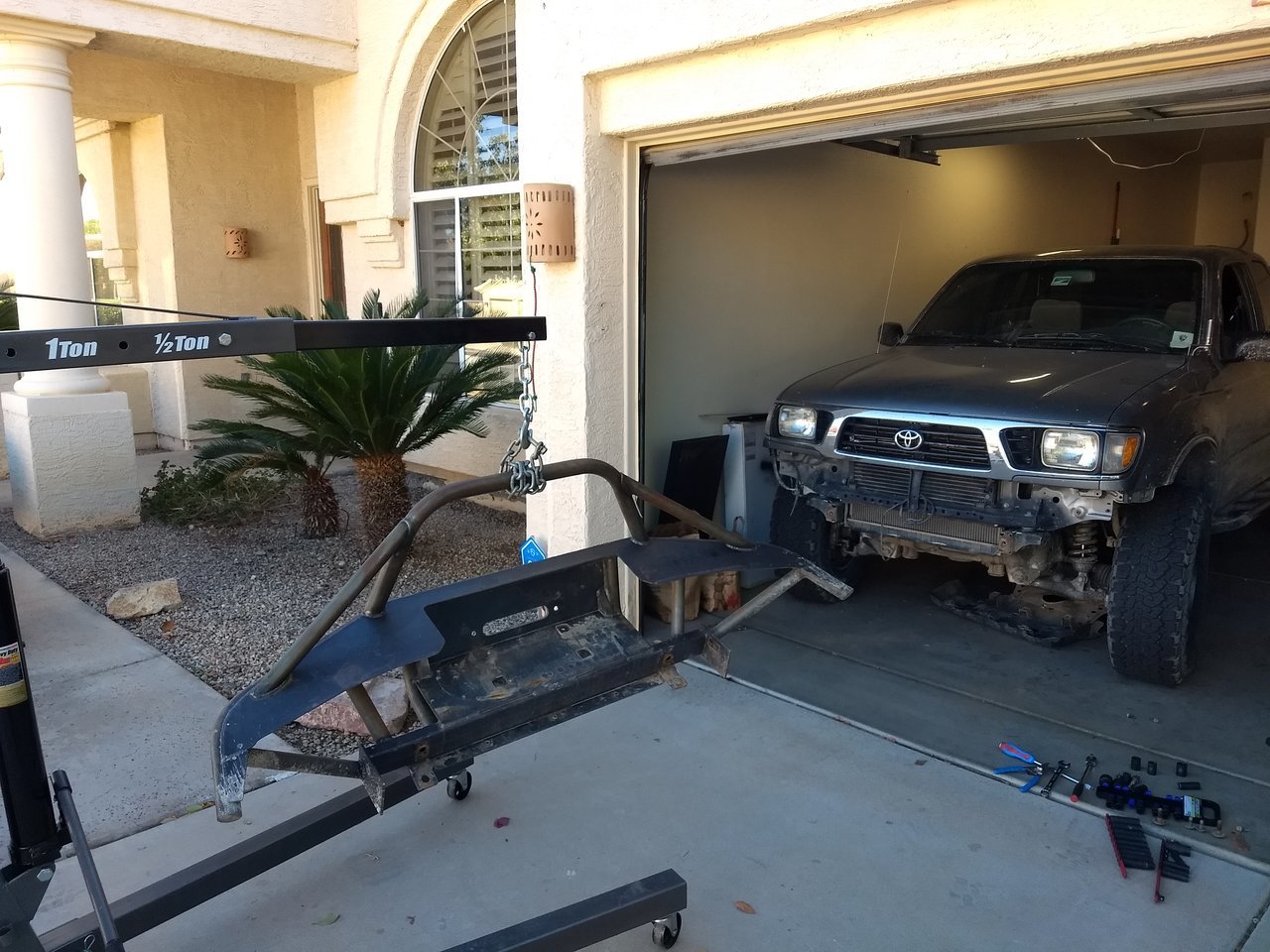

    What, you’re actually going to paint that thing? The rust patina was coming along nicely...

    Surprisingly really wasn't rusting too much, I sprayed the clear coat on really thick. But yeah gonna shoot it with some paint, finally drill the winch plate correctly, install the winch, install compressors. Might do motor mounts, not sure yet on that, might get too tired

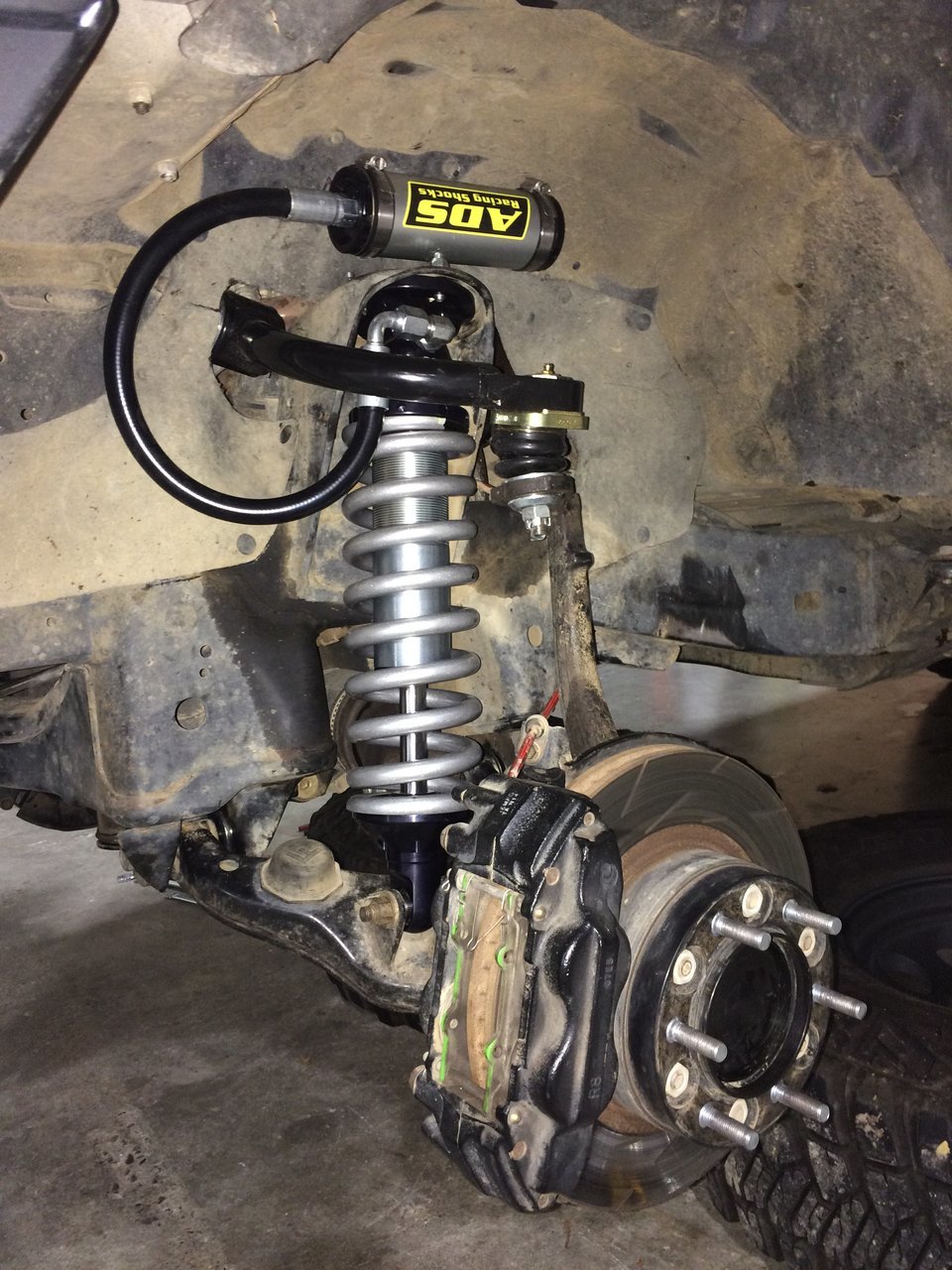

    Well your motivation level is far higher than mine, I'm just trying to work up the effort to adjust my coilovers (really just the passenger one).

    That's a justifiably terrible job, the things always require a huge cheater. Also coilovers thought you were on OME???

    :spy:

    Nice. I've considered going this route 'next time'. Is that RR hose length standard or was it extended to be able to mount like that? Any adjusters to play with compression?

    I had them add a 24" long hose to the reservoirs, I think standard length is 18" or so. My tires would rub on them really bad if they were mounted where most people have them with the standard length hoses. I didn't spring for the adjusters, the standard valving is pretty spot-on but I can always mess with shim stacks later on if I think they need fine tuning.

    MCM's front kit comes with some nice resi mounts. Kinda doubt they would work with 35s but should be fine for your tires I would think.

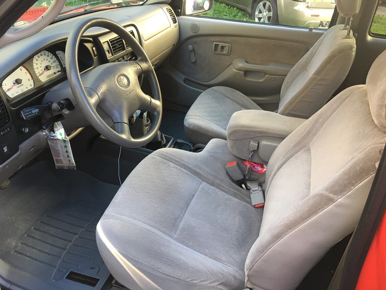

    hello where can I buy cover for these seats, I have searched but I only find for bucket seat not for this model
