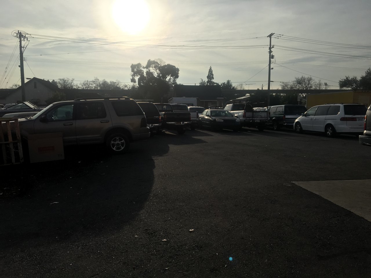

    Visited the transmission shop today to pick up my parking pass and drop off the wheel lock key. They haven't looked at it yet, said they'll call me tomorrow. I still think it's the flexplate.
    I thought it was nice they parked it next to another 1st Gen. Lady told me that truck has a P0475 on it or something.
    m3bassman likes this.
