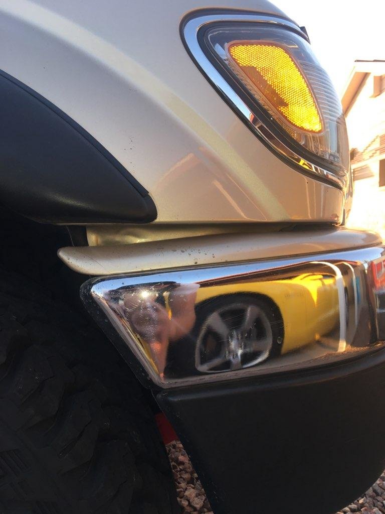

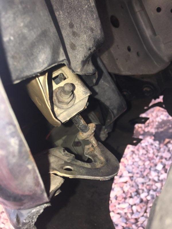

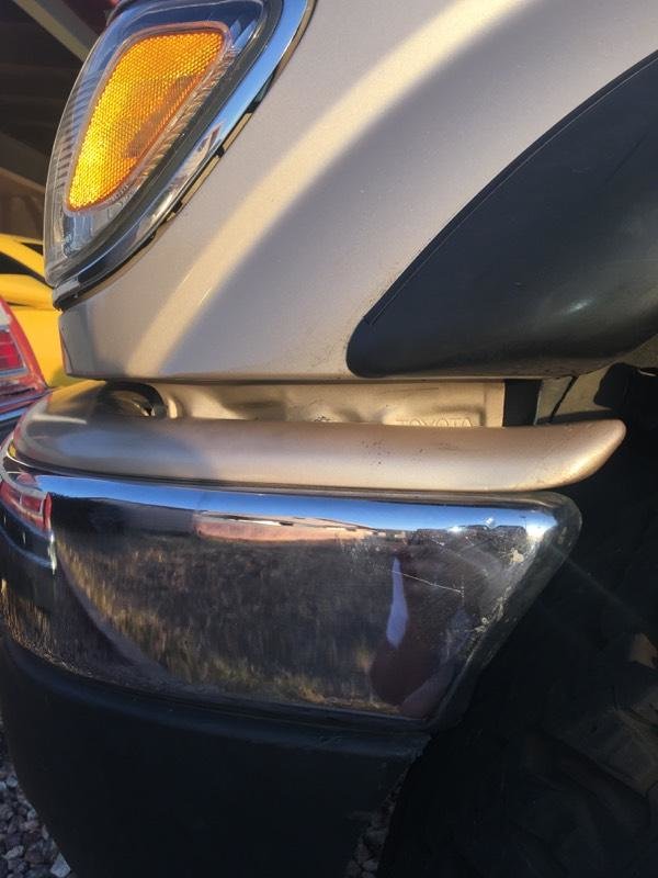

    Tire caught my bumper but I think it was in an accident before I bought the vehicle... there wasn't anything on the car fax either.. My main question is the bumper supposed to have a little space or is it supposed to be completely flushed?6660.jpg 6659.jpg 6661.jpg

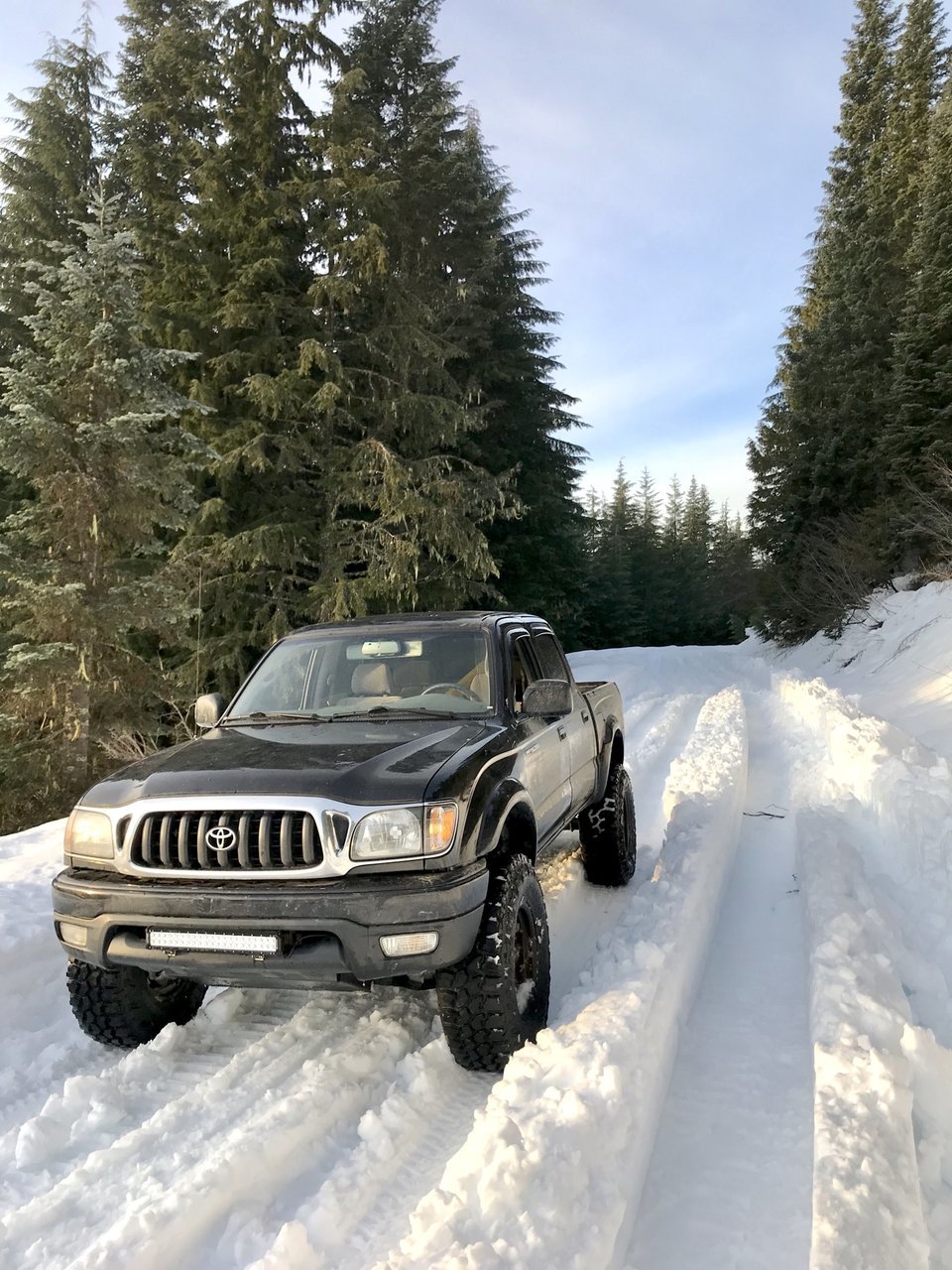

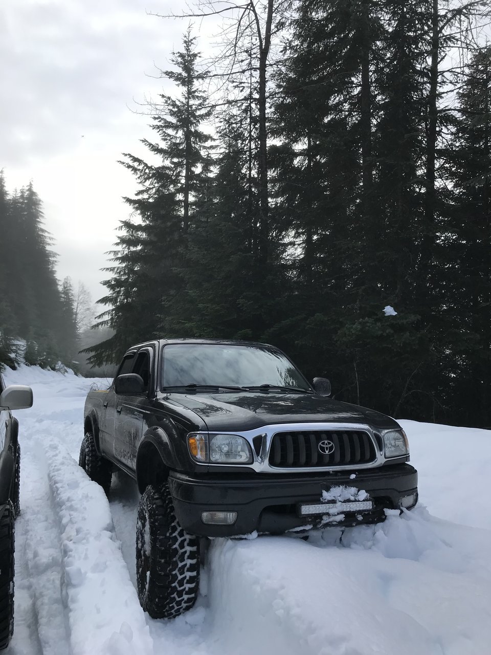

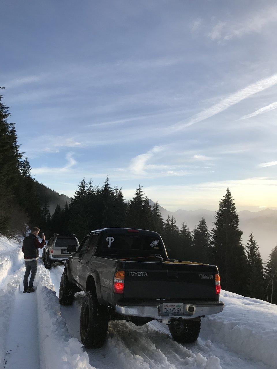

    Last weekend went up to Tonga Ridge Trailhead with my bros. Almost made it to the top.

    You can adjust that by loosening the four 14mm bolts holding the bracket the the frame, readjusting the bumper as needed and then tighten the bolts back up while holding the bumper in place.

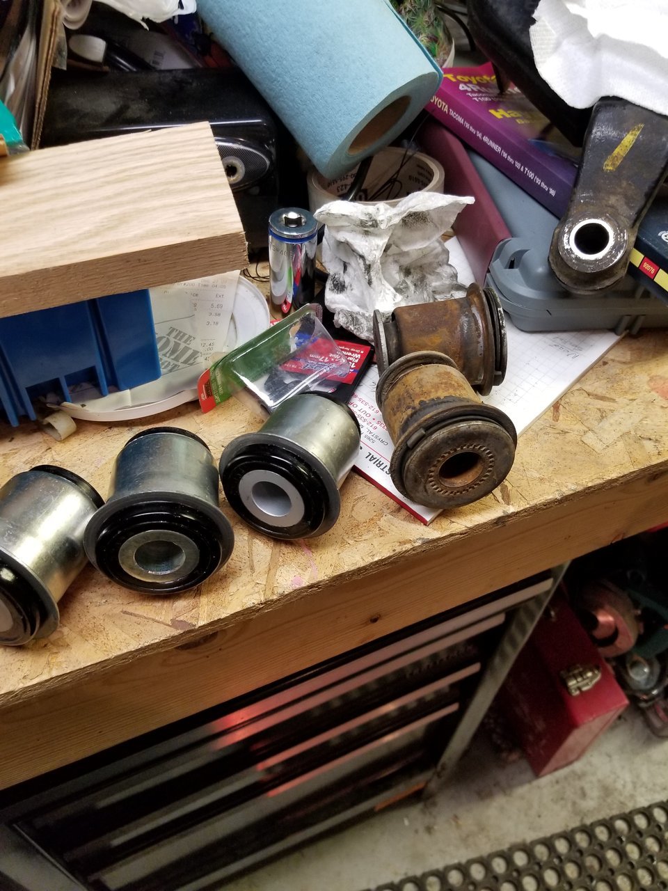

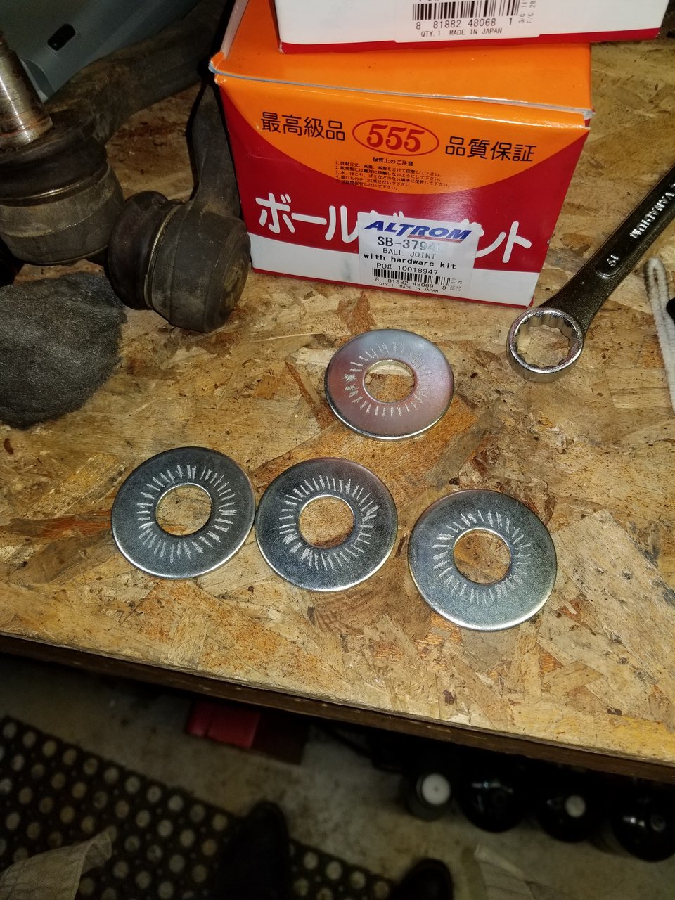

    Just got done replacing my rack, LBJ's, and LCA bushings. Tried using the engraver on the washers for the whiteline bushing washers to give them more grip like the factory ones have. Gotta get an alignment tomorrow because the drive home was scarry as hell

    Supposed to sit flat. Hopefully nothing is tweaked on the frame horns.

    Just double check and make sure the shop torques your hardware properly. I have been running whiteline bushings for a long time with no issues.

    I definitely will. Bout had a come apart when I was taking stuff off. First time working on it since I bought it. Only the driver's side ball joint was torqued down right. Everything else broke free way to easily

    I think it is bent, wondering if I should bend it back... Can I replace this if I can't bend it how it goes?

    Bumper should have a bit of space, but be flat. The post just after yours has a good front-on photo.
