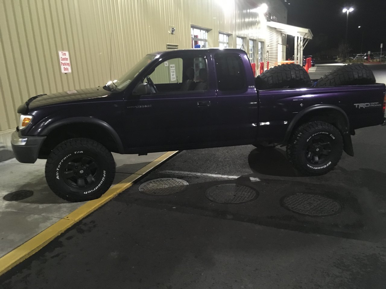

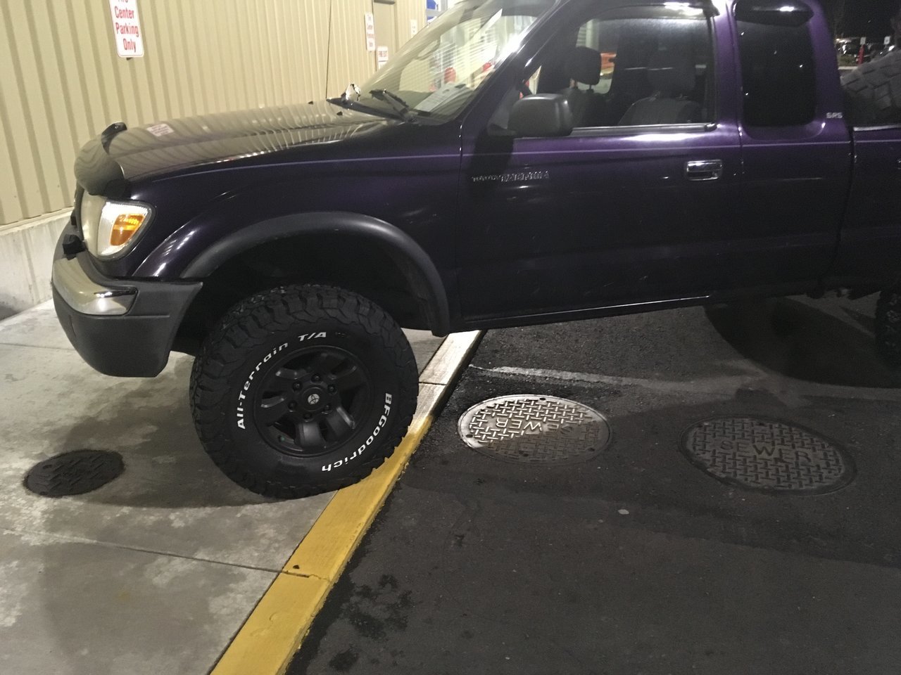

    Haha courtesy of the Costco tire center guys.

    Sweet color truck.
    Procomp tires are very heavy too

    Thanks I dig it. Looks black at night and deep purple during the day. Yeah I wouldn’t rule out 33s again but until I build the truck to where I want it I have no need.

    I was about to say, nice color. I should know.

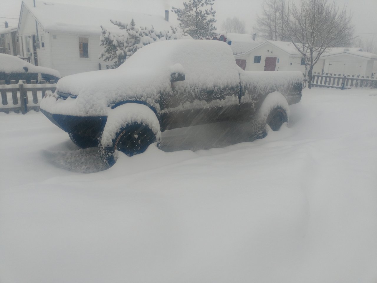

    icon stage 10 kit, toytec 1" bl, 35" general x3s, 17x9.5 procomp wheels, locker anytime mod, s&b intake, blackhawk 2.1 tune,

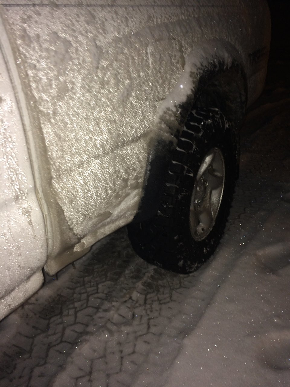

    10F in Concord, NC this morning. Go to leave for work and the e brake is frozen.
    Tried a rubber mallet on the drums, tried driving back and forth a couple feet, got the hot air gun out and hit them for a while. Nothing.
    Must’ve got caked up with ice, mud and snow from driving yesterday. Whole trucks a sheet of frozen sludge.

    The cables/ mechanisms are probably frozen from the slush, mud & snow - Unfortunately you've learned the hard way to NEVER use the E brake in winter conditions.

    Yeah. We get maybe two winter storms a year here. Lesson learned though.

    Try pulling on the e-brake to engage it farther than it currently is - this sometimes breaks it free.

    I just tried that and was able to push the e-brake in until it disengaged afterwards. It has warmed up to 32 and the sun is out so some of the ice is loosening.
    E-brake now has no resistance until the very end when pulled. I’m hoping that’ll change once everything fully melts and that I didn’t booger it up.
