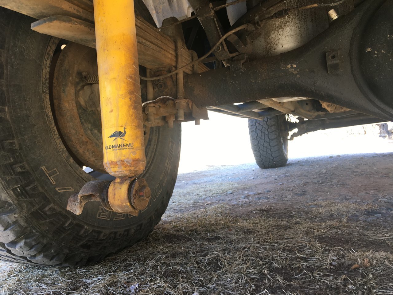

    Had the truck teetering on two wheels coming down some really tight switchbacks. Broke one of my rear seat plates.

    Are those stock bump stops? Guessing you bottomed out the shock and had all the weight on that mount.

    he's had some very bad rust issues in the past. His whole drive shaft disintegrated. So i'd guess it was mostly rust and a few hard hits.

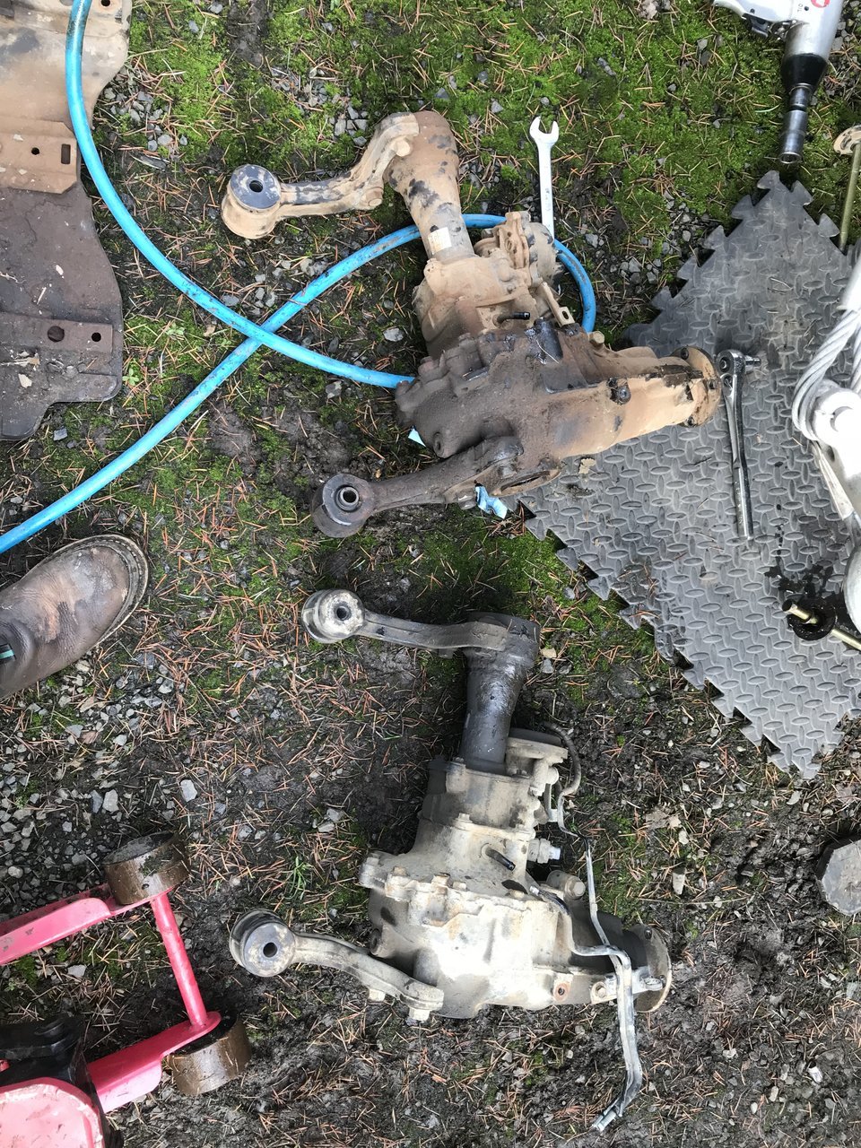

    which ever one works with your truck. The upper one is electronic actuated. The bottom one is vacuum actuated. Pick which ever ADD tube your truck is setup to work with.

    It has the stock 4:10 gears in it and the new rear end I just put in has 4:88. So I’m just doing this to match!

    don't for get to put some FIPG on it when you reinstall to help seal stuff.

    Boom done!
    Guess what my stupid self just did... I freaking swap those parts over and just got done installing the same freaking diff I JUST pulled out!!! :mad: And these things are HEAVY!!!
