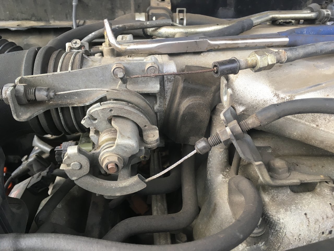

    You have too much slack in all of those throttle cables. They should be firm, no visible slack. That will give you better throttle response, and the transmission won't hesitate before kicking down when you accelerate (which it probably hasn't been doing because that's the one that is disconnected).

    Optical illusion. Did have a minor freak out when I realized I had no power steering adjustor lock nut. See my post below.
    Yeah they seemed pretty loose to me. Only had the truck for about a month and still catching up on maintenance. I'll go back and tighten them tomorrow, thanks.

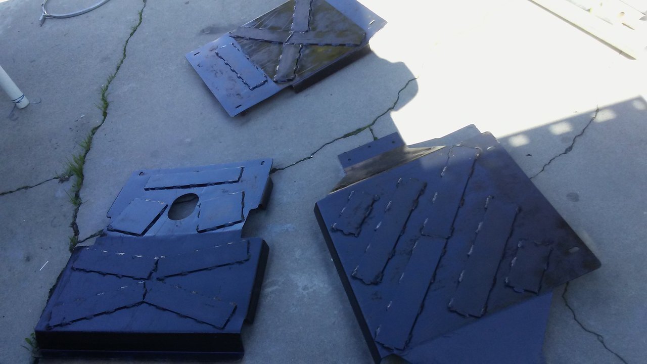

    Put on these heavy fuckerz

    Jesus. Why did you plate them so damn much? Haha

    That doesn't look very enjoyable to drag across rocks....

    Yeah should have done the inside.

    My pops did. I guess he got tired of me asking him to bend them back...lol
    Why do people keep saying that? Its another 3/16 on top. I highly doubt i will get stuck because of that :notsure:
    Or maybe i missed something? Being honest here

    Its to close to shit. Then i wouldnt be able to mount them due to clearance

    You went from a smooth surface to drag across rocks to a surface with multiple ridges. It certainly will not help you any.
    Haha fair enough. That's a lot of extra weight
