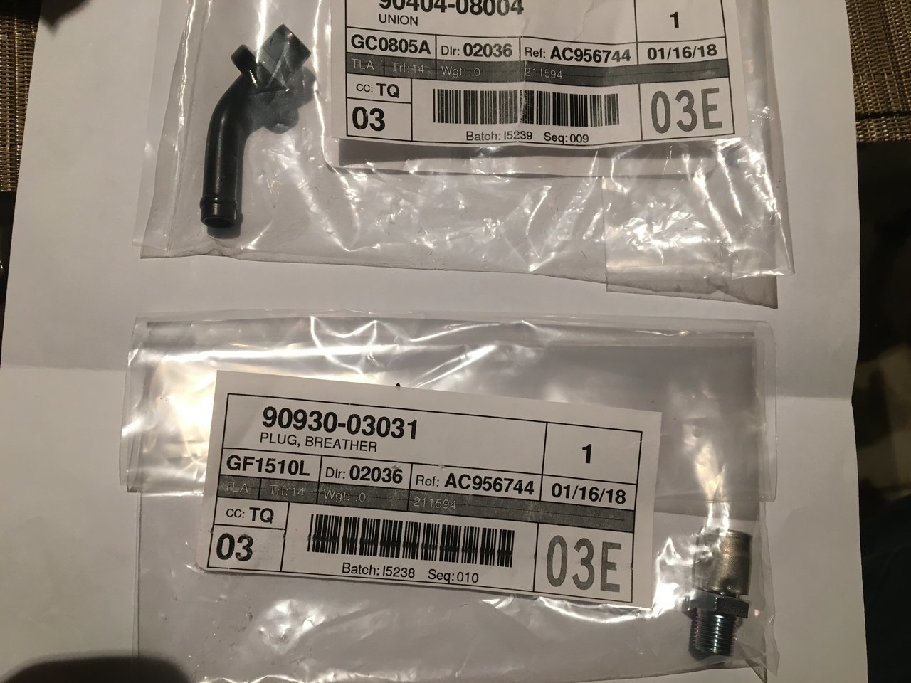

    My front differential never came with a breather and I wanted to extend my rear one up to the gas tank filler cap.
    I totally forgot, which one is which?
    Totally confused on how the top one works. It's just a hallow tube with no cap on it. I believe the top one is for the rear.

    Well the bottom one is threaded so that wouldn't work. Never seen the top one before, mine just looked like both of those combined lol
    you're going to want 90930-03136, which has a nipple for the hose and a closed breather like the bottom one.

    Totally should have done my research before ordering. Darn.

    top tube goes in the clamshell. Then a small piece of tube runs to a hard line on the diff.
    as seen here:
    [​IMG]Front Locker-11.jpg by Monte Nickles Photos, on Flickr
    the blue tube is covering most of it.
    Or you can see it here in the middle.
    [​IMG]Front Locker.jpg by Monte Nickles Photos, on Flickr
    The bottom...not sure. I mean its the actual breather. But i didn't think it threaded in. But there is a tube that is supposed to run up the driver wheel well that the tcase and front diff breather mount to.

    How did I not see that... I completely did not realize that's what that looked like. I was looking for the actual breather cap that terminates that line.
    Guess I'm making another order, lol. Think I can still make use of the bottom one?

    The bottom is just the stock breather that does thread into the rear diff, its not necessary to extend the front breather any right? Its already about as high as the intake if Im not mistaken.

    It's pretty high. So not really. Can help to swap to a nice filter vs a 1 way check valve so it won't puke up fluid all the time.
