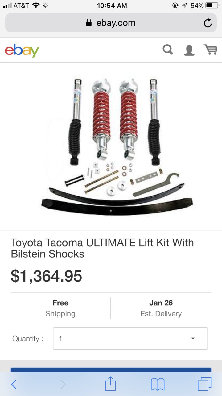

    if your going with a 3" lift its a maybe on the new uca's. and in my opinon i would think the ome lift will be a good choice. as of tires depends on backspacing and tread style

    People seem pretty split on the bilstein 5100 vs OME shocks. However, from what I've read, people like the OME springs/coils much more than the toytec coils. But that is just what I have read. Maybe somebody else can speak more from experience.

    well they don't make a 33/12.5r16...so kiss that dream good bye. A 295 is about as close as you can get and its a lot taller and you will have to cut a lot and hammer a lot to make them fit.
    You should get new UCAs to get a better alignment, but not required at first...but will be for 3'' lift to get a good alignment really.
    annnd....don't get a 3'' lift. Its bad for the CV boots and other joints. 2'' is ideal for the front end of these trucks geometery.
    So id' pass on both of those kits. Unless you have a heavy front bumper, skids, and winch already.

    I have the toytec 5100/5125 set up = its ok for a while. Camburgs make things all set in.
    If you have the funds, buy once cry once ( @NorthwestCruiser )

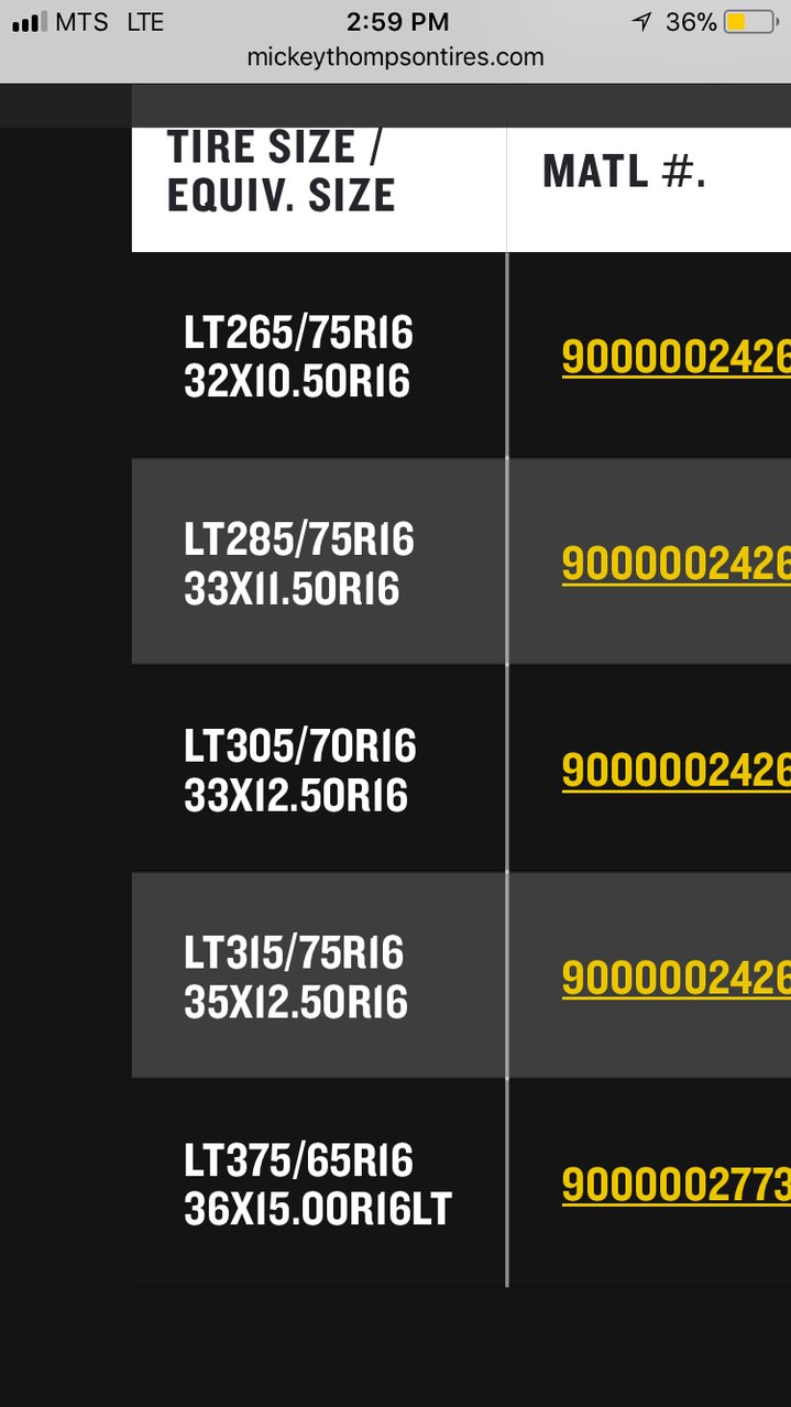

    what is an OTC grappler?
    Are we talking spindle bearing, correct? not the diff bearing.

    yeah, thats a 305.
    which works out to about a tallish 32x12.
    Its a metric tire size though, thats jut what it "converts" too. Notice at the top it has the /equivalent size.
    And due to the very dumb way tire sizes work out...its not a real 33x12.5. It won't be the same size as a 33x12.5r15.
    That said, its still a very wide tire so your going to have to cut a hammer a lot.

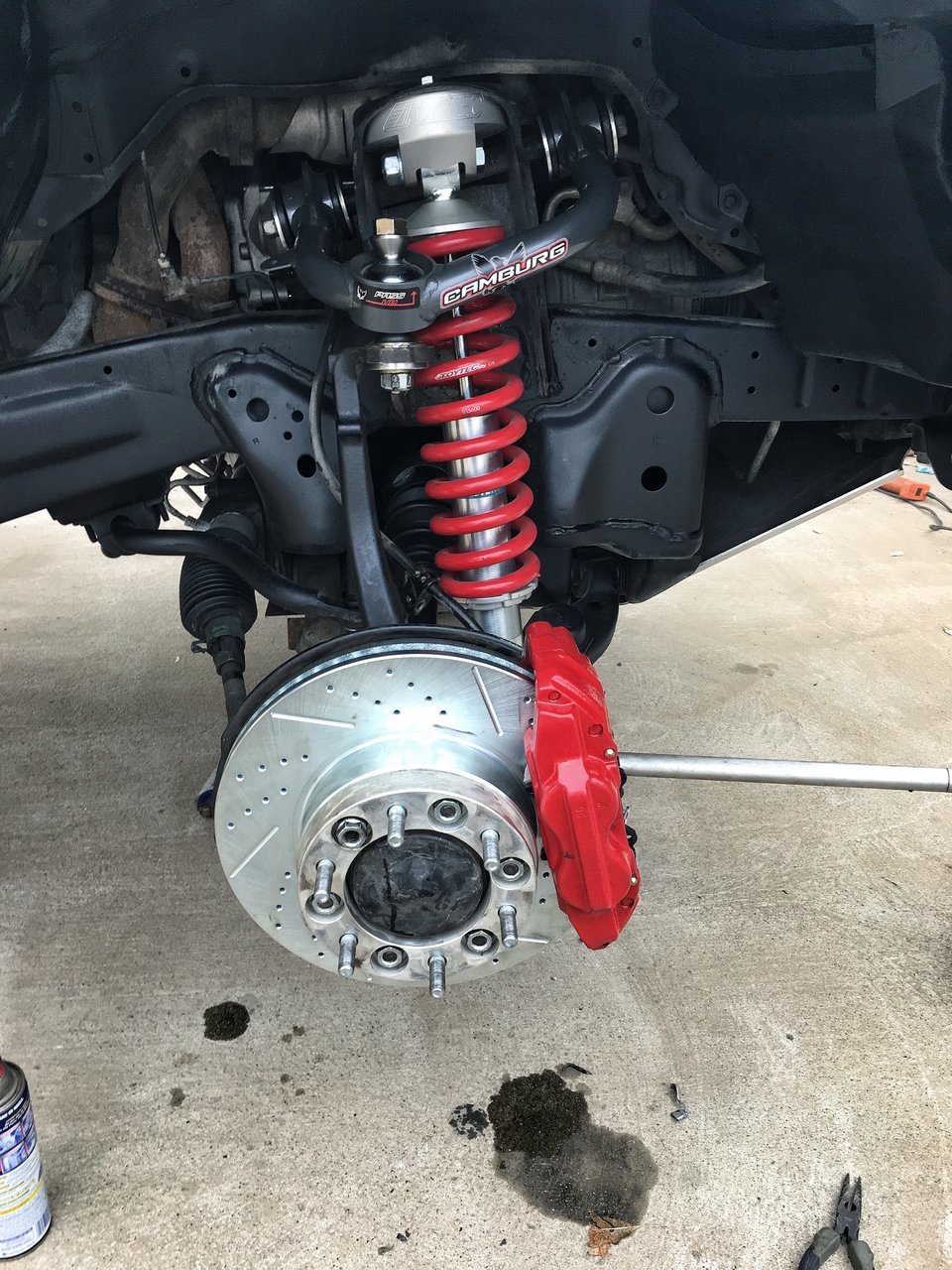

    I went with these! I know it’s kinda pricey also went with camburg UCA’s 88CDAD97-3310-4782-B004-C912876E8E6B.jpgEB788FD2-4A93-4C64-BD95-003B50EAB7EE.jpg
