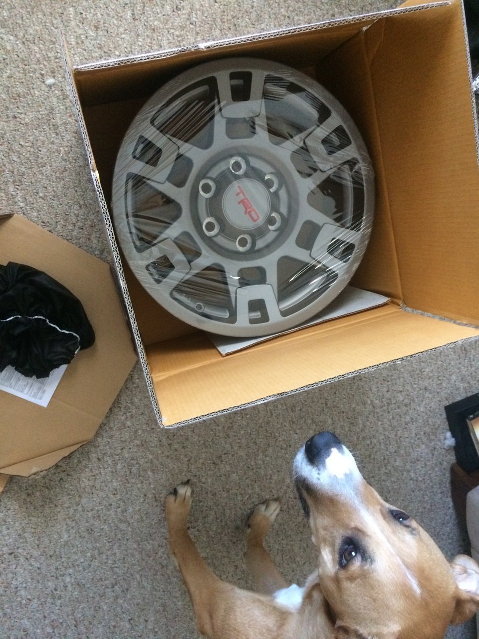

    So while we’re on the subject of backspacing and fitting tires I have a question.
    My wheels that I bought last year have 4.15” backspacing meaning the back of the wheel sits closer to the fender than I want, I think. To run a wider tire than I have now I would need a 1.25” wheel spacer to change the backspacing to 2.9”?
    Or do I have that all wrong. I know there are other points where tires will rub depending on the overall dimensions but a spacer would help for this particular wheel?

    What size tires?
    A lower BS wheel or adding spacers is going to alleviate frame rub, but will increase how much you rub in the inner fender/pinch weld area. It’s a compromise, but you can cut/smash/bend the pinch weld area to fit. You can’t do that to the frame.
    FWIW, I am rubbing frame a little with 255/85/16 with 4.0” BS.

    I’m not really sure yet. These wheels are boxed up in a closet. They were an impulse buy with plenty of tread left on my 265/70/R16’s Duratracs on stock wheels.
    I’ve been stalking other 17” wheel first gen build threads to see what they’re running but with this information here I guess I need to see what backspace those guys have as well.

    It’s a 7” wheel so the tires won’t be very wide anyway.

    Wow. THat is super narrow for a wheel, even more narrow than OEM. what tire are you going to run? You sure it can fit on a 7''?

    I’m thinking about a 255/75R17 Falken Wildpeak. That’s a little taller than my current tire and pretty much same width. Recommended tire size according to the literature with it is 265/70R17. It’s the Sema TRD wheel:

    ahh those are made fore 2nd gen/3rd gen tacos. They have over 5'' BS so will be sucked in more to the truck. Also should be a bit more than 7'' wide, closer to 7.5.
    You might rub a bit do to it being inboard so much on the frame or UCA. But would be an easy fix if it did.

    I don’t know, the paperwork says 17X7 with 4mm offset so it should be 4.16 backspace. If they measure 7.5 that should take it up to 4.41 backspace...if these online calculators are accurate.
