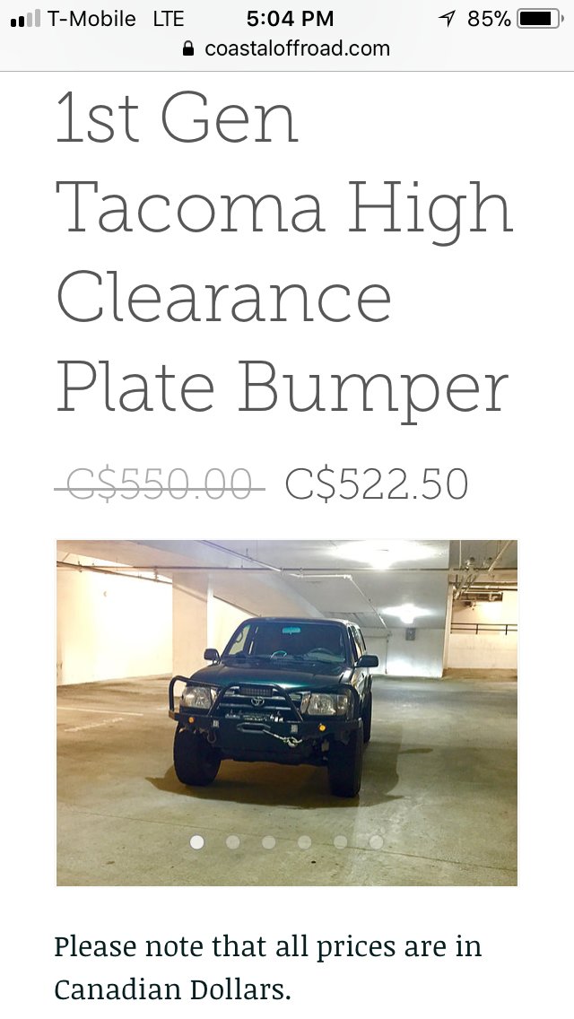

    I really like the look of Coastal Off-road bumpers although I would probably just do the grill tubing. DIY weld kits, prices in Canadian: coastaloffroad.com. Still looking for any member reviews.

    I had debated on of them, but wish they had more views of it. That and the out of country transactions I shy away from.

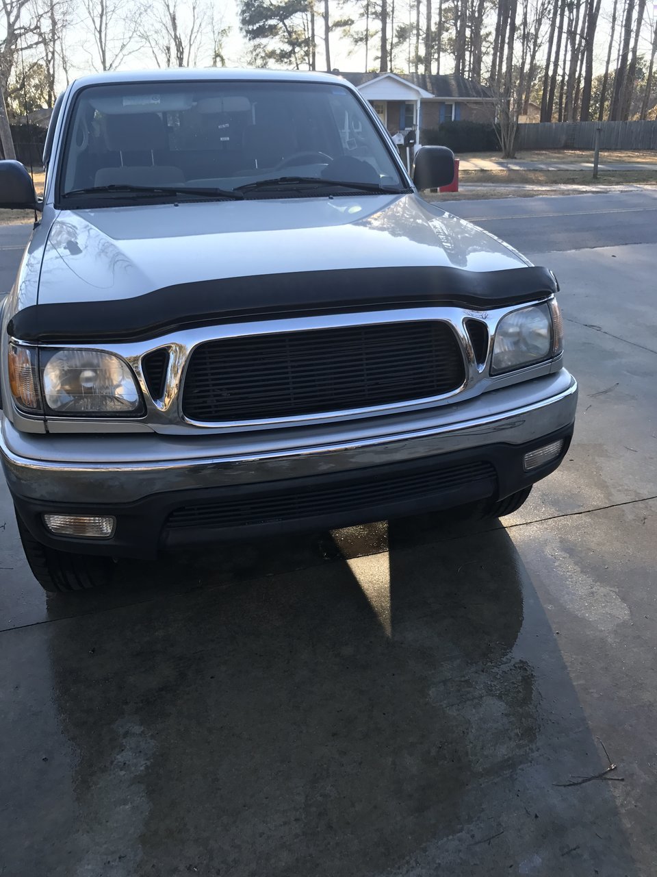

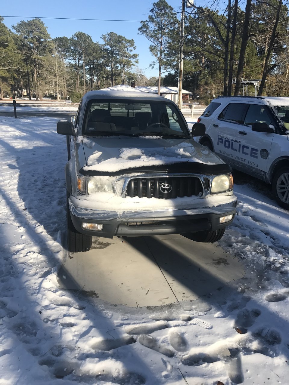

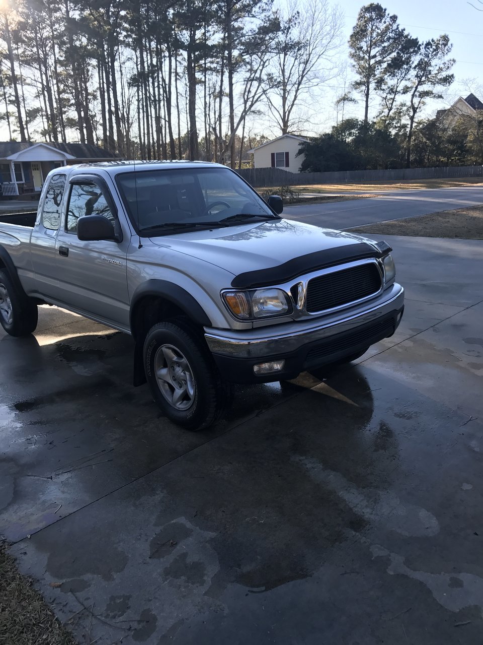

    So I did my first mod on my tacoma today. Put in the billet grill insert. One day might go with a custom grill but for $65 off Amazon I couldn't beat it.

    Yeah they have more views on other trucks but not on the 1st gen. They’re a 20 min drive from me so by far the most local bumper resource I have.
