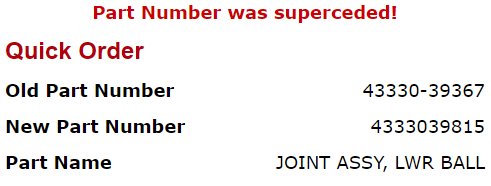

    PN# 4333039815
    PN# 4334039436
    Should come with bolts.

    Since I'm going to write this down for the future - those are the PN's for 01-04, not 95-00, right? my parts list for 95-00 lists:
    R: 43330-39367
    L: 43340-39827
    Does that mean 95-00 don't come with bolts?

    correct.

    Just noticed this. Might all be the same now...
