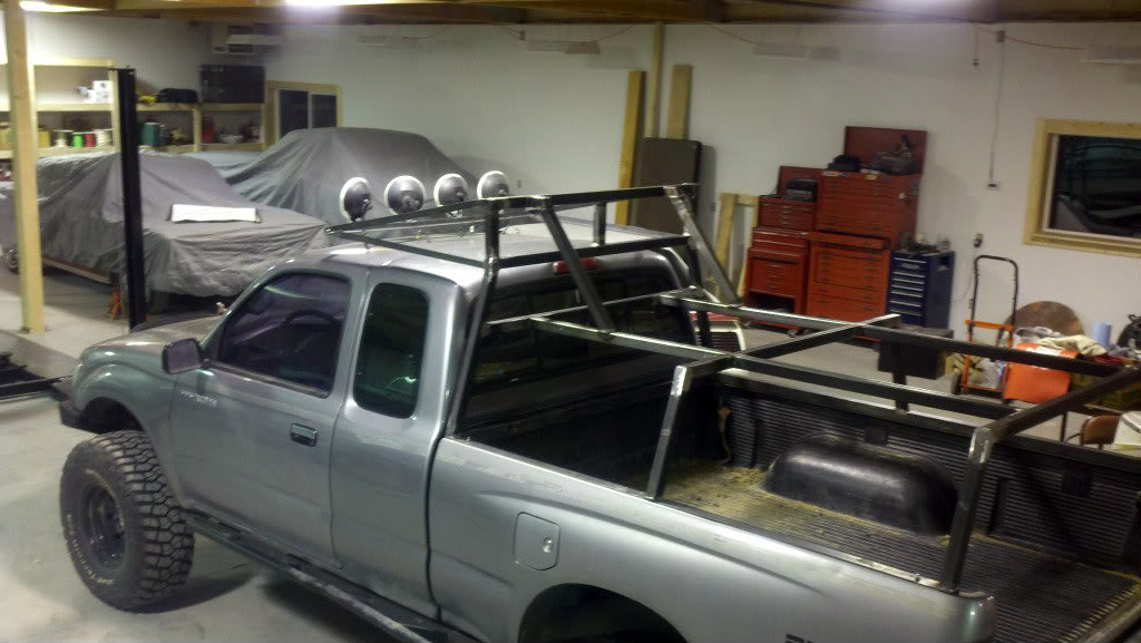

    i have a rack similar to your and you have to put cross support for the legs inbetween the bed rails. when ya tie stuff down the sides of the bed move and fatigue the welds up top. you won regret doing this i promise. cause youll be angry when twice a year ya have to go back and re weld them

    yes i will have a rear bar that holds it together in the back, and up front ill have a secondary mini rack that'll do that for me.

    Lookin good!

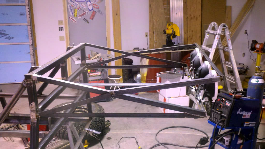

    thanks man
    did more today :cool

    Nice! I like how the protection over the lights is slightly forward of the base.

    Yep! that way its in front of the lights to keep tree branches off em :cool:

    Damn that light rack is sick!! I'm getting a 18 or 22'' magnaflow next week :D Thanks for helping me decide :cool:

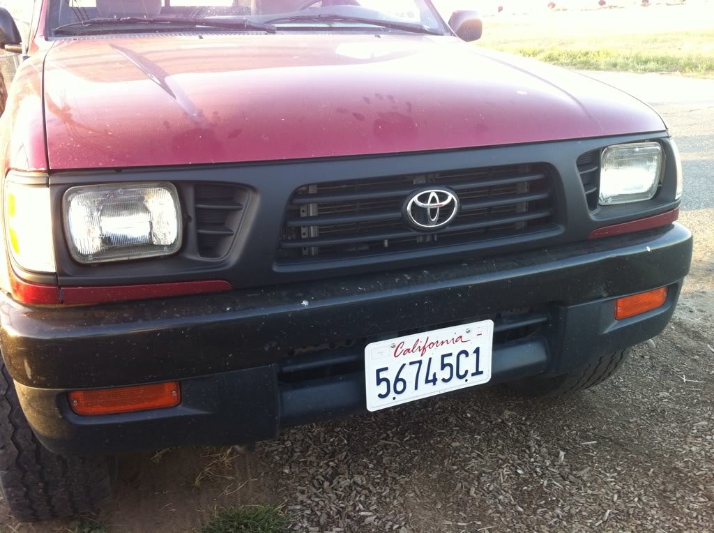

    Painted my grille and light surroundings black
