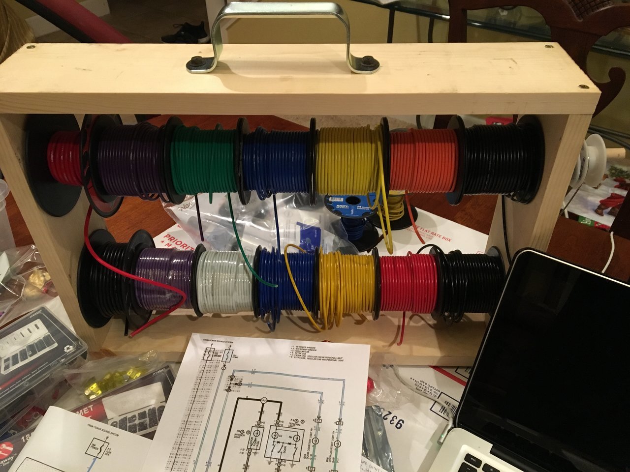

    Cutting the wires to length is honestly the most monotonous part of the whole thing. Made this cool wire rack out of the budget lumber at Home Depot when I found out professional wire racks are like $100.

    fast way for cutting wire lengths is buying some 1'' PVC or 1/2'' and cut it to the length the wire needs to be. Then thread the wires you need through and cut them all.

    use a cutter like that and you could do a lot of cables at once.
    cut notches in the end of the pipe to hold the ends of the wires.

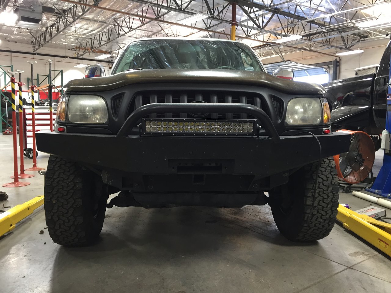

    Mounted my light bar up front. Just need to wire it up.

    Genius. I'll definitely be doing this.
