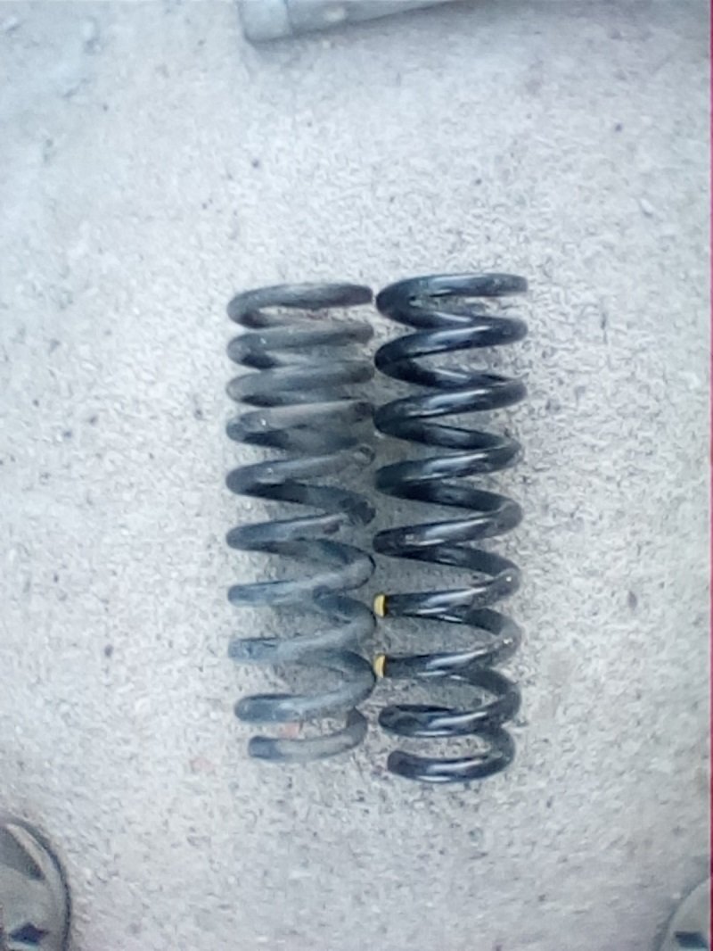

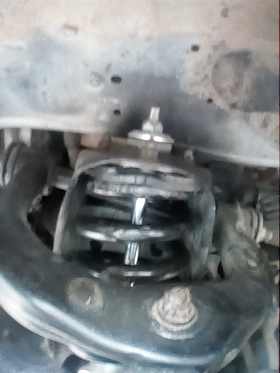

    Not today, but the other day swapped out 1st gen coils for 2nd gen coils off 2015 sport,
    not very good pics ...
    The 2nd gens are roughly an inch longer (on right)....

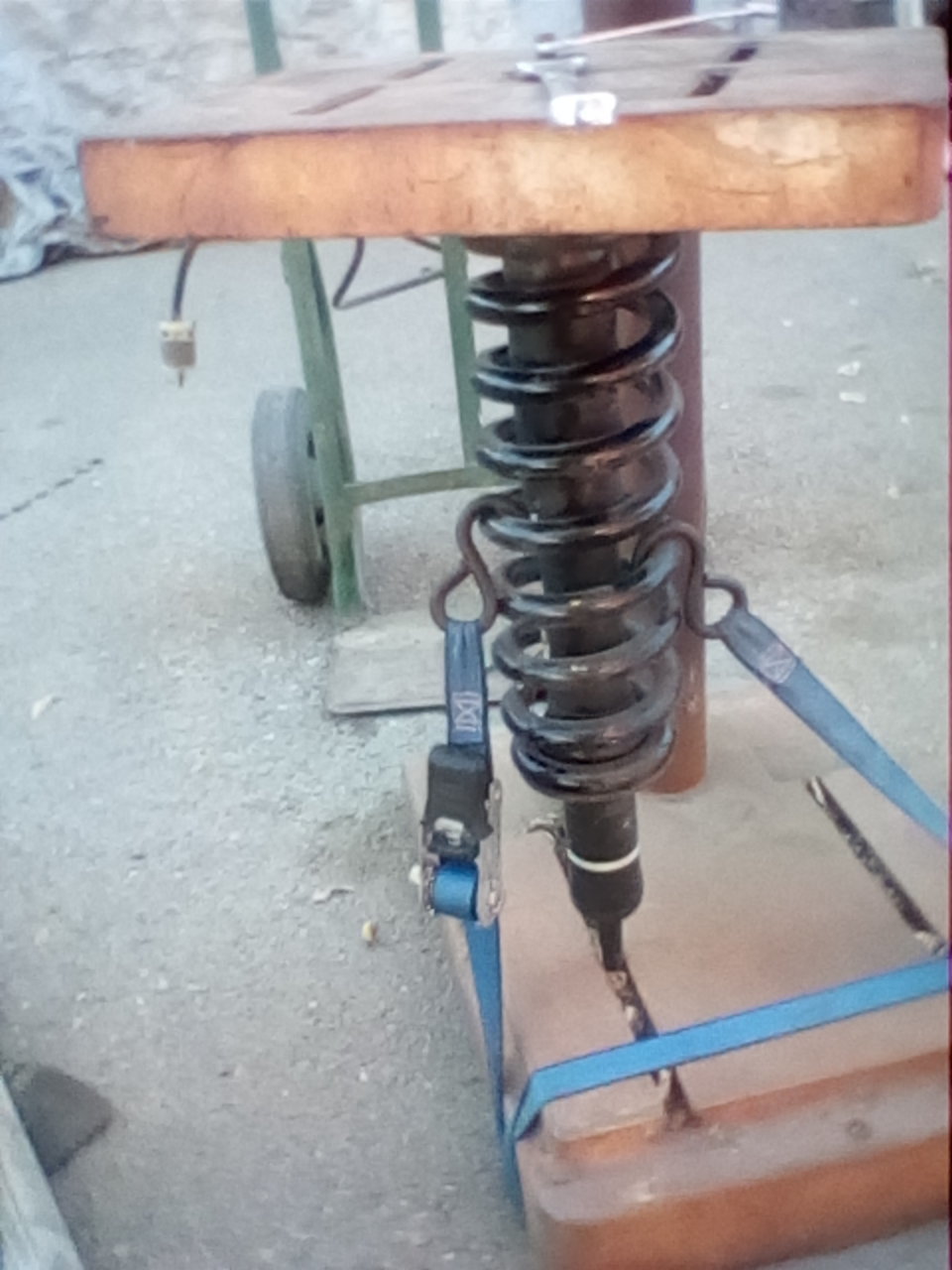

    How I DE compressed 2nd gen shock/strut, & I don't want to hear a lot of bullshit over it, it was safe, probably shouldn't even post it haha.

    is that a drill press im looking at? probably actually pretty safe honestly...

    Pretty sure that 2nd gen coils is a terrible idea. I think you'll end up breaking a coil as the block height on them will be too tall.

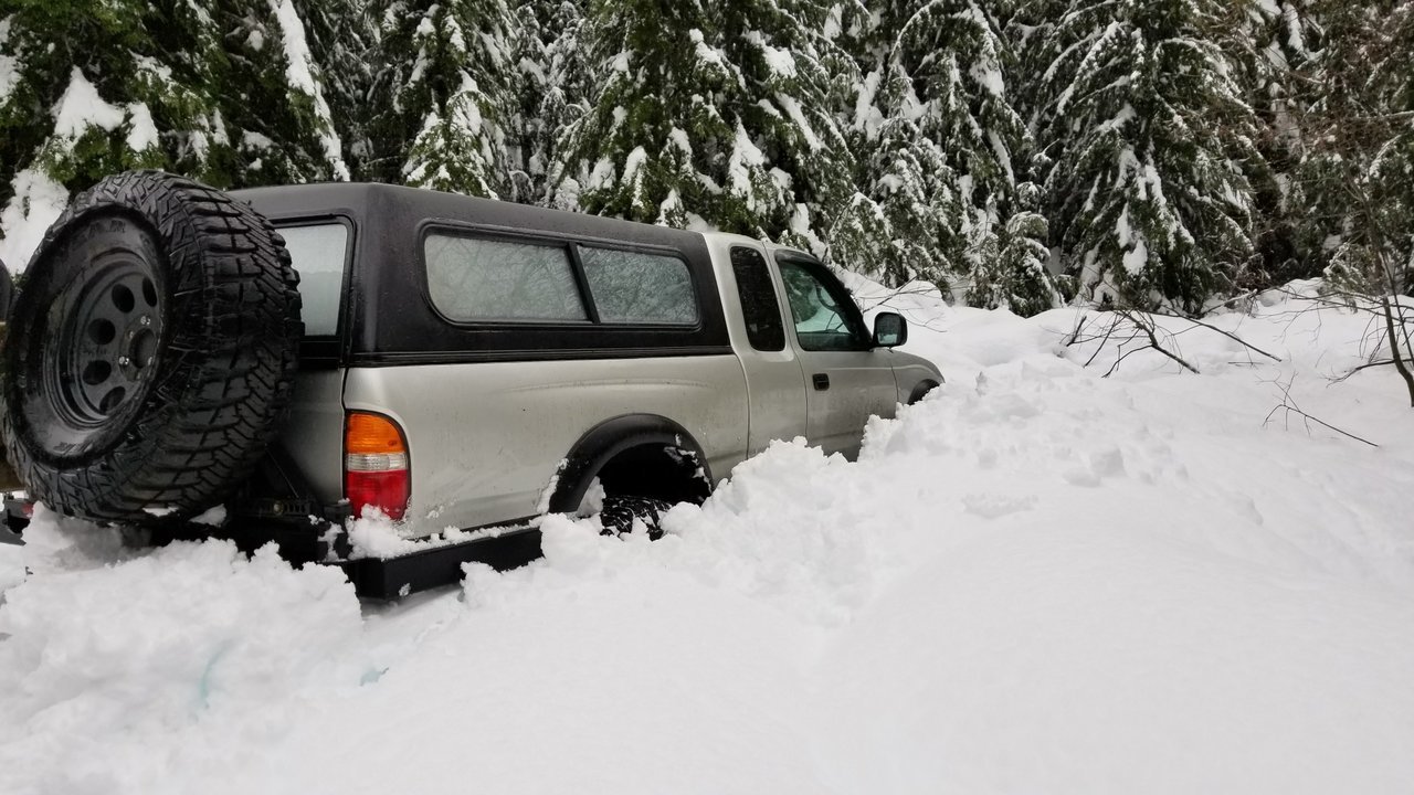

    Was having a nice day out in a little bit of the white stuff, nothing too crazy

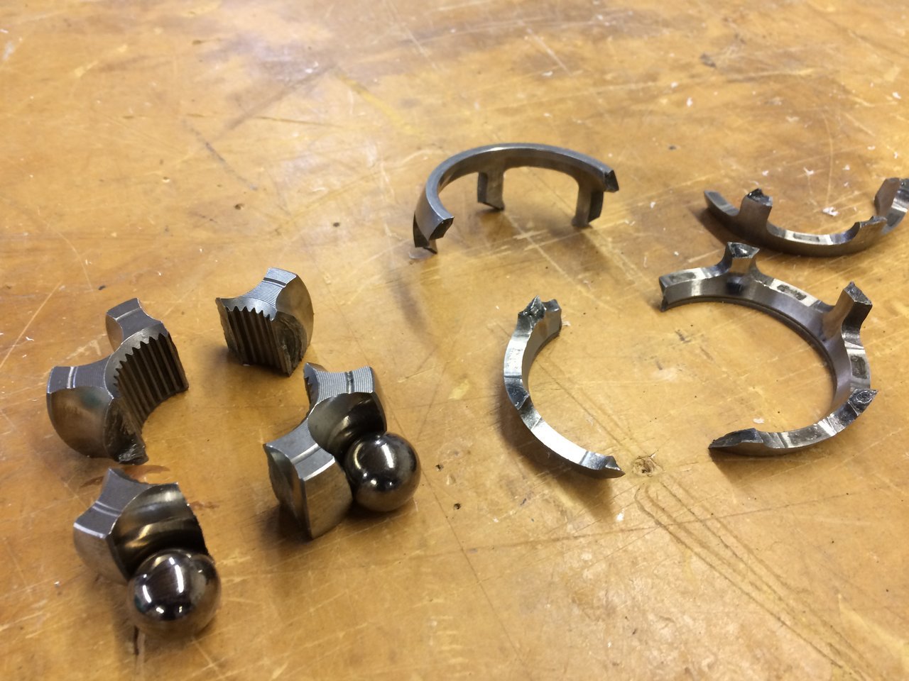

    Then one of my outer CV bearing cages decided to do this
    Thinking about upgrading to RCV axles, anybody run those and/or have an opinion?

    only seen one truck run those with a custom built center mounted diff.
    They are super strong. Your front diff will blow up probably before they do.
    could swap to tundra outers i think with some tinkering. The outer cage on those is way stronger.
