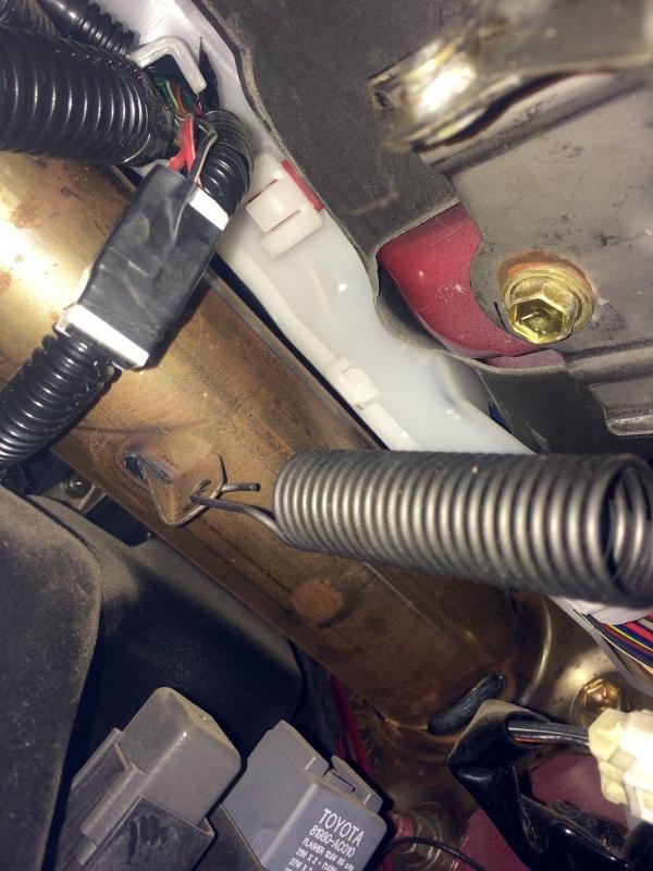

    FYI, this is what you're trying to achieve

    Ah ok super easy and yes I have the 3.4
