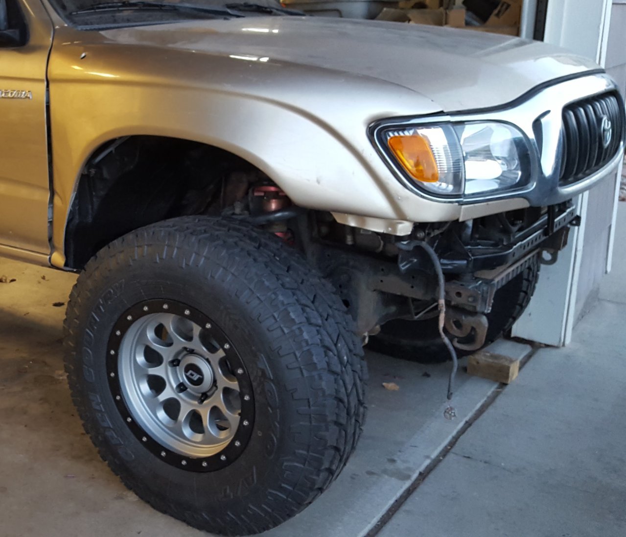

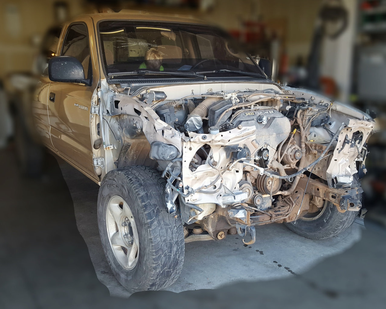

    380 each! OOF no thanks!!!
    The Dcab rear ended a chevy so all parts from the Firewall FWD was shit.
    Pic when I got it home and after I cut out the rest of the radiator, AC, Fan.
    Edit: This is how it looks nowish.

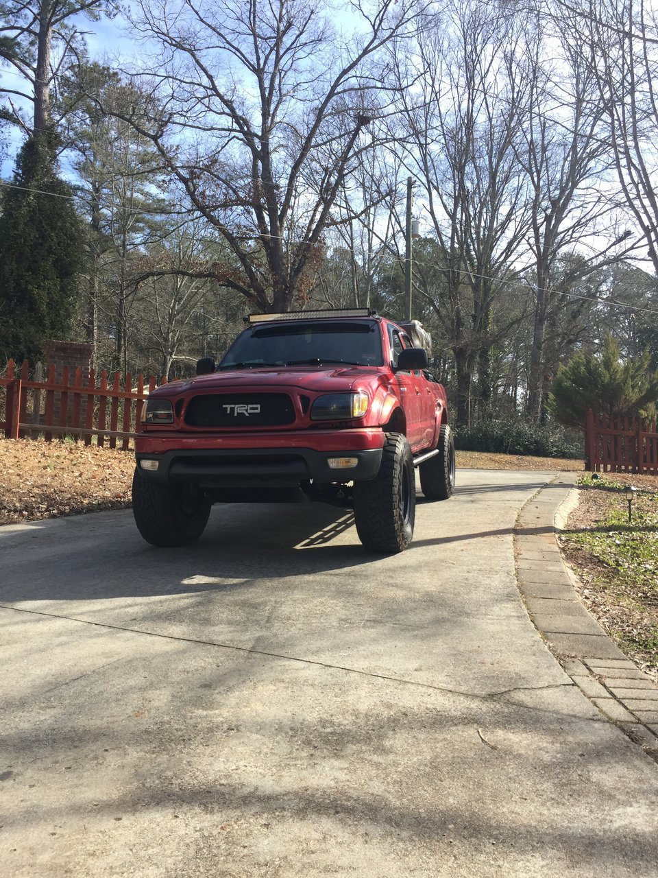

    Finally added the nessecities to the truck, skids and sliders!
    @BYJOSHCOOK thank you for letting me use your skid as template!

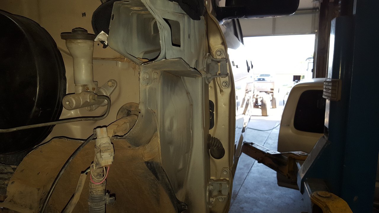

    Where the apron and cab meet they overlap each other. There are some bolts to hold it together while it's spot welded and seam sealed during assembly. No intentional splits in the apron from Toyota. I used a Clarkson tool kit and a floor jack to lift the debbie downer corner under the battery tray on my '00.
    Best Pic I have of the seam area.
    There is still fender that I just rough cut long to get out of the way on the Dcab. When I put the apron back on I just butt welded and over laped with some 18ish GA I had laying around from the cab tub jobs.
