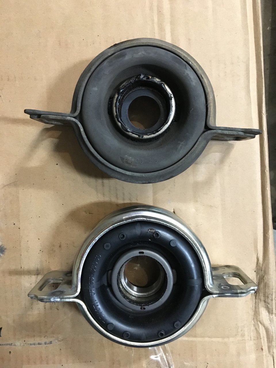

    #76340
    10,097
    Brett
    Steamboat Springs, Colorado
    '01 4WD, SR5, TRD & '13 TRDOR AC

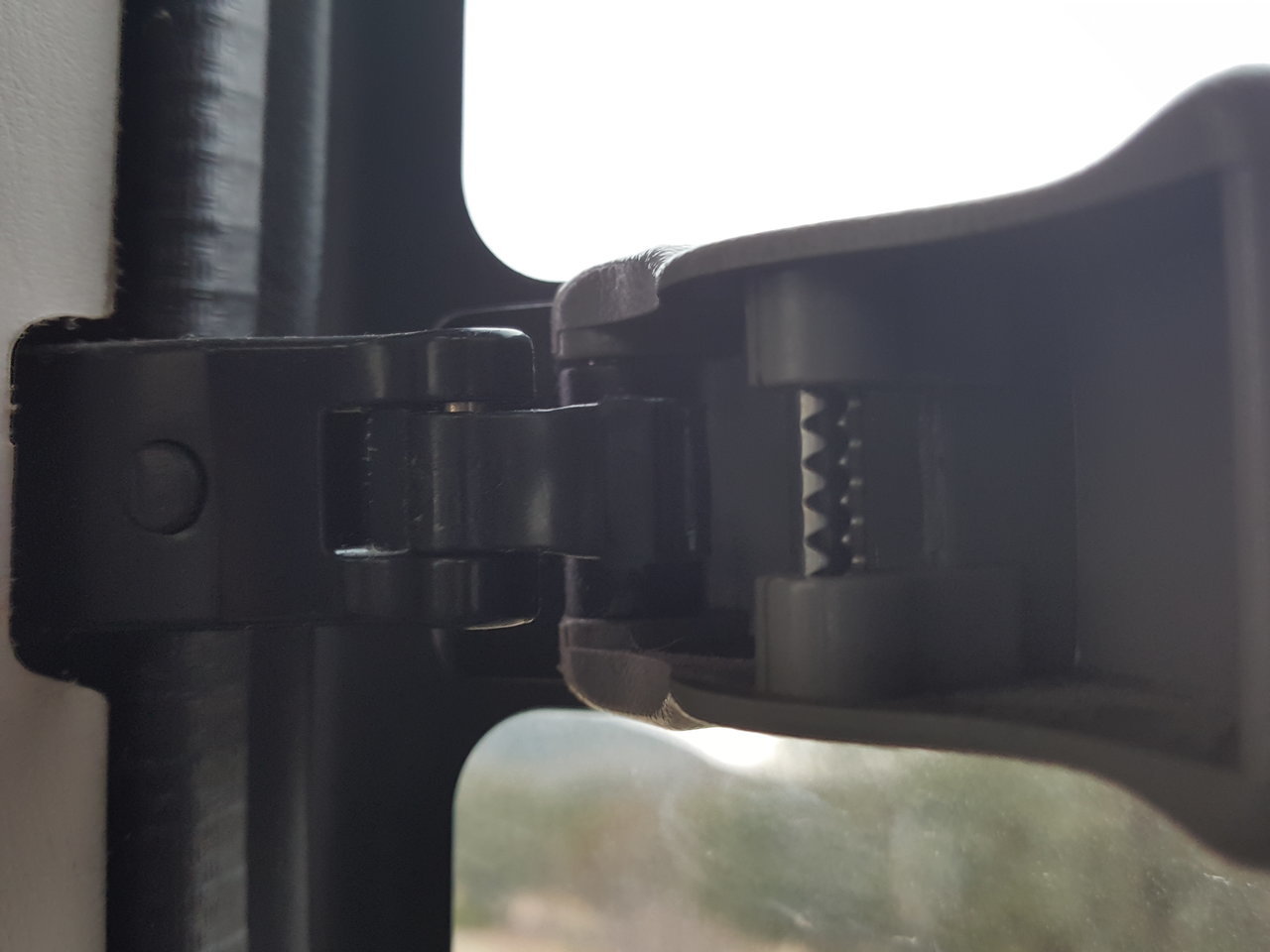

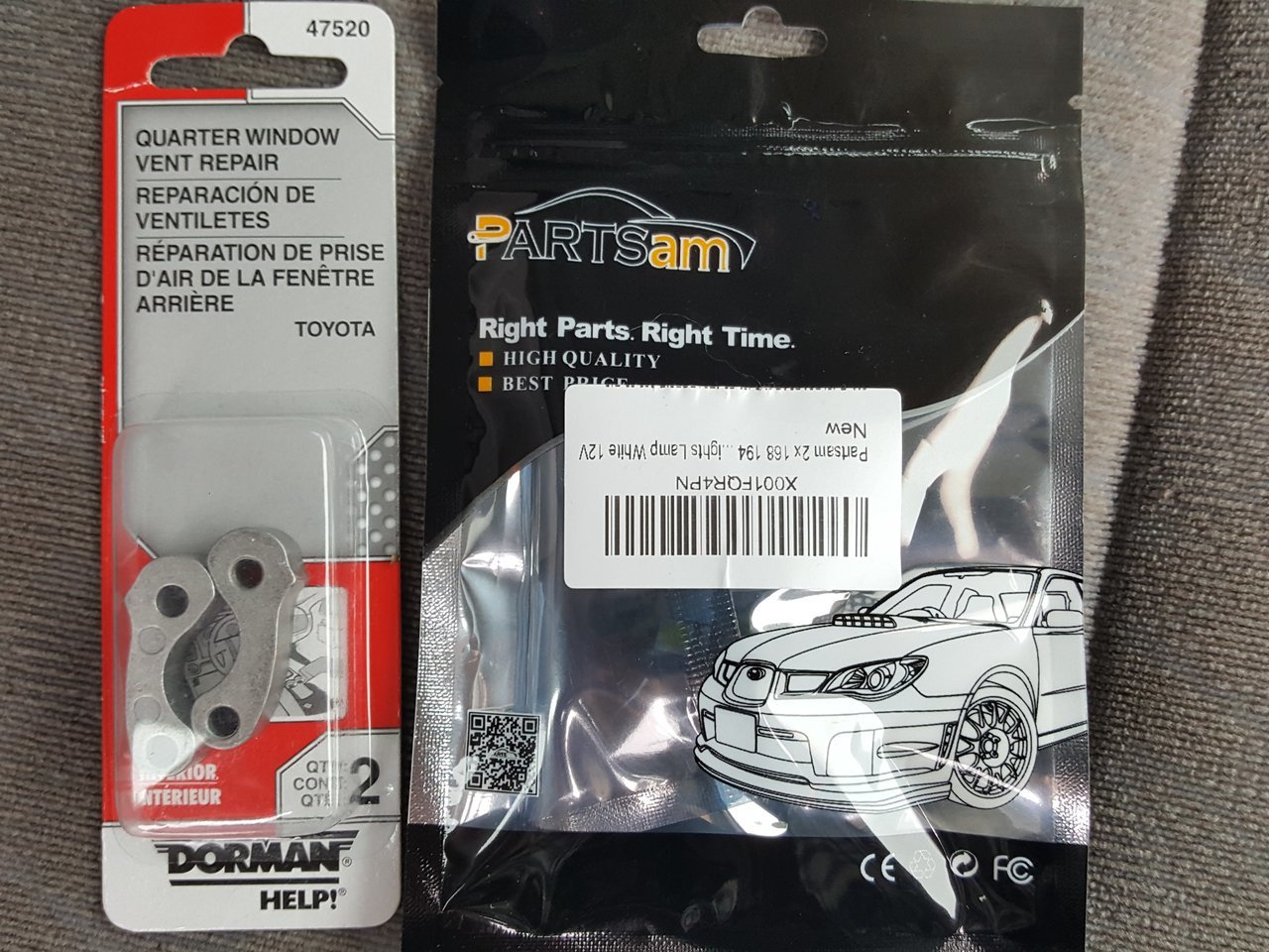

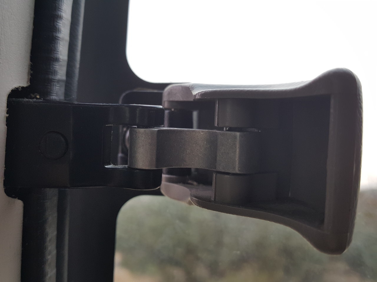

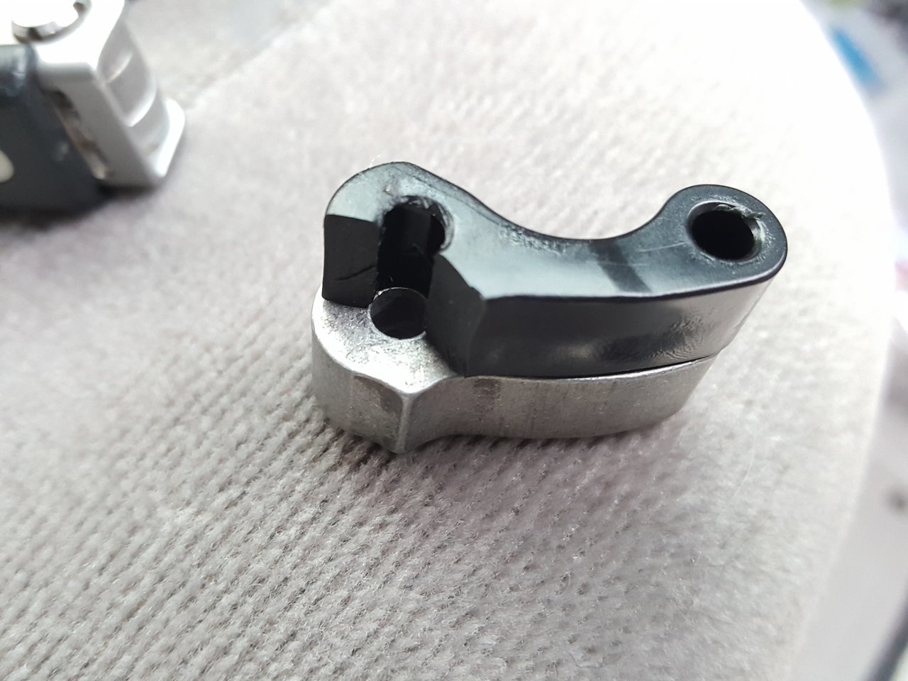

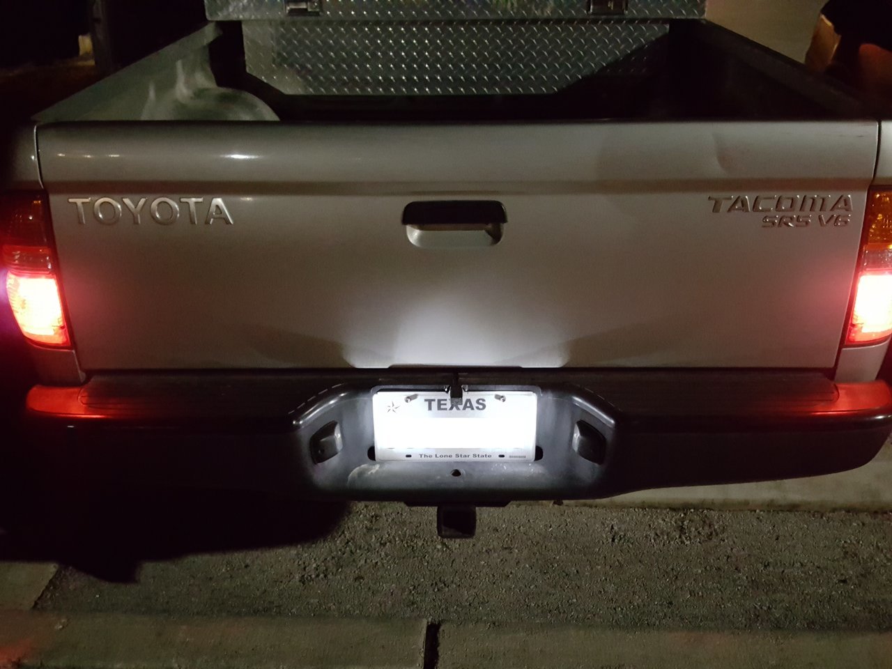

    I did the quarter window vent repair and replaced my License plate lights with LEDs.
    Before:
    After:
    New lights!

    FYI You don't have to take the lens off of the license plate lights. The bulbs are accessble from the rear of the bumper, just reach around and quarter turn the fitting.

    Haha your right,
    Oh well, at least I avoided the dirty parking lot.
