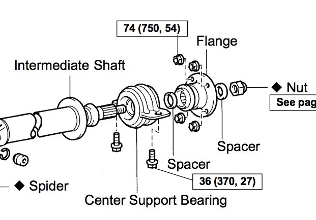

    Yeah it was inside the old bearing caked in grease which is why I didn't see it. I only found one though.

    I think you're supposed to, my new carrier bearing didn't come with it. Did you read through the 'how to' thread sticked at the top of the 1st gen forum on how to do the swap?

    Just checked the FSM. According to the propeller shaft diagram there's only two washers. The thick one and one thin one. The thin one goes before the flange and the thick one goes after the flange.

    Okay this is starting to be a clusterfuck. I thought there were only two washers and as I was ready to put the flange back on, the SECOND thin washer falls off from the flange. Now there's two thin washers and one thick washer.

    Your guess is as good as mine. The FSM diagram says there's two 'spacers' but I have three.

    Think I have it figured out. My guess would be the thin washers go one each side of the carrier bearing, but you can't put one behind the bearing because it won't slide onto the shaft. You actually have to stack two thin washers on top of the bearing, followed by the flange, followed by the thick washer and stake nut.
    Weird but it makes sense looking at how it came off and how the FSM only talks about one spacer behind the flange. Don't know why Toyota didn't just use a single washer.

    You torque it to 134 ft/lb to seat it properly on the shaft, and loosen the nut again and tighten it to 54 ft/lb. The 134 ft/lb is just to make sure it seats properly.
