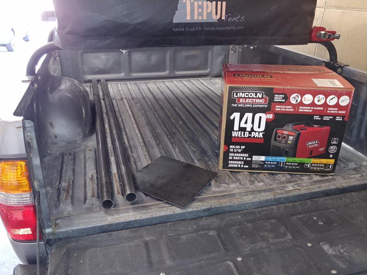

    im using the stock upper mounts but have welded on lower shock mounts about mid axle. and im using 12" billies. yes its probably over kill but i didnt know what i really needed so i went over what i thought i needed.

    Didn't think to order them, if the bed comes off as easy as everyone makes it seem I'll take it off to do them next time.

    That's not overkill, that's just not measured, I can't even imagine how that doesn't bottom out all the time.

    I bought some extra plate to reinforce the area where I put the new upper mount but I suppose I could go and get another sheet of metal, really not sure I'll need that much support though, frame plates seem like they'd be enough.
