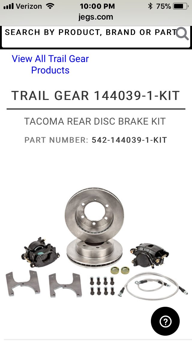

    My drums are going out too! Going this route it’s next on my list.9C5BA9AA-B303-4364-A3D1-2001D8128FC8.jpg

    im going to look into getting newer 4runner rear discs on my truck.. I just want to keep the e brake.

    What year 4Runner disk brakes work with 1st gens? I heard sequoia brakes will work to.
