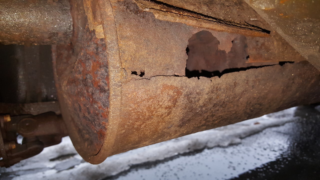

    So it's time to get a new muffler. New England snowy road pretreating fucks any steel not coated in Fluid Film. Been looking at the Aero Turbine 2525. Sounds great on YouTube but haven't heard in person. Anyone running one regret it?
